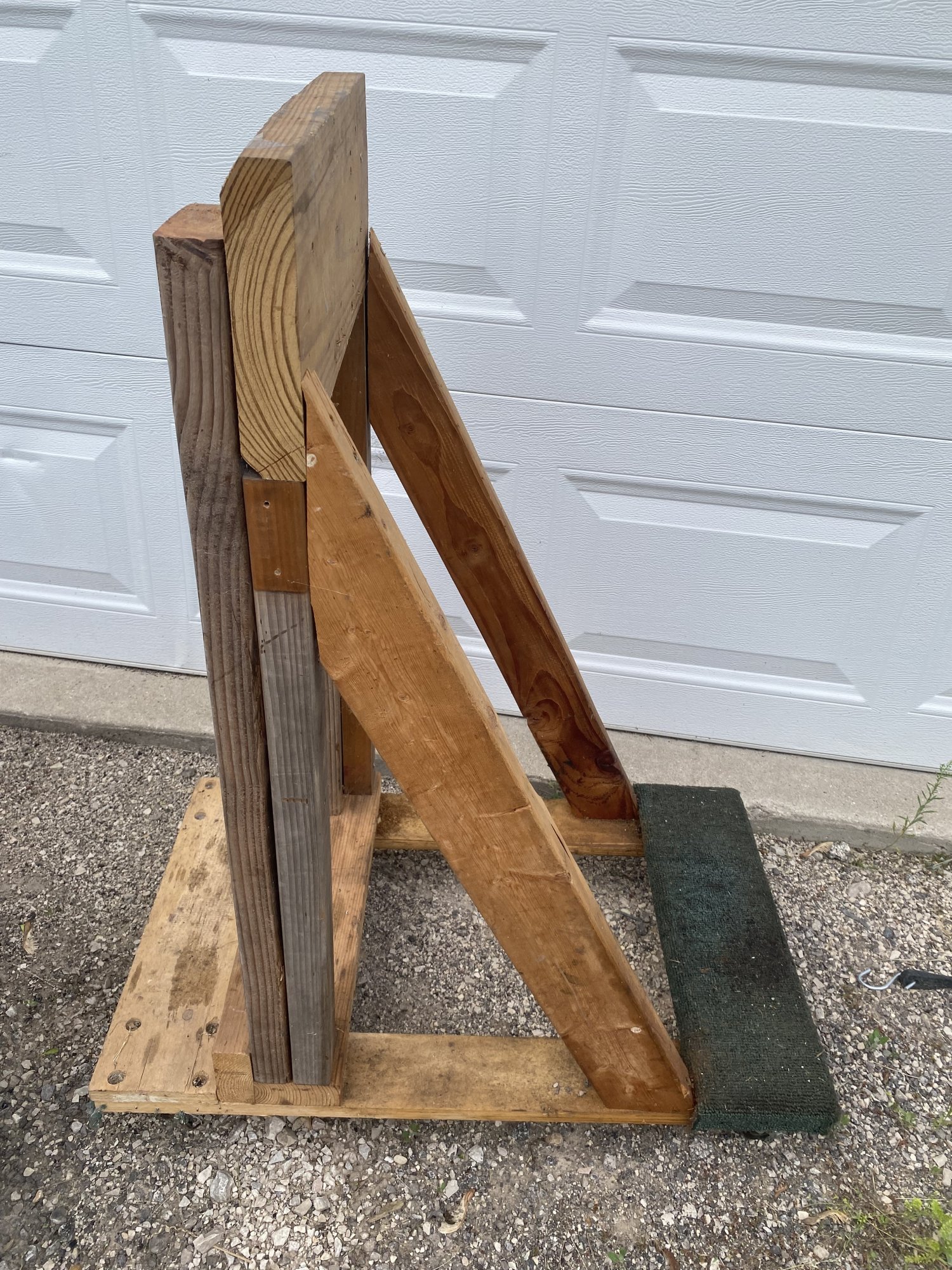

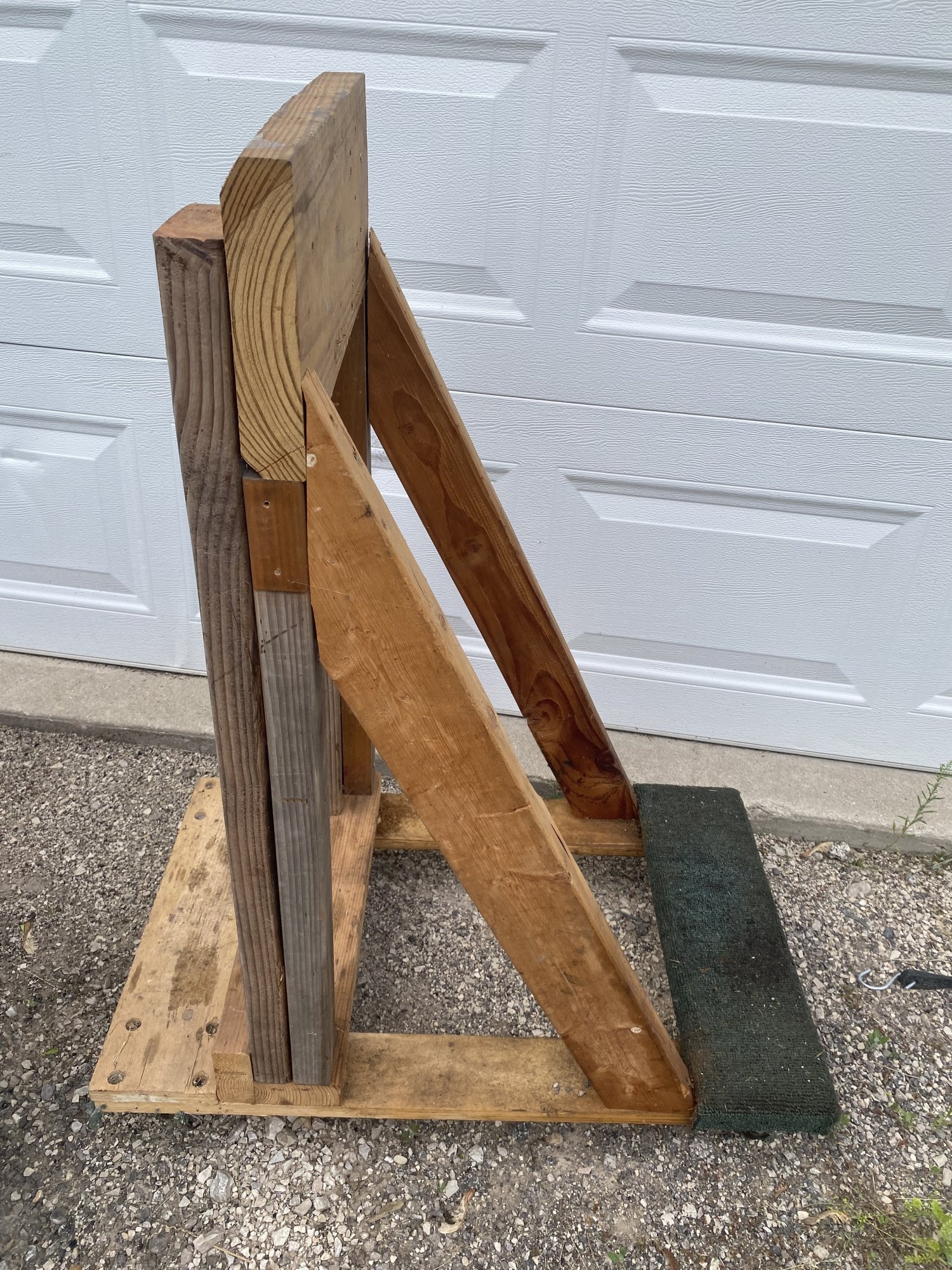

OK, please forgive the disgraceful condition, both of the stand and my garage!
The stand in the pic has been in use for several years, typically left outside except in the winter. I keep my Tohatsu 8 HP 2-cycle on it. About 55 lbs. 2x4's, 2x8 braces at the bottom, and OSB cross braces up higher. All secured with 3" drywall screws. Perhaps if you rotated the uprights 90 degrees there would be enough space between the upper cross pieces to allow you to tighten the hold-downs. If not, try 2x6 or 2x8 lumber. You could add wheels at either side, but I think you would need to run the axle (perhaps a piece of all-thread?) all the way across.
Even with small motors, two is a lot of weight. Be careful.

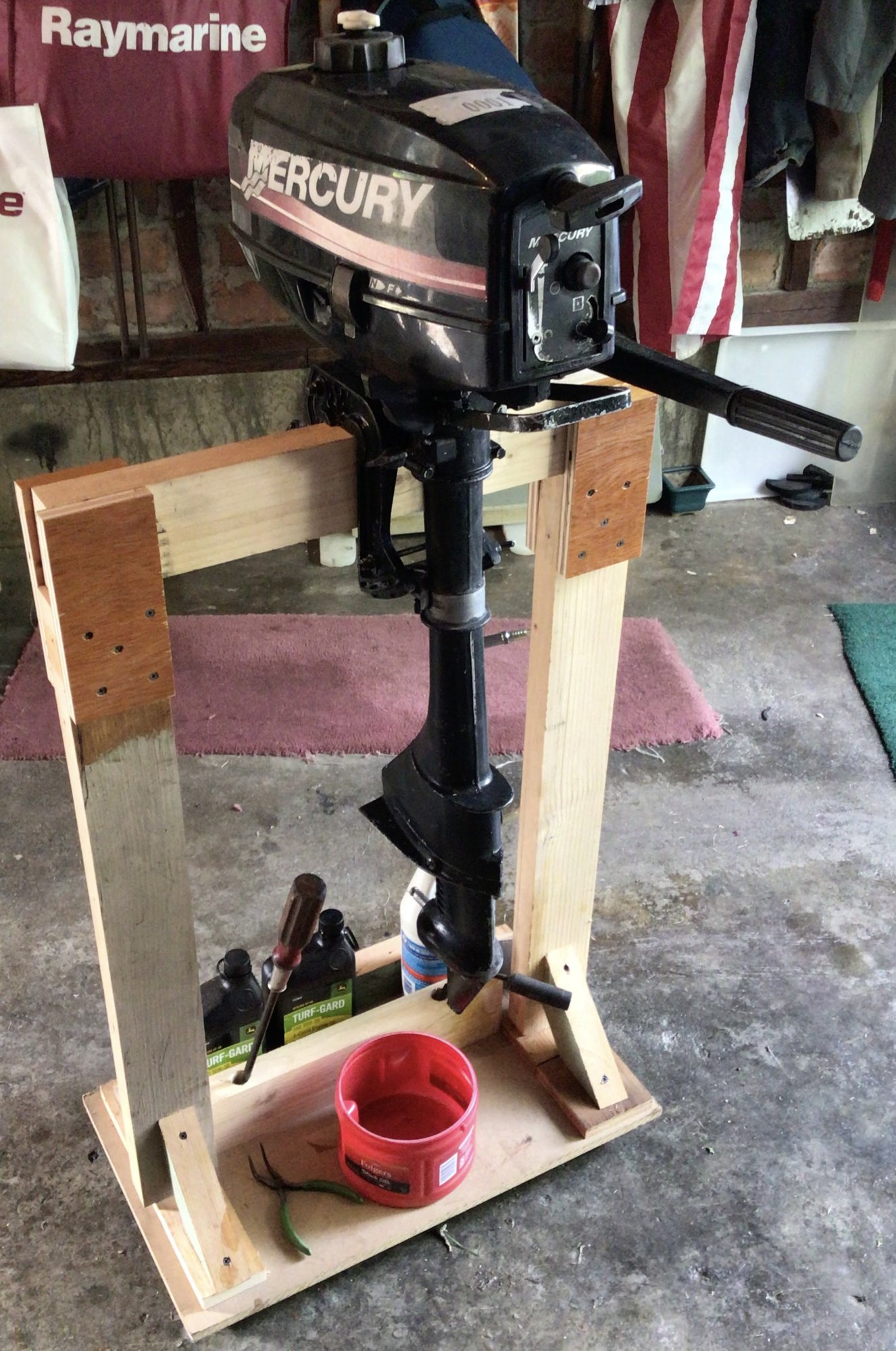

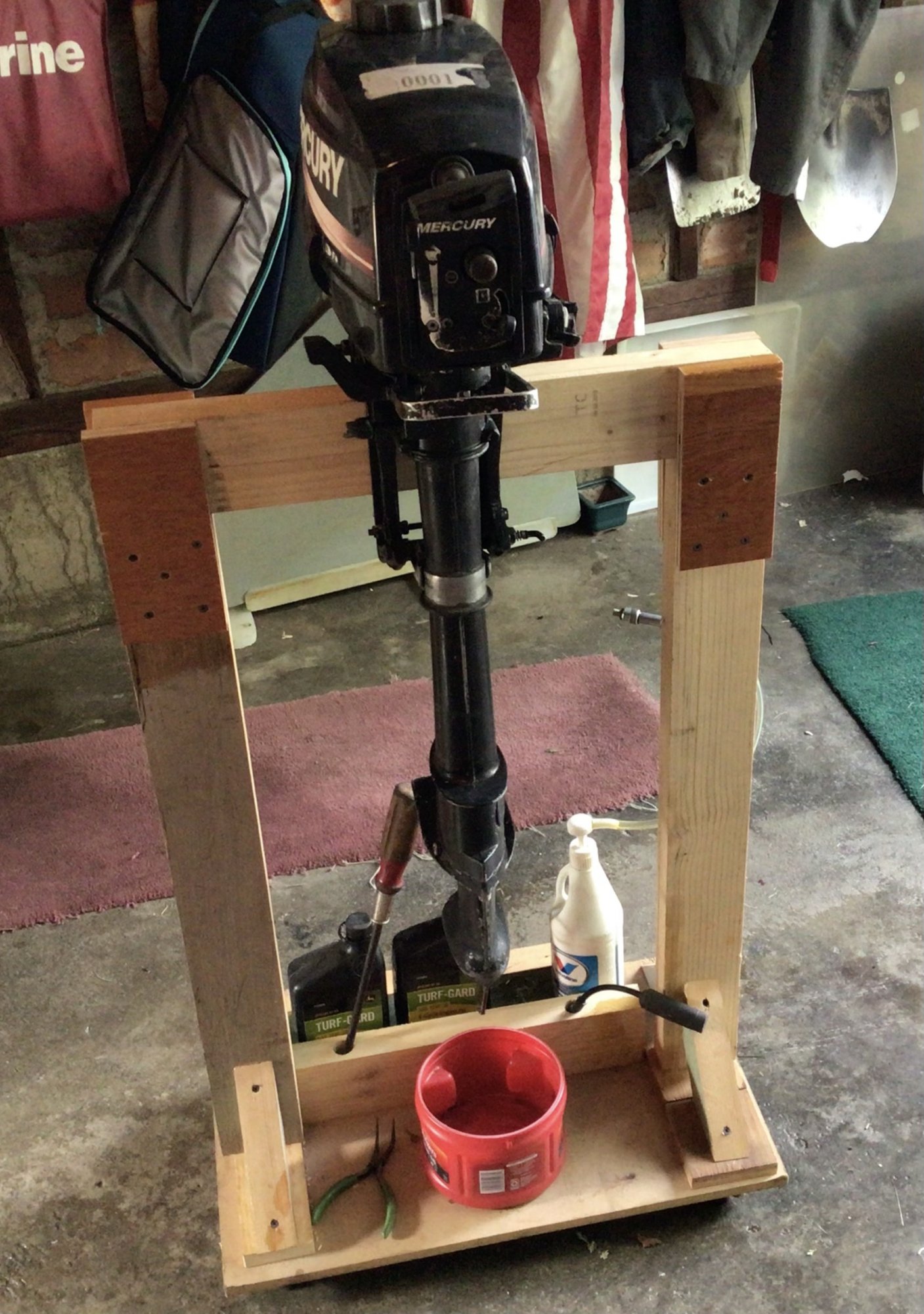

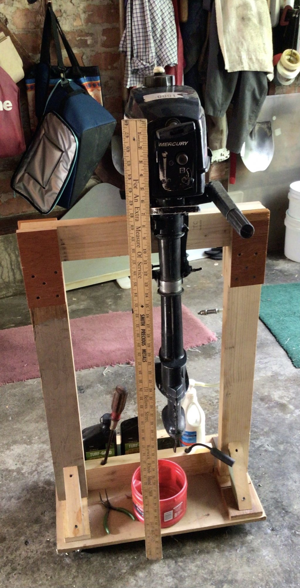

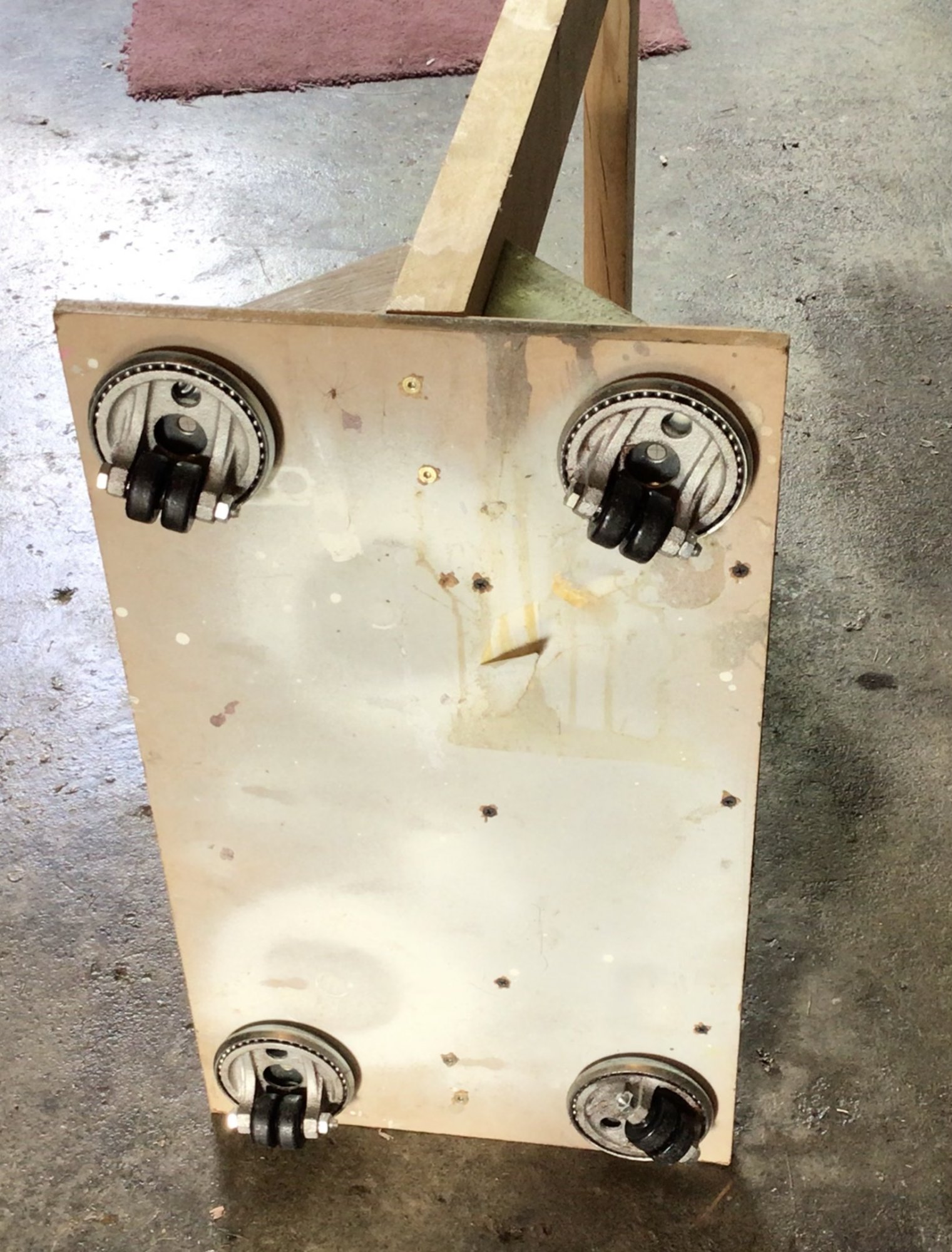

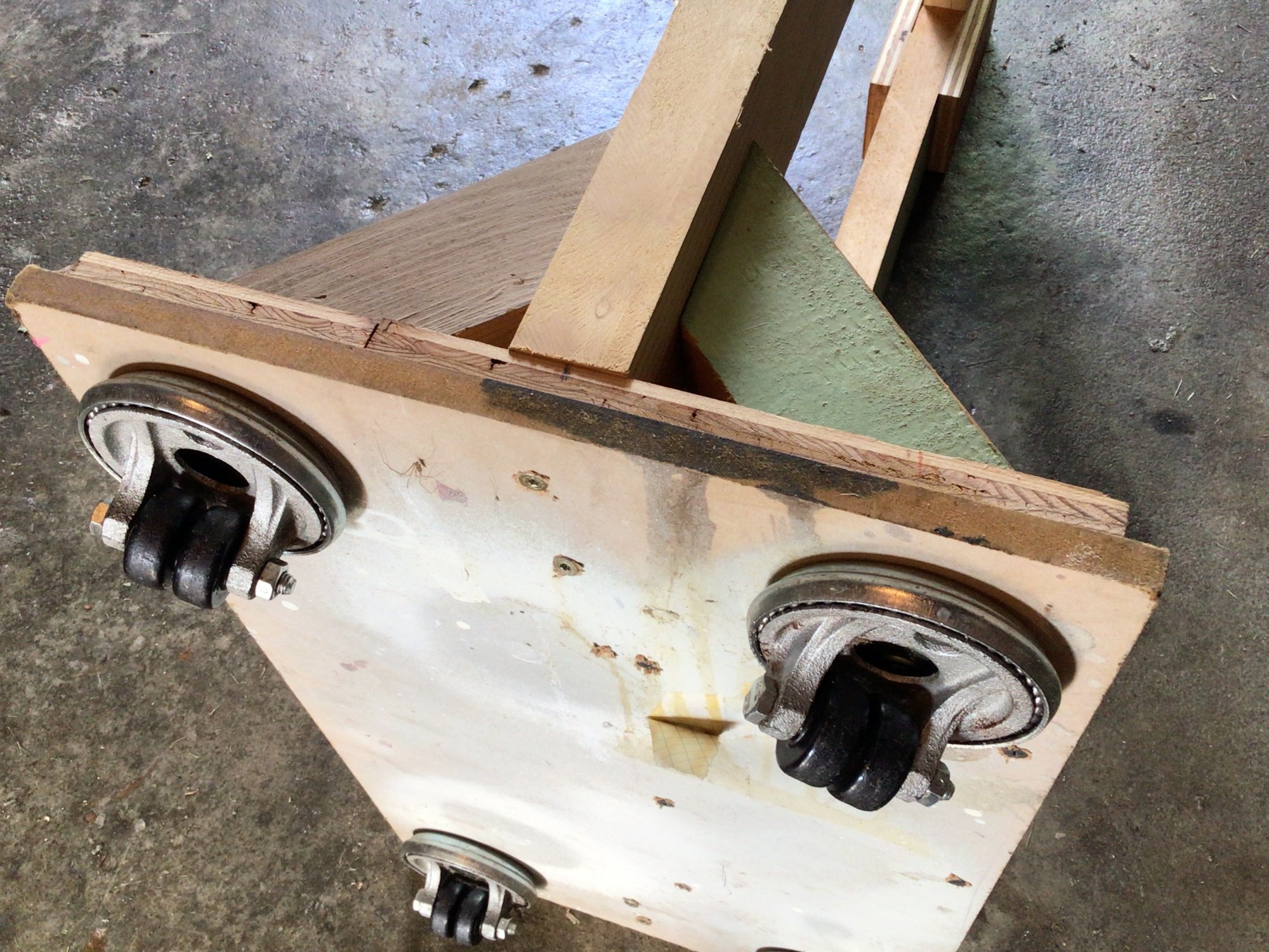

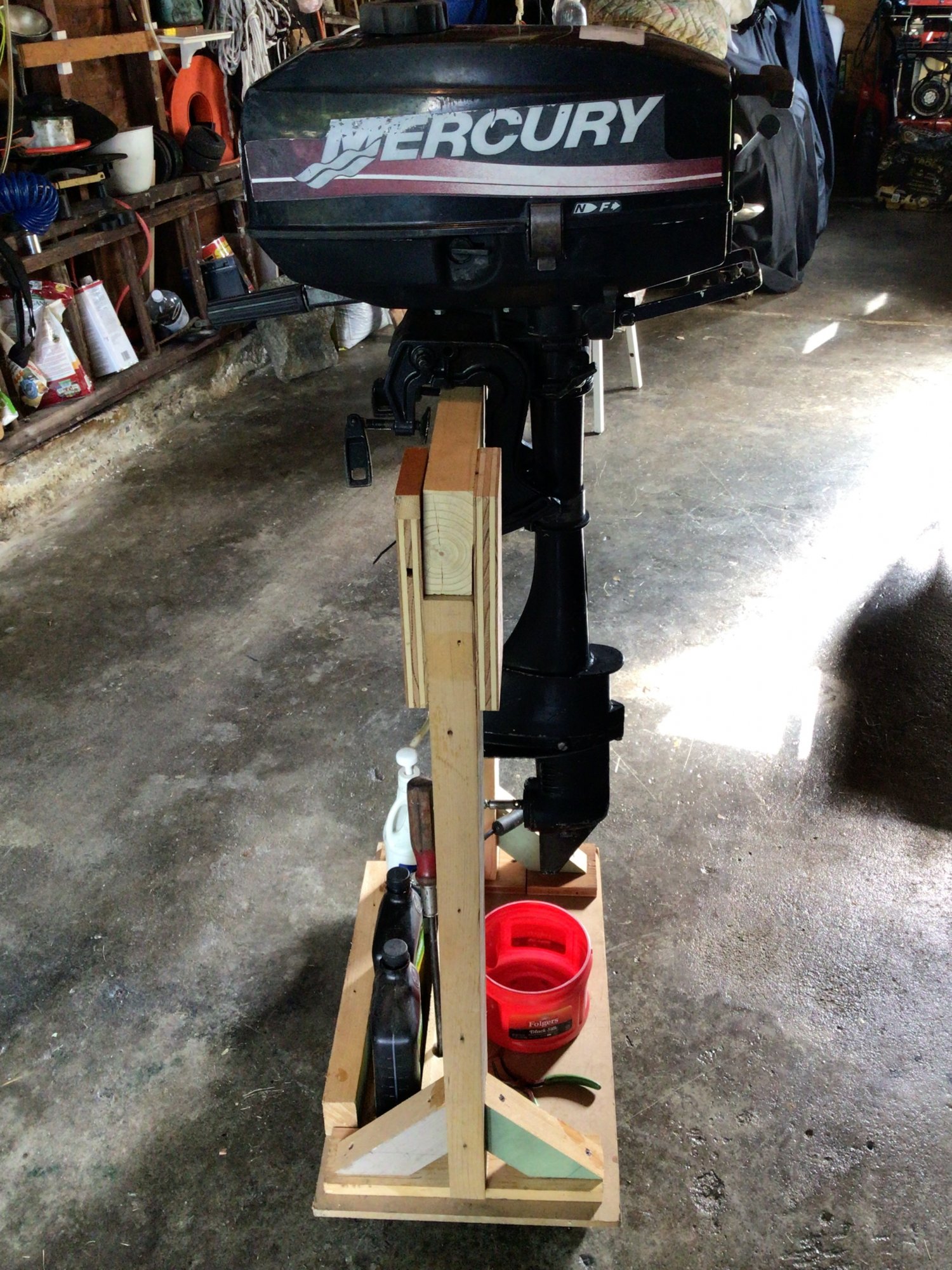

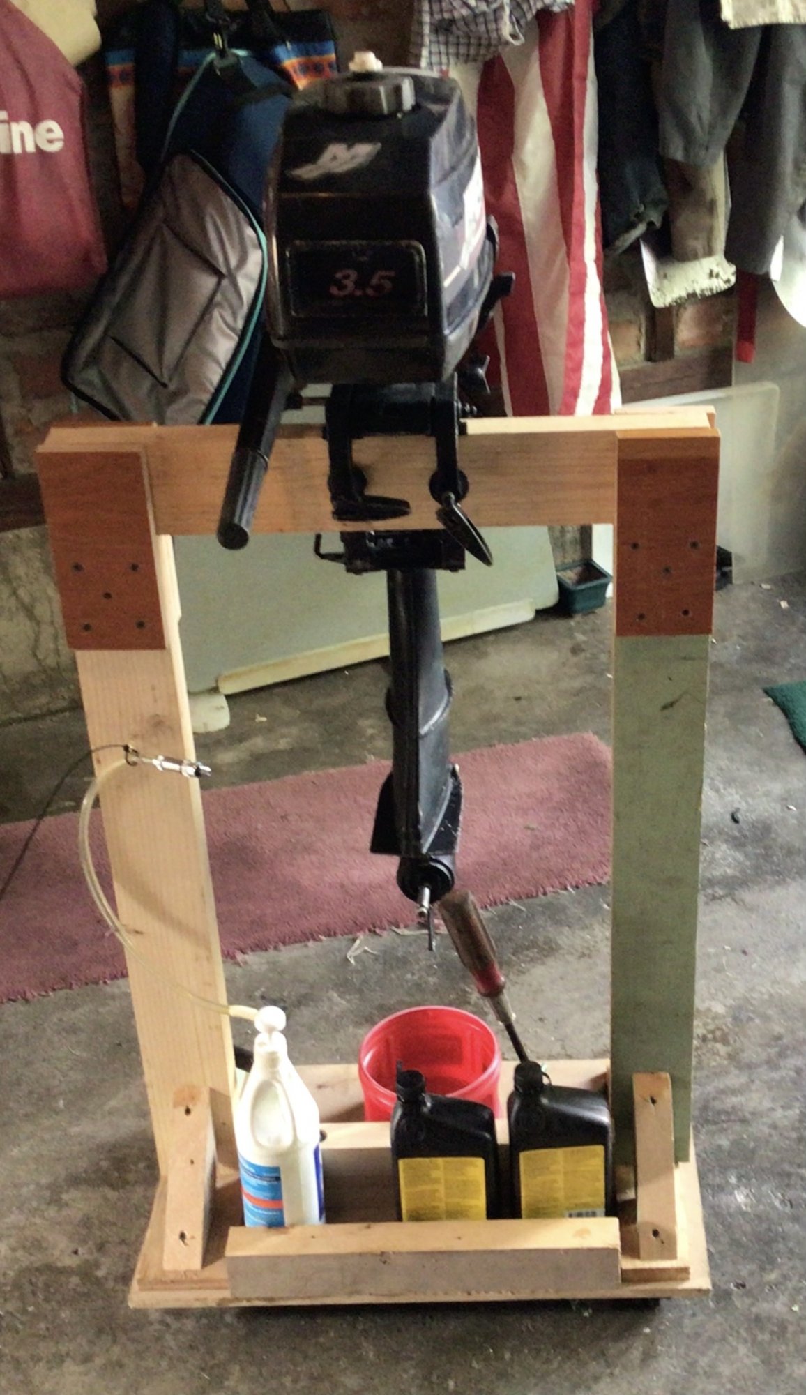

Built mine to fit in a space in the garage. As stated above, used scrap lumber, works great. Mine fits 2 small outboards. The photo shows my old Mercury 3.5 HP. My new Honda is being used right now, so not in the photo. But it does hold both. With motors on it, it all stands about 48” tall and the weight is centered.
I went with low profile casters (2” off the ground) to keep it low to the ground and lessen any tipping issues. Wheels around perfectly. As you can tell from the pictures, I had some extra left over so I added the tray to hold oil, pliers, screw drivers etc. The stuff I need.
All glued except for the cross beam, which is removable. (3” Screws from bottom to secure the 2 uprights, 1 5/8” screws for everything else.
Here are the measurements you asked for
Base - 15“ x 25”
Overall Height - 38” (Upright 2 x 4’s are 35 1/2 “ off the base)
Holding Brackets - 3 1/2” x 7 1/2” (holds the cross beam, removable)
45 Degree Braces - 7 1/2 “ long
2 x 4’s cut to 35 1/2”
25” Motor Mount Cross beam
Some day, if I find myself which extra paint and a brush in my hand…..I may paint it.
Good luck with your build.
