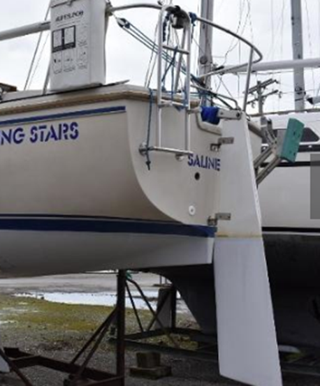

Something I noticed on the Cat 25’s as I’ve been shopping; A wee “skeg” just ahead of the rudder. It only comes down about 8” so it’s not a skeg. So, what is it called and what are its benefits?
Probably a bit of added course stability? Safer in a following sea?
23,465
It is an aide to align the flow of water over the rudder. As Dave says "improve tracking".
If not there, turbulence would occur on the forward edge of the rudder reducing it's effectiveness.

Depends on the hull form, keel, rudder placement and designer's goals. In the photo above the aft sections of the hull are broad, flat and upswept, that would make for good maneuverability as there is less lateral resistance which also means poorer tracking.
Boats like the Ranger 29 were influenced by the IOR rating rule which tended to favor boats with skinny butts and V shaped hulls. This made for pretty a fast upwind boat and as @shemandr notes, boats that are quite squirrelly under a spinnaker in a blow. The J24 broke away from the IOR tradition and broader aft sections and a flatter bottom. This was particularly beneficial with a spinnaker as it is easier to surf a J24 than an IOR influenced boat, making it a faster design.
