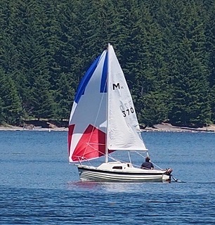

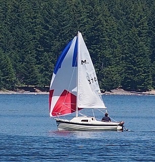

I enjoyed my Montgomery 15... A great solo day sailor. Even enough space to take a nap.
Easily trailerable. Did it for 18 years all over the Pacific NW. I could camp out and did occasionally, but most of the sailing was to pop the boat off the trailer, sail for several hours and then bring her home.
Advantage over the other two boats, she was a dry boat to sail. Decent height boat coamings that allowed me to sit inside the boat not on the side deck.

I really enjoyed her. Sold her to a guy (80 years young) so I could buy my next boat.
He sailed that boat for several years on Lake Coeur d'Alene, ID.
One time I saw a Montgomery at the start of a race challenged bay a 36ft C&C at the line. The C&C boom swung over and hooked the starboard shroud. The Montgomery was hauled around and dragged before they could get free. When they popped up the owner sailed her back to the marina where the mast and standing rigging was repaired. She was out on the water a week later. Tough little boats.

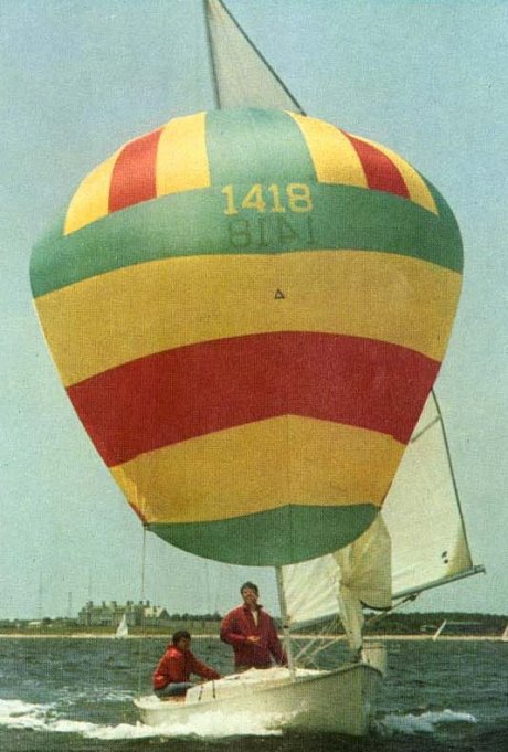

The Mercury and Blue Jay are NOT the same boat. You do NOT want a Blue Jay to sail singlehanded. It was designed as a trainer for junior sailors so they could learn how to sail, race, and use spinnakers. (Getting them ready for another S&S boat, the Lightning.) It is good for two (or three) kids, whose combined weight might come to 200 pounds. The jib sheets, spinnaker sheets, main sheet and tiller call for having at least four hands available to deal with them. Putting even a lightweight motor on the transom will hobble its sailing performance, and an adult doesn't really fit with the boat. Sitting on the floorboards will not be comfortable, and sitting on the side decks will raise the boat's center of gravity, making it top-heavy. Stepping and unstepping the mast is not particularly tricky, but it isn't as easy as some newer designs might be. As others have suggested, there are other boats out there that would be better suited to what you need.

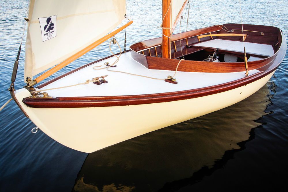

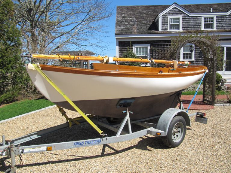

While the focus of responding ideas has been light weight plastic boats there are a few wooden designs that might be interesting.
Here are a couple of images.
Here are a couple of images....
@jssailem
John, that is a BEAUTIFUL boat. I'm completely ignorant as to what it is. Can you help a guy out? Is the logo on the sail for the sailmaker or the boat?

Looks like a Hereshoff 12 1/2; Doughdish. It would be a good candidate for handling some of the conditions you'd run into on the Hudson, but might be a bit under canvassed for typical summer doldrums. (That's why Hudson River Sloops like the Clearwater have such big sails.) Cape Cod Shipbuilding will sell you a new one for about $50k. Another boat perhaps worth looking into might be the Buccaneer. 18' long, heavy enough to be comfortable in but light enough and with enough sail area to be able to perform.
24,453
I thought it just looked like a daysailer I would be interested in if I was looking. Found it on a Small boats site. I'll try and look at my history for you.
