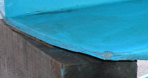

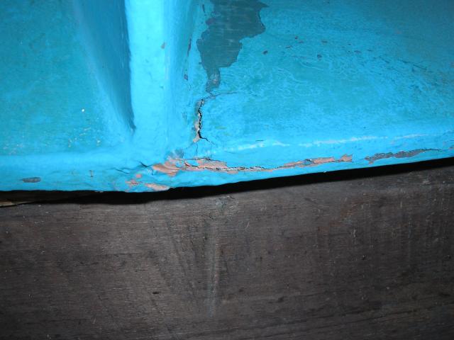

When i pulled the boat last fall I noticed a small crack along the wing of my keel. I'm not sure how it happened. the only thing I can think of was I got hung up on my mooring sailing of it. It might be the results of the mooring chain.
It almost looks like it's delaminating. I was going to grind it out with a Dremel tool and use a west system epoxy to fill it back. Is this the proper fix? Would I need to paint it with a barrier paint before using ablative paint?

The first thing to do is get the paint off so you can get a good look. I would guess that what you see is the tip of the iceberg.

I agree with Ross. No way of telling till you get a better look. Also you need to determine what the keel is made of. Some production boats use cast iron, some lead. Cast iron is very brittle, and chances are that a crack in cast iron goes all the way through. Lead is very soft, and could be just a surface crack in lead. The material will have to be considered before determining a course of action.

From what I "COULD " see it looks like the wing is a laminate. The damage out at the end of the wing looks like fiberglass under the paint. ?

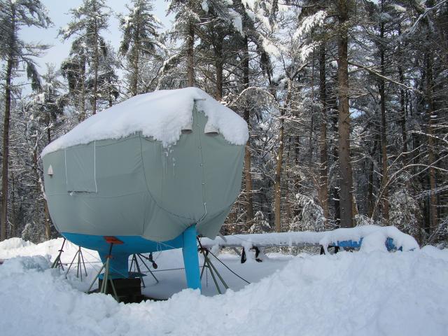

I agree Ross, I think it's fiberglass. I will have to wait a bit the boat looks like this now.

That keel is a solid one piece lead casting. It is then faired over at the factory and then barrier coated (depending upon when made it may not have been barrier coated). What I see from the photos is a bit of delam of the fairing. Grind it out re-fair and re-barrier coat or leave it as it is. It won't really hurt the lead any and is more an issue of flow and speed.....
It's also quite possible that it is many layers of hard paint beginning to fail...
We only got 6 inches of that white fluffy stuff and it should be all gone by Saturday.
Not trying to second guess you Maine but if he fairs with an epoxy product like West system, why add barrier coat?
You generally would not have to with an epoxy product but with the frugal nature of this board I have to sometimes assume folks will use a polyester based Bondo product from Wal*mart..;)
Also phenolic micro-balloons, the red fairing filler often used with epoxy, can absorb moisture if sanded fair and not top coated with epoxy resin. While not like a Bondo where it can totally saturate, moisture will only penetrate the top sanded balloons but this is often enough to prevent paint adhesion after the moisture get to this layer of balloons. A quick brush of resin over the sanded balloons will stop this just as a barrier coat product would..

Agreed. I hope those of whom you speak realise it is cheaper in the long run to use epoxy fairing compund with the proper filler than to cheap out on this and spend $40 for a qt. of barrier that will go mostly wasted.

Delamination of a keel is fairly common. If it is lead or iron, the metal must be properly etched before the fairing compound is applied. If it is not, they delaminate. You might be in for a bigger job than you thought and you must grind the laminate back to where the fairing compound adheres to the metal. The best tool is an orbital sander with a 40 grit disc. Feather the edges of the laminate where the void ends, properly etch with a wire brush, clean with acetone or a dewaxer solvent, and by all means use only West System if you want a good job. It probably was done with Interlux originally and that's why it failed. I have used West System for 20 years and never had a failure. I personally think Interlux is a marginal product. Rognvald
