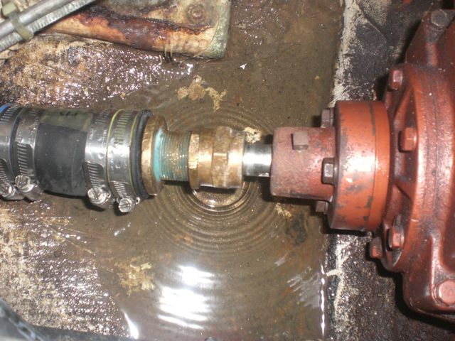

Here's a neat photo of how things looked before tightening cutless bearing
Water beginning to pool up below in engine compartment; half inch or so.
Time to double check the bilge.
Tightened bearing and bilge working.
Ahhh!
Pretty neat catching the drip ripples below--action shot, eh?:)
