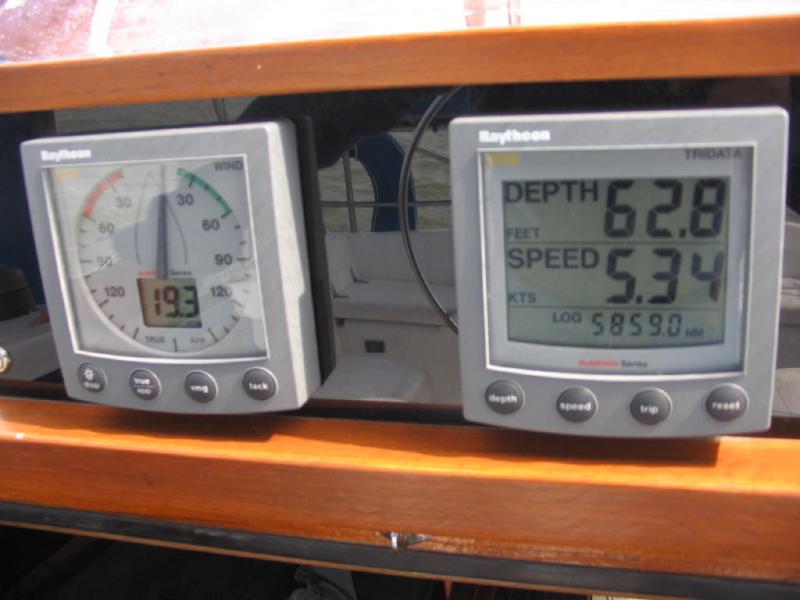

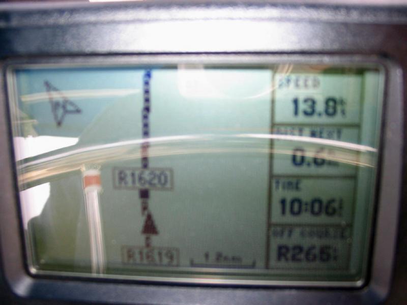

FourPoints, I believe your statement is misleading: you do not need to substract or add any current velocity if looking at GPS speed !
Since GPS calculates your SOG (speed over the ground) it does not care whether there is current or wind helping or slowing the boat ! And it is dead accurate ! Boat speed as obtained through any type of in-the-water instrument however (i.e. paddle wheel type or other) has to have current velocity pushing or holding the boat added or substracted only if you want to know distance you will cover. So if you have both type of instruments on board and you're reading 8 knots on the GPS and 6 knots on the speed/log instrument, it means your engine or sails are pushing the boat at 6 knots through the water but with the help of the current you'd really be covering 8 miles in that hour ! If you were against that same current, your in-the-water boat speed would still show 6 knots, but your GPS would only show 4.
YVRguy, if you're looking at your GPS take a look at the chart to find out whether your have any current for or against and of course check the situation of the tide where you are as both the ebb or flow will impact your GPS boat speed. FWIW, my 34 reaches 6.5 on both the GPS and the speed/log instruments when in perfectly calm and still waters at 2650 RPM (Yanmar 27, 3-blade 15 X 11 prop). However, GPS speeds drops down to 4 when traveling up the 2.5 knot current of the St. Lawrence river.
If you want the see the difference, look at the 2 pictures here as I was traveling down the lower St. Lawrence, motoring at 5.34 knots through-the water and 13.8 on the GPS. That section of the river has 8.5 knots of ebb tide current. Obviously you need to time your passage going up or down !
