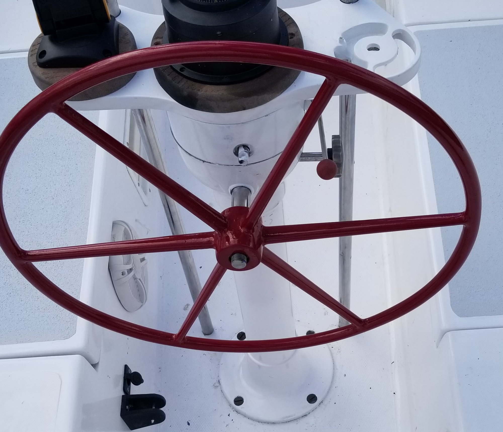

So my question. I have the old Cinkel (Edson look alike) pedestal with Atomic 4 shifters for tranny and throttle.
The transmission shifter slides over the rod into the pedestal. Originally, it looks like there was a threaded screw that held the shifter in place over the rod.
Over the years, this created an elongated hole in the rod and has created 'slop' in the lever.
I tried to compensate for this by drilling out the hole through the lever and increasing the size a bit. Hoping a through bolt tightened down would do the trick.
It has not worked.
If I take the lever out, I can put a large 'bore' screw driver through the hole and shift no problem. With the lever in place, I am bottoming out on the steering when I try to shift 'down' into reverse (because of the play). The Atomic transmission is properly adjusted...it's just the sloppy lever.
I can't find parts for the Cinkel, they are not interchangeable....any thoughts?
