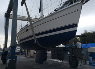

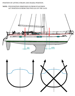

Consult your owner's manual for recommended lifting point like the ones shown on page 64 for the Beneteau 423 attached. The slings on my Hunter 46 at hauout (see photo) are in the locations shown in the diagram on the left. Post post #15 in this thread proposes where the fore and aft slings should be positioned lifting points - marking at hull... | Boat Design Net ..............the boatyard still needs to make the final decision as it is their responsibility to mitigate the risk of damage.
