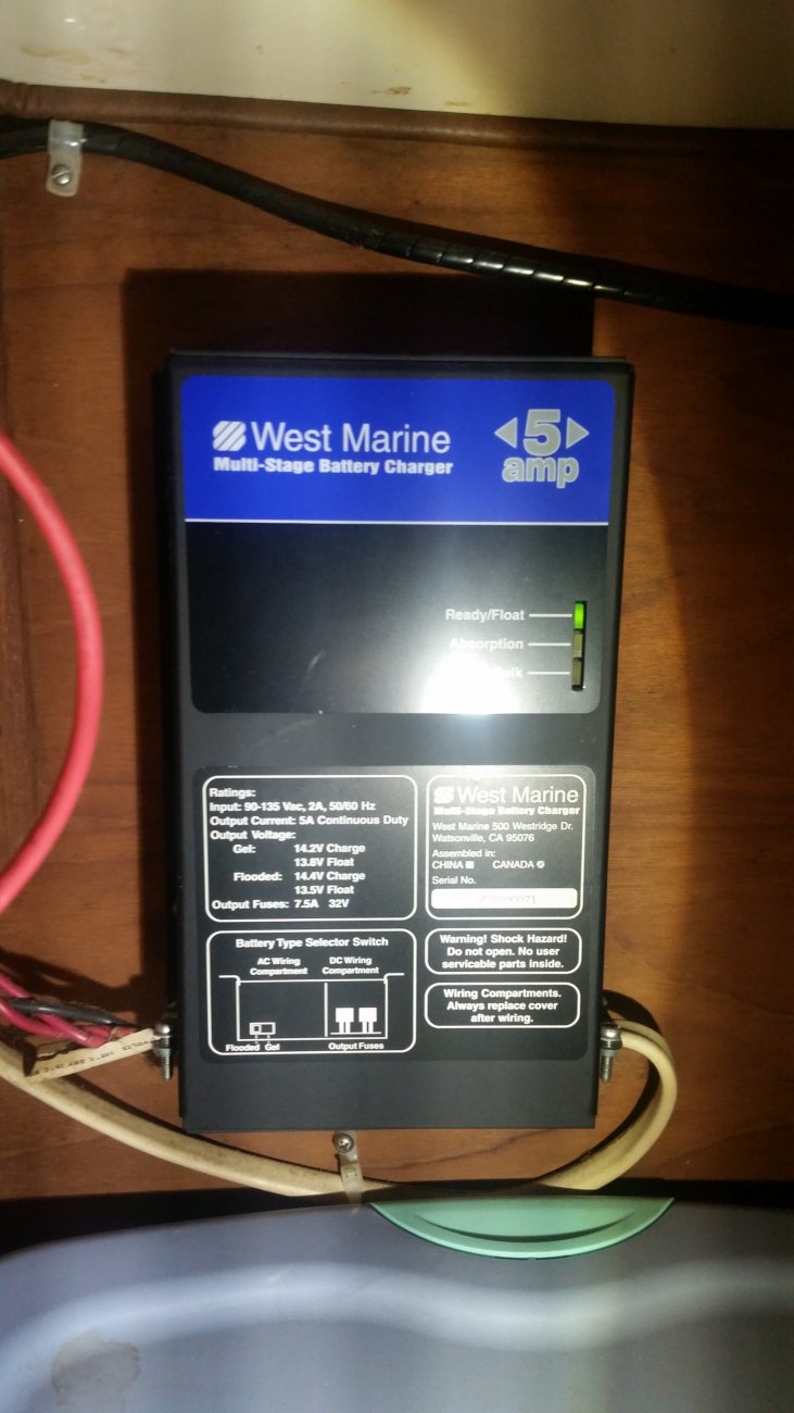

I lost two batteries over the last week, and am wondering if my charger has fried. This is the charger I have currently (I know it is too small, but it came with the boat)

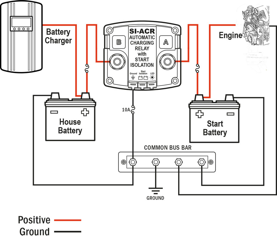

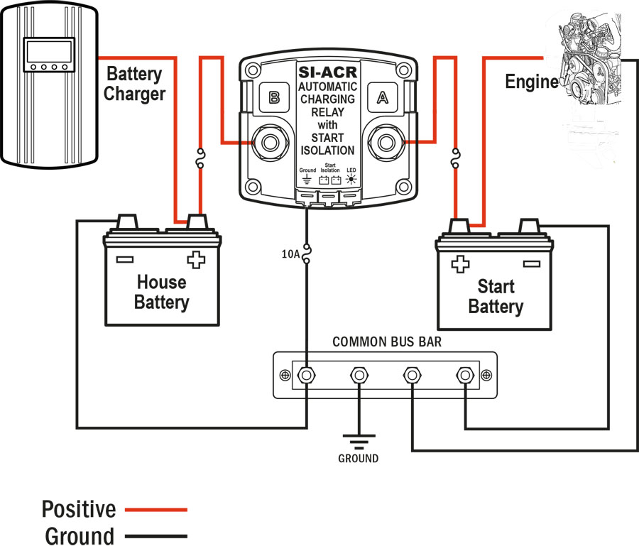

@Garbonzo , It is wired like this.

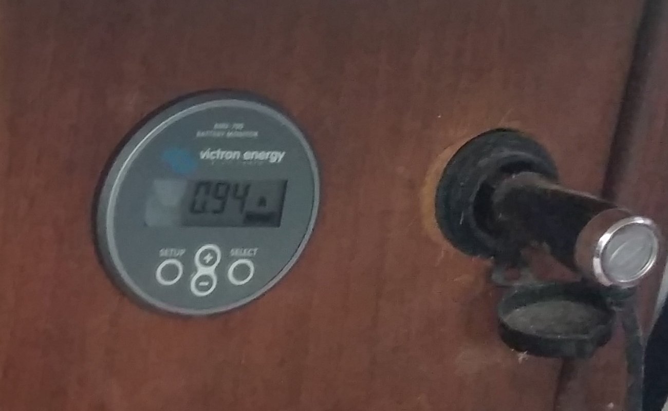

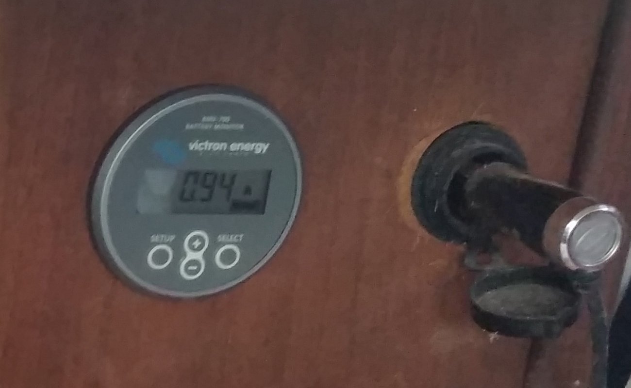

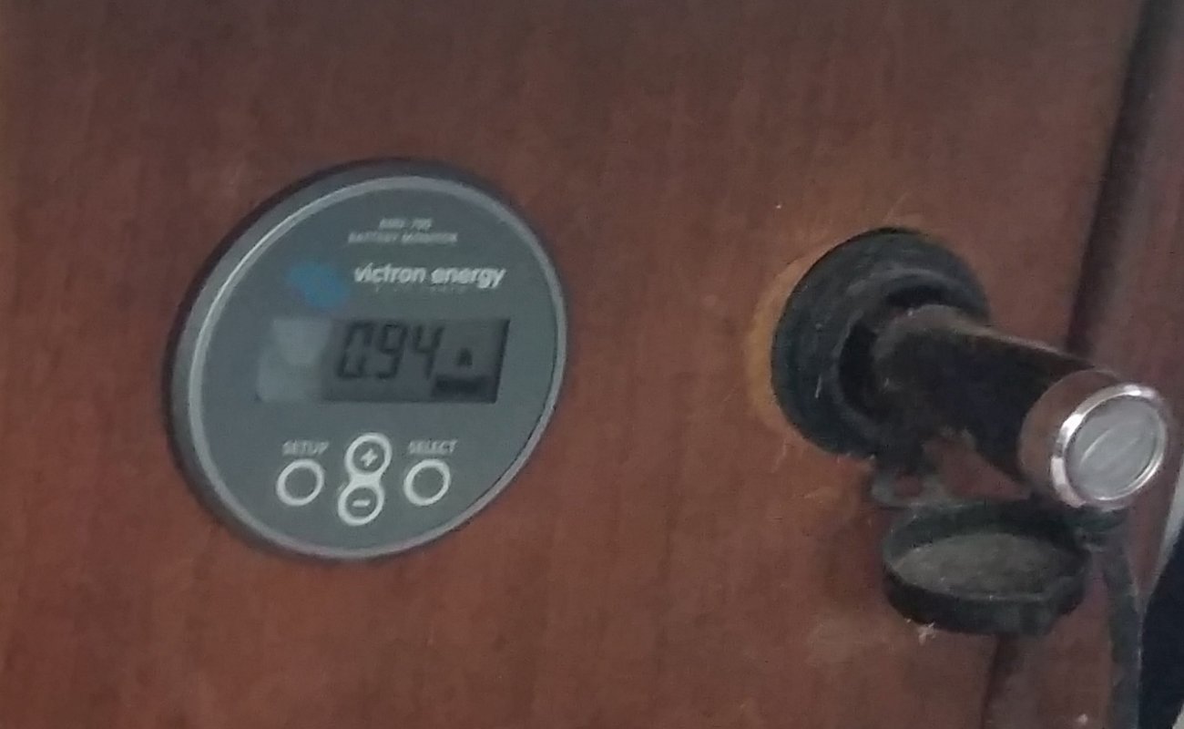

I also have a Victron Battery monitor installed. On July 3rd it was just showing low voltage. Yesterday it showed absolutely no voltage.
13,540
It looks like it is showing 0.94 Amps. It is easy to inadvertently change the display on the Victron.

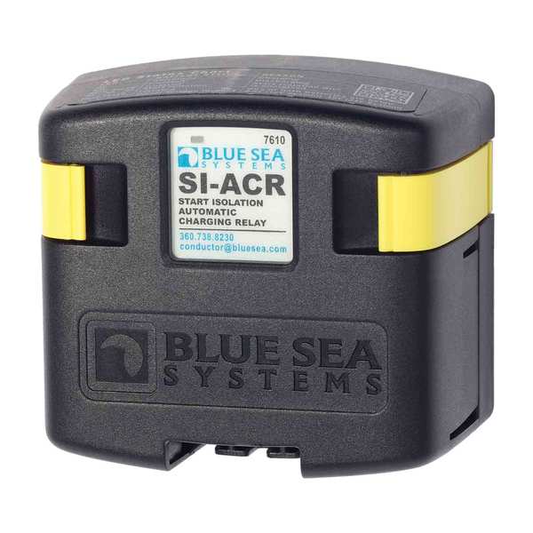

What is the Victron sensing, the start or the house? And where is the shunt located. Which battery was bad first?
Dec 4, 2018
60
Balboa 27 Denver
It could be a number of things, including an amp draw exceeding your 5 amp trickle charge and draining the battery (s). It could be with the start battery going that was shorting the acr and nothing going to the house.
You really need to get a better charger at any rate, and check the ACR.
The fuse on the negative seems strange to me, but I don't know that particular device, so it may be normal.
I would check voltage at the charger & at each battery with a hand held meter. Once I had those results, I would make other tests.
