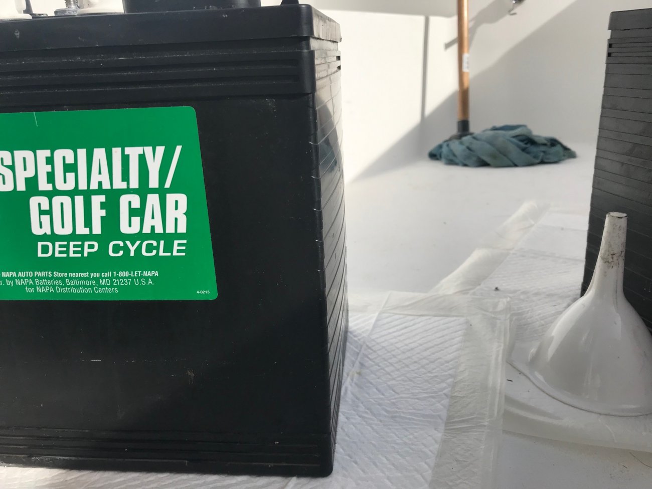

I was topping off our GC-2 batteries this weekend and found an every-so-slight bulge in the battery's casing. They are about three years old, and have really never done any real work (thanks to a variety of factors that kept us from spending much time at anchor). I have a Sterling 60A charger so I am not cooking them at all. In fact, I hope they are still near 100%. Anyway, I attached a picture. Is this something I need to be concerned about?

A bulge is bad news. Keep an eye on those batteries. Have plan B ready in case you have a sudden failure.

I would replace immediately. Any bulge in the battery case is, as @JimInPB said, bad news. Don't wait. Be proactive.

It means you have gas! No foolin' :eek:
Bulging batteries mean only one thing- buildup of gas inside. The gases are produced due to electrochemical oxidation of the electrolyte. Such oxidation occurs usually due to overcharging of the battery due to a faulty battery, or faulty charging electronics in the phone or battery charger.

I don't understand how that could be. Almost zero use, smart charger with float, I assume vented caps. How does gas stay so trapped that it creates the pressure to bulge out hard plastic?

With vented flooded batteries like those (Deka / East Penn) usually a bulge like that means they froze at one point. Were they left connected all winter? Did the marina lose power? How & where were they stored?

How does a thick plastic container bulge out? Heat softens the plastic, and pressure adds the bulge.
If it is slight it is good that it found a way of releasing the pressure. What are the temps? Does your SmartCharge have a temp sensor attached to the batteries?
Your avatar indicates you are in New Bern NC. There was a nasty storm there in the past year or so. Could there be a connection between the two?

Ok... The batteries HAVE stayed connected onboard all winter(s) with a temp sensor from the charger and always full of "water" (you know... with acid and all that stuff), so it is unlikely to have over charged or cooked them like my old charger would have. We keep a small heater in the bilge all winter. Did it keep it above freezing the entire time? TBH, it's hard to know for sure, but the marina were we are now never lost power over the '19 winter season and there were never very many BITTER cold snaps this year. HOWEVER, come to think of it, there were some EXTREMELY cold snaps last year when even our four oil-filled heaters couldn't keep up. The Neuse froze 3" thick or more. People had never seen a winter like it... and I was one of those people. You know... That's probably it. Truth-be-told, I would never have thought that battery water had a low enough freeze-point to do that. I mean... if that is actually what happened.
So I guess the next question is: Did it damage them? Is there a way to know for sure that is the culprit? I have bought a specific gravity bulb to do a quick health check this weekend. But seeing I haven't really cycled them over the past few years, will that tell me anything productive? And finally, is there a way to ask these questions without sounding like I am auguring with yall's answers so I don't set off members of this board that want nothing more than to make me fell bad about wanting to learn more about this topic? :)

This article will answer most of your questions.
https://www.trojanbattery.com/pdf/WP_DeepCycleBatteryStorage_0512.pdf
Those bulb hydrometers sold in autocrats stores are not that accurate. Spend a little extra and get a
refractometer. Get the right one (see link) and you can check the antifreeze and battery.

Don't panic; do not recognize the battery make and some of these battery manufacturers use, How do I say, "less expensive cases". The proof is in the pudding, 1) are they taking full charge? (6.38V) 2) are they providing adequate service? (time and power). I don't practice what I preach but keeping batteries on the charger 24/7 is not good for them. It is recommended that you turn the charger off for a week every two weeks unless they have been used. I use the boat frequently so I don't pay attention to that. If you notice that the batteries are discharging significantly faster than they used then replace otherwise just ride them until they die. Replacing them now or latter basically boils down to your type of sailing; whether you are taking an extended trip or whether you are just daysailing.
The photo shows the battery to be NAPA battery. NAPA batteries are house branded Deka/East Penn batteries. East Penn batteries are generally considered to be a good quality US made battery.

I've had 3 sets of Trojan T105s over the years and they all had a slight bulge. Florida heat?? Sulfation?? They seemed to work fine.

Same here, one battery had a bulge for two years, maybe more. It died last fall as we got into the Chesapeake and I isolated it until I could get it replaced. At our town recycling center the attendants don’t run to my truck as I pull in because they know whatever I’m bringing in aint worth crap.
