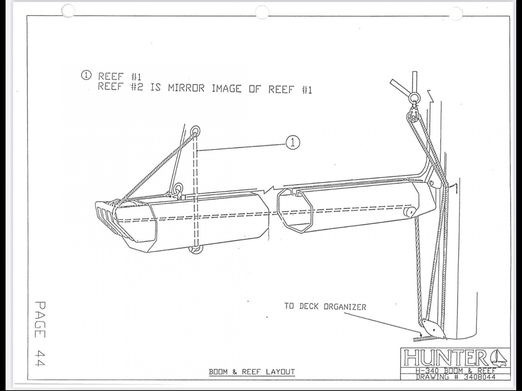

Not sure if this will help you, it comes from the pages of my 340 Manual. Thought I would add it though for you to see a diagram and Hunters instructions. It‘s all that was given in the form written instructions. Hope this helps
