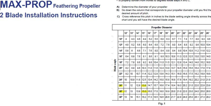

Thus I think that the only option is to install a fixed 2 blade prop. The MaxProp is a 3 blade 20" with an 18 degree pitch. According to the boat's manual, it comes standard with a 2 blade 20"x13 prop. How do these numbers compare (i.e. 18 degree pitch vs 13" slip).

The 18 prop is steeper than your 13 prop. The pitch of the 18 will go through 18" on one rotation but the 13 will only go through 13". A good prop shop can adjust the pitch of your new prop should you feel it necessary.

I understand the issues associated with the 2 blade prop. Note that the MaxProp is specified in degrees vs inches on the fixed blade prop.

MaxProp manual
20" at 18deg = 12.1 pitch. So 13 is about right for 2 blades. See picture.
It came from Maxprop manual.

For 3 blades, go to web site
If you go to Maxprop site you can download a 3 blades manual. As I recall the chart is the same.
You do need to send it back to be fitted. They have to match the parts together in order to be sure they fit smoothly.
