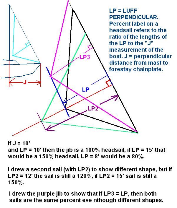

Those measurements of yours calculate out to a 119% genoa (19% overlap), thereabouts, based on the published "J" dimension of 11.5 ft and a calculated LP of 13.7 ft, namely: 13.7/11.5 = 1.19. So, as you say -- the sail may be a bit large but you'll have to put it on to see if it fits or not.

No offense...but the sail in your example is a mainsail. And mainsails are not sized the same way as headsails. The common and simple way to determine a headsail's size is to compare it's LP to the boat's J. Your formulas are misleading. IxJ/2 is the area of the fore triangle... LxLP/2 is a headsail's area.
