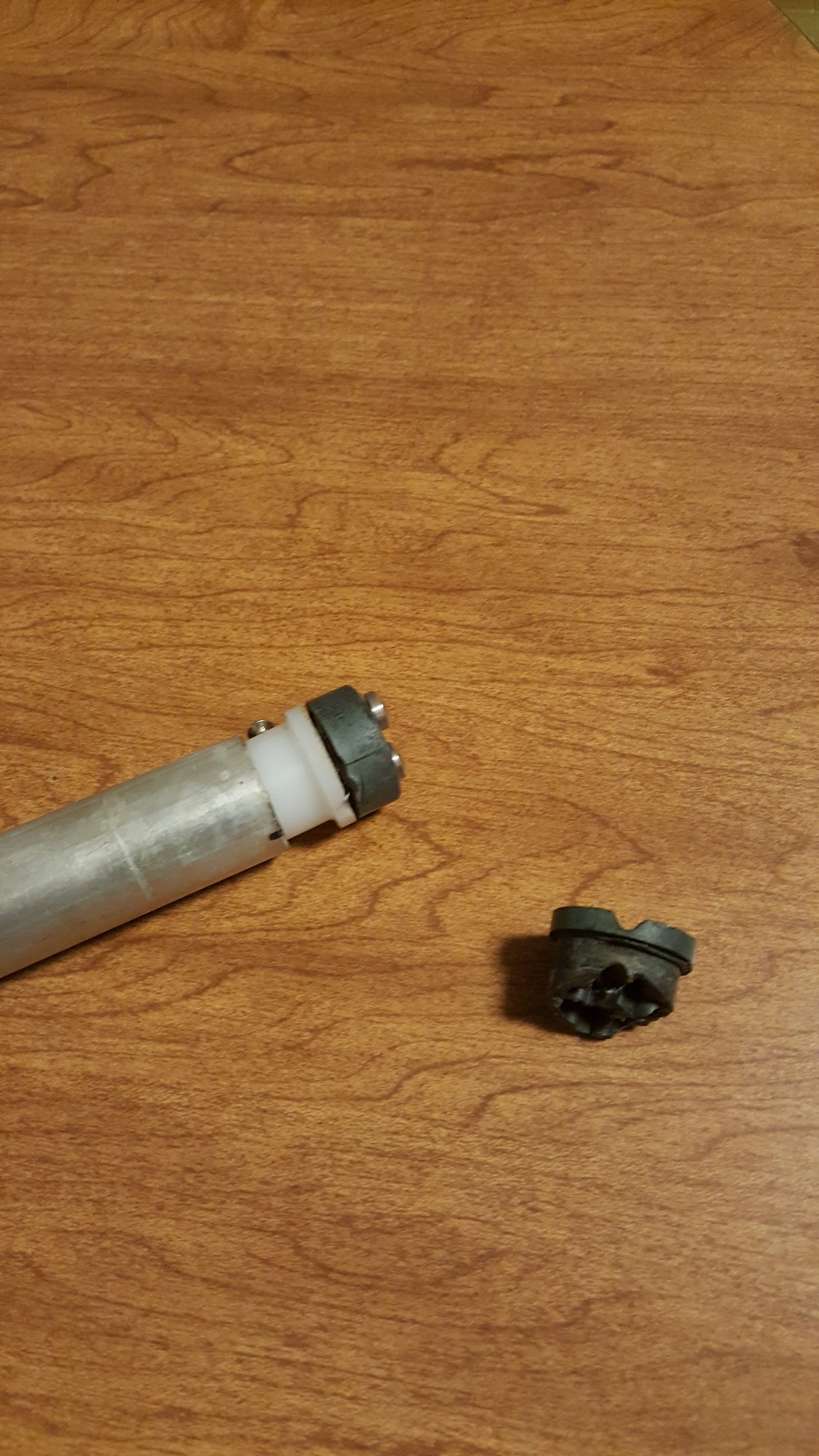

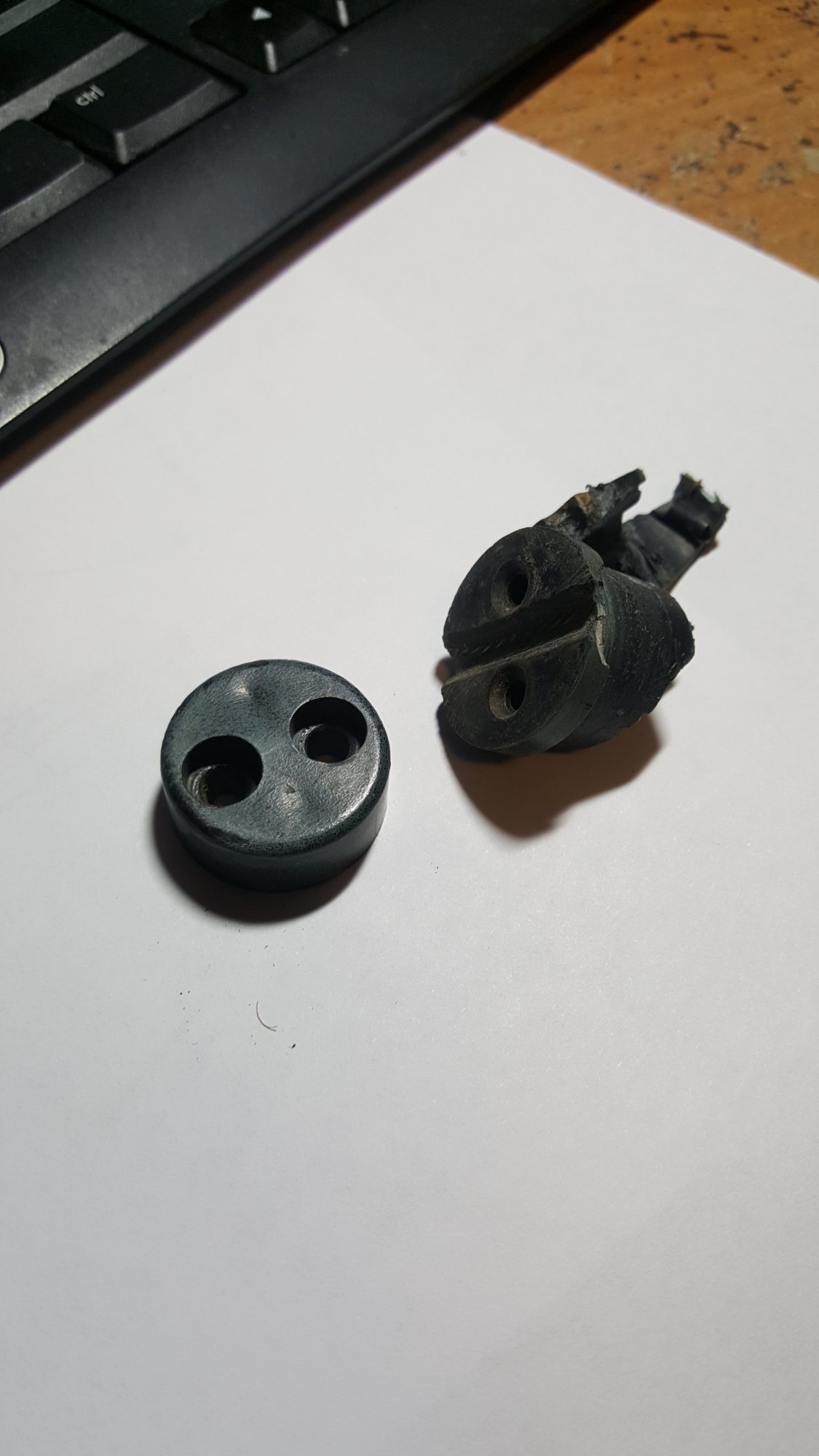

I just purchased a Sirius 21 and found the plastic stay holder in the end of one of the Mast standoffs is broken. Is there a supply house where these can be purchased as a generic version or should I just make one?
Yes, they are covers for the part pictured. I believe that part is called a spreader end. Search the store here for it and if you can't find what you need call them-they will get you set up.thank you so much..but are these boots just covers for the part I need?

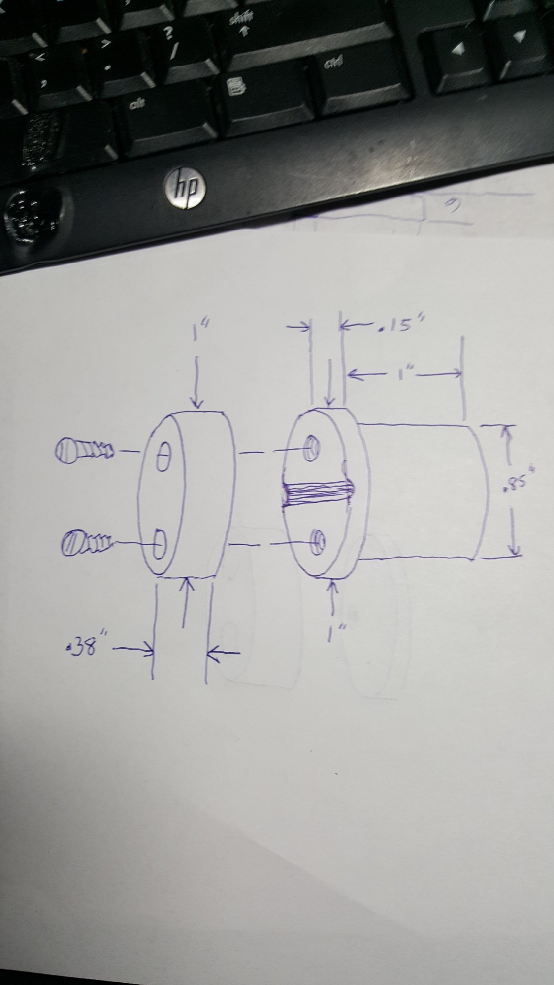

PerfectI decided to make my own.. i know someone with a lathe . should be able to make a couple in less tham half an hour. View attachment 183869Amazon has a 1" dia rod of nylon 12" long for $13. these pcs are 1" dia for the cap and the part that slides into the spreader is .85" x 1"
