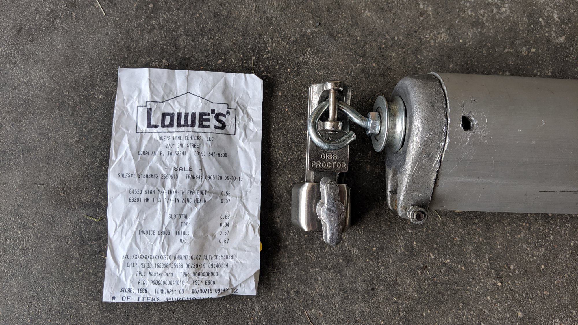

It's a great little boat. I had fun sailing it however, the goodneck broke. The boom apparently will roll so the sail can be rolled around it. I definitely need to research that. The design dictates a single bolt exiting the end of the boom. That bolt broke (see pictures). I haven't torn apart the boom yet to see how it works.
The hook attaches to a metal loop that attaches to the track on the mast.
Anyone have any information or advise for this repair?

Pull the duck tape off. There are probably some screws or rivets hiding behind the tape, or maybe not.
Pull the end off. The eye bolt is probably double nutted behind the end cap.
Find a compatible eye bolt, put it back together.
Welcome to the joys of owning an older boat, stuff happens. ;)
Go sailing.

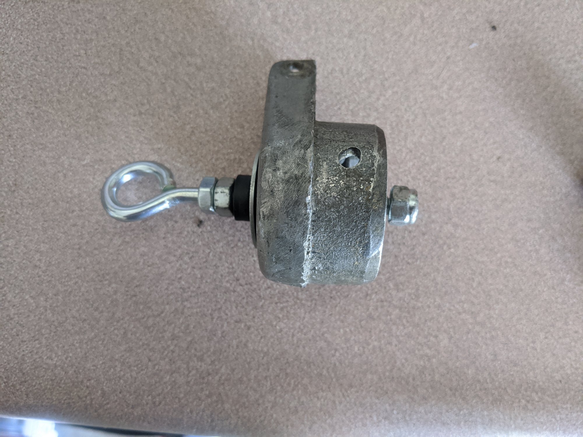

I spoke to the former owner. He affected this repair last year and it was done two years before that. This means that either it isn't being repaired properly or it's just a bad design.
My plan right now is basically to replicate the same repair so I'll be doing this again in a year or so.
Here is a photo he had. This is not the correct arrangement, however. He must have fixed it after taking the picture.
If any one has better ideas, I'm open to them.

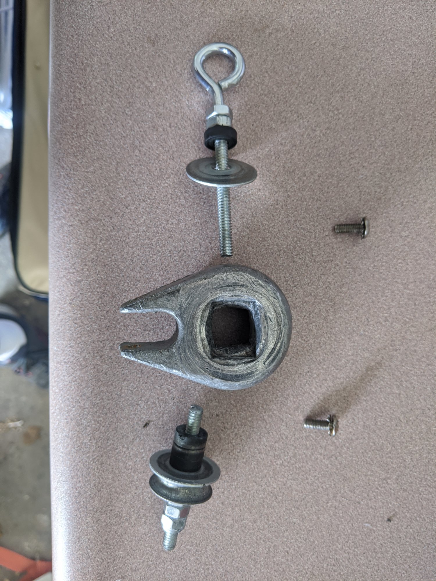

Here is the exploded view:
The new bolt being installed has the eye. The old broken bolt still has hardware on it.
I replicated the setup. So, it will break again...
I might reconstruct with a larger bolt and just forgo the furling ability of the boom.

If it was mine and OEM parts were not available I’d be looking for a higher quality eye bolt, I’d also see if I couldn’t find a way (drilling or tapping) to accommodate a larger eye bolt as well.
That is probably what I will end up doing.

Have a similar goose neck but the fitting, goose neck, with the spring was out of it. Thanks for the infomation. I will now put it back together properly, taking the end cap off the boom so that I can get the spring behind it.
