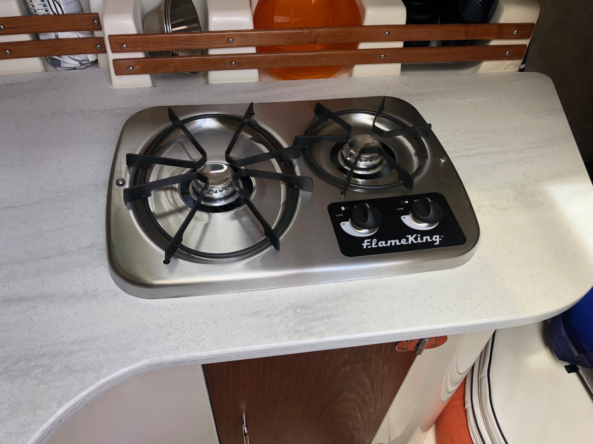

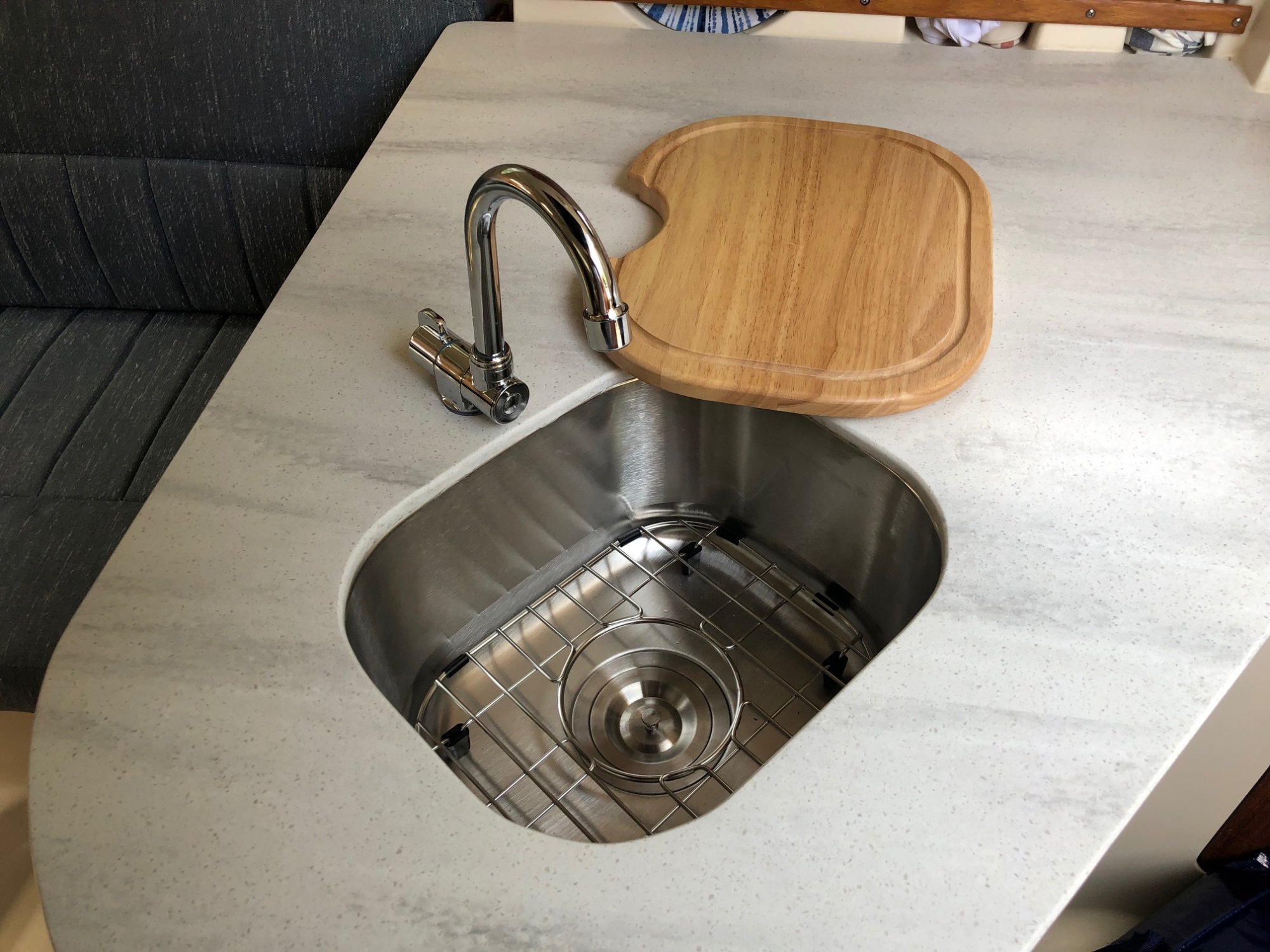

New under mount stainless sink with folding faucet fed by on demand pump.
Also new two burner cook top.

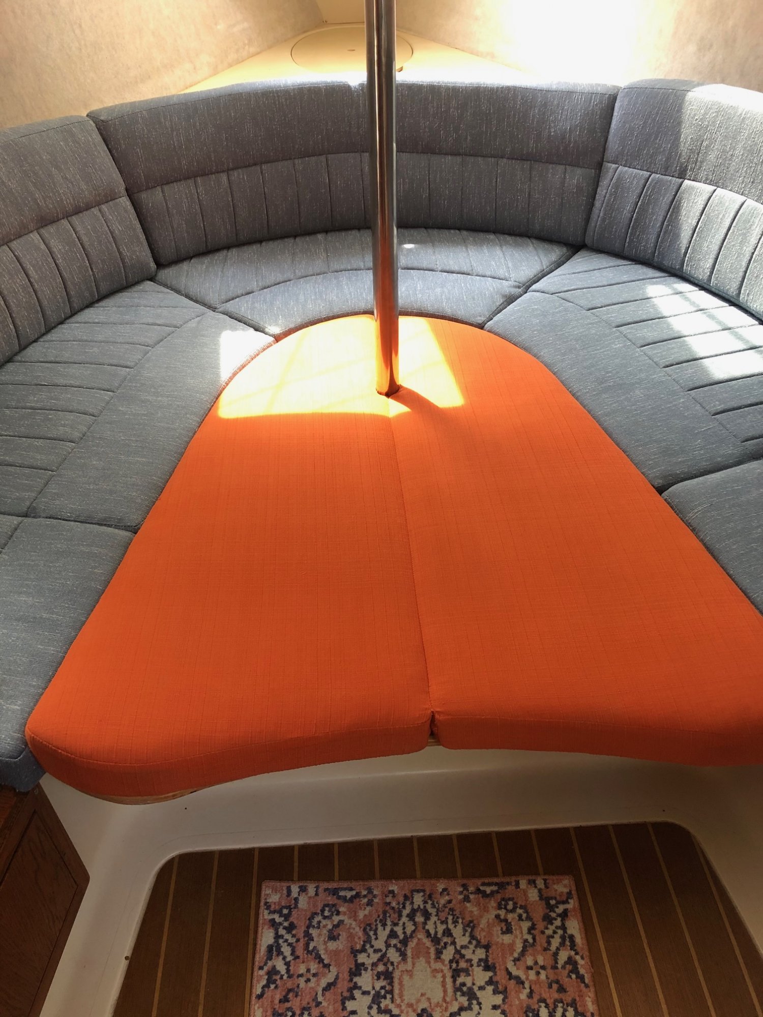

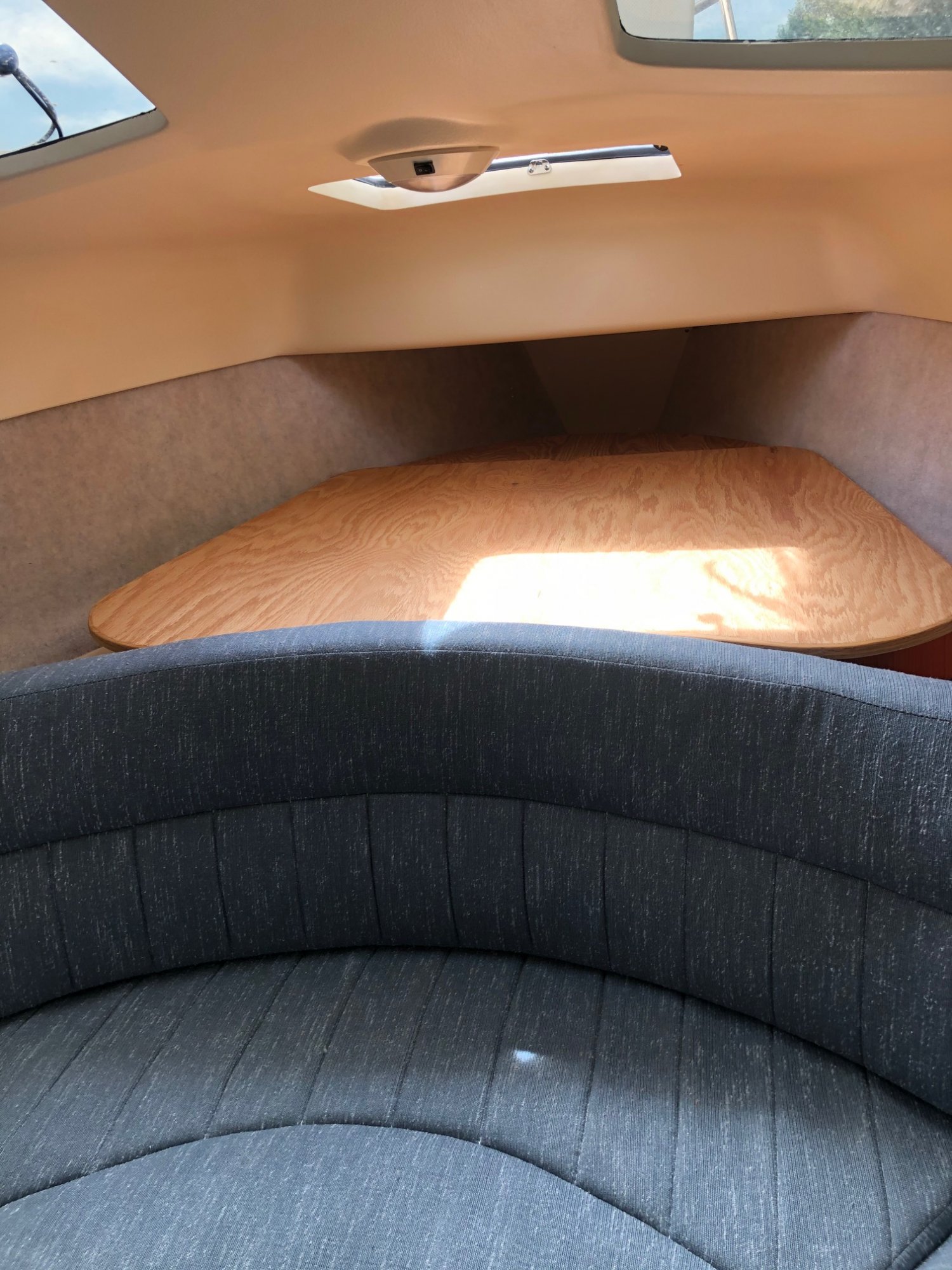

Drilled a new hole in the compression post to hold the shortened table up to the cabin roof when not in use.
Also made a two piece berth base that stows in the V berth location and a cushion so the dining area makes a WAY nicer berth than the aft berth. (Now for daughter and dog)

clive, those mods are really nice. the salon berth is how the boat should have came. how are you supporting the cushions? did you abandon the table?

Gudiss, no see the photo's i drilled a high hole in the comp post so the table cab be stored up by the ceiling. two pieces of 3/4 ply split across the C Post support the center cushion and are stored up in the V berth along with the center cushion. very comfy

Sounds like what I did on my boat. I raised the table as far as I could, I determined I could cut some of the aft end off of it. Raised it and made a hole thru the compression post and drilled thru it, like for a cotter pin, but used a bolt to hold the table up to the roof.

Yep, exactly what i did Ron, but i used the original stainless pin. I think i cut about 12-14 inches off the table but followed the same radius.

Right, No i cut the large side. I wanted there to be more room to walk around when the table is in its dining position. I knew we would give up the 180/V berth option but none of my family wanted to be up there and getting down in the night is a pain. Yes it means that you now have a table, and 2 pieces of wood to make up the Dining area berth, but then the berth support can be a better shape fore the bed and fit in the V berth, and the with the table held up against the ceiling, you kind of have the best of it all.. (Other than toting extra stuff)
