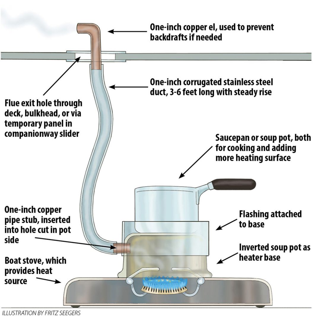

It sure looks homemade.
Custom-made. Implying the absence of cheap production methods.
In my case, I bought a multi-hull, and we need use no stinkin' gimbles.;) But it does get cold here, so I have a combo heater/stove.
