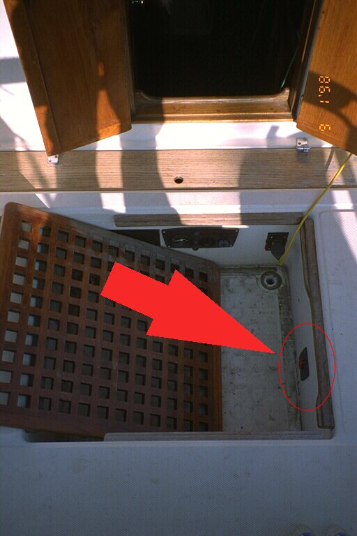

mbowser,
One of the best additions we made to our boat was a single lever for eng. We found the Spinlock unit.
The BEST part was that for the lever it uses a standard winch handle. We were at a used/salvage yard and found some very low cost light weight handles for next to nothing $$$ wise. Bought a couple and use them.
When the engine is off, we just pop off the handle and NEVER have any of the lines (or toes) tangle.:D
Greg

I like the idea of removing the lever so it's not in the way. It looks like the spinlock unit is an add-on to an existing teleflex installation?

Our Spinlock was fitting was bought by itself back in about 2002 (I think). It drives 2 Morris cables to our Yanmar 2GM20. A BIG difference in engines, but thought they might carry one to fit yours.
Greg
