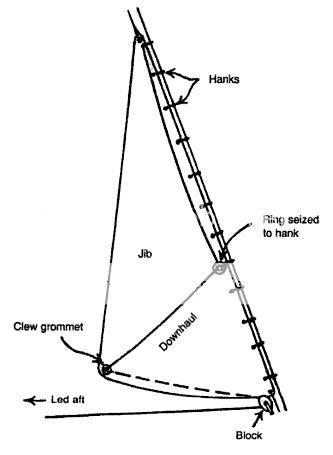

I often singlehand and in choppy water I'd rather not go forward to douse the jib (no furler) so yesterday I rigged up a jib downhaul so I could lower the jib from the cockpit. It worked great except I still had to go forward because the jib ended up in the water (almost), spilling over the side.
I suppose if I had lifelines it may stay on deck, but that project comes after some others I have planned.
Anyone have a solution?
