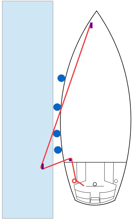

Theoretically you could toss it over a dock cleat.
This is not theory, it is fact. Only issue you have in your system design is the limit of the line as being tied to the stern cleat.
Might I suggest: you keep the line tied to the bow or at least a mid cleat ahead of the pivot point on your hull. You run the line back to the cockpit with enough slack line (at least the length of the boat plus 20% longer). Now when you approach the dock (SLOWLY) you do just as you suggest. HOLDING ON TO THE LOOSE END, you toss the middle of the line over the first cleat (or bulwark) you encounter as you approach the slip. While still on the boat you pull in on the line end, and secure the line over a winch or cleat as you desire. You can tension the line and your boat will snug it self up to the slip. You can put the boat in idle and forward gear and the boat will stay against the dock proceeding no further forward than the where your "spring line" makes a 90º angle with the line you have secured at the cockpit or stern.

My slip is challenging, I'm on the downwind and down current side of the finger dock so I'm always getting blown off, into my neighbor. I use a docking bridle secured to the bow cleat. It is all set, through the turning block and a loose loop over the winch before getting to my slip. I pass it over the cleat at the end of the finger dock then pull in around the winch. When I put the engine in idle forward the boat gently pulls into the dock and I have all the time I need to pick up my mooring lines.
The hard part is convincing people "helping" at a dock to NOT take any turns around the cleat, juts let it slide.

With my previous boat and an outboard, I kept lines on the dock and rigged a line at midship on the chainplate that I could step off with. A boat of that size is easy to push/pull manually. My present boat is an inboard and twice as heavy, so I depend on a permanent spring line from the aft dock cleat (coming in frontward) led forward to the midship cleat. I step off, put that line on, get back on and idle forward with the tiller toward the dock, which draws the boat closer and holds it fast against the spring line. From there, it's easy to place all the dock lines. A similar strategy is a loop- one end secured somewhat forward (like shown above, but I don't put mine all the way forward), one end on the aft boat cleat, with enough line to toss over the first cleat encountered on the finger. This does basically the same as the forward spring line I described and may work better for an outboard, since one doesn't need propwash to draw the boat closer. It does, however, require an unencumbered cleat to catch that loop- I would not trust tossing that line around a loop piled high with permanent dock lines.
