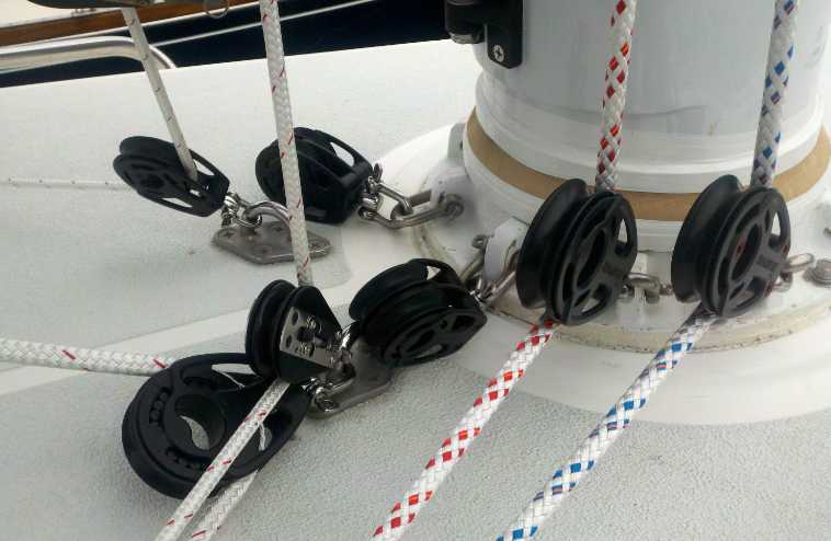

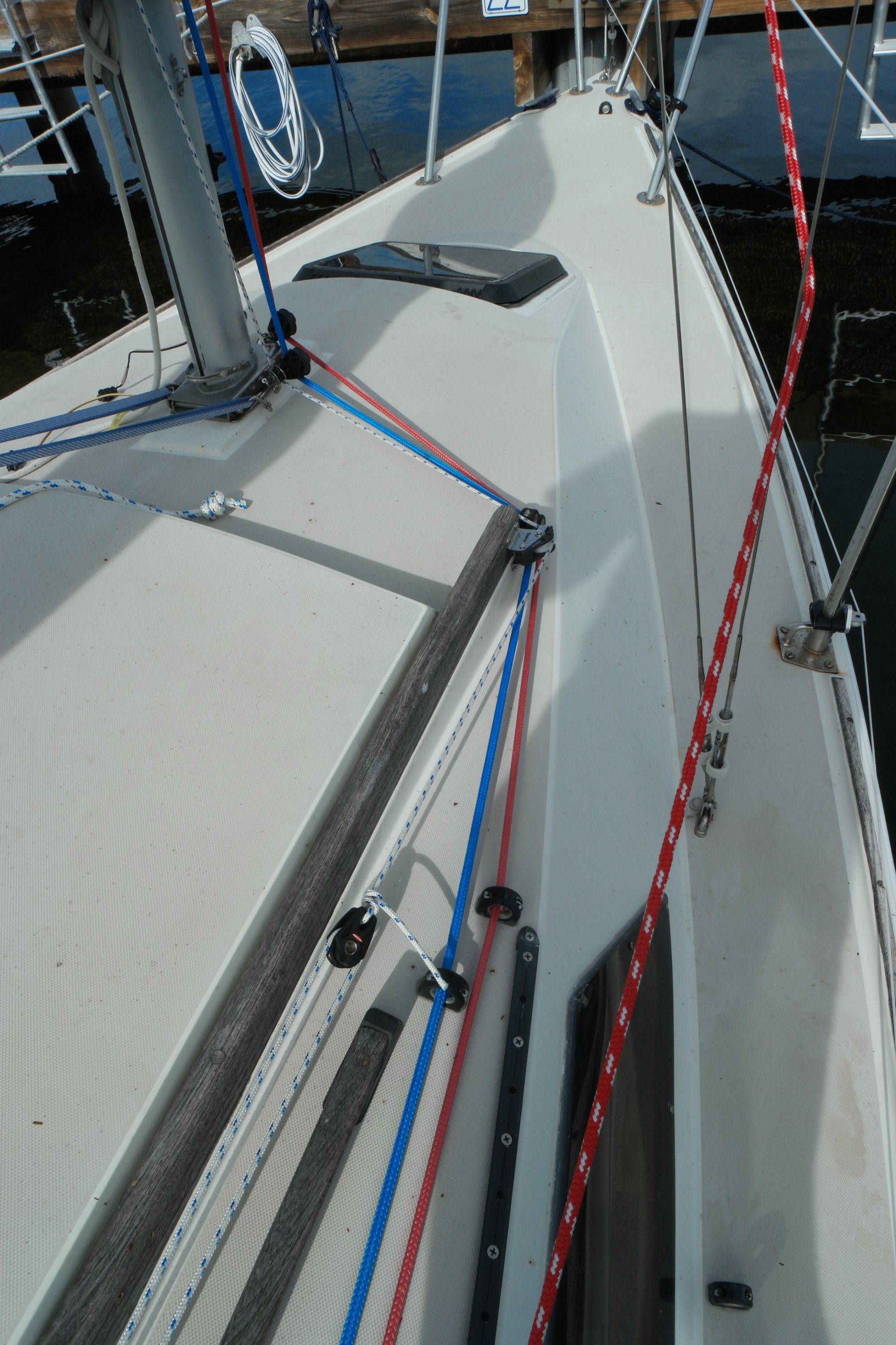

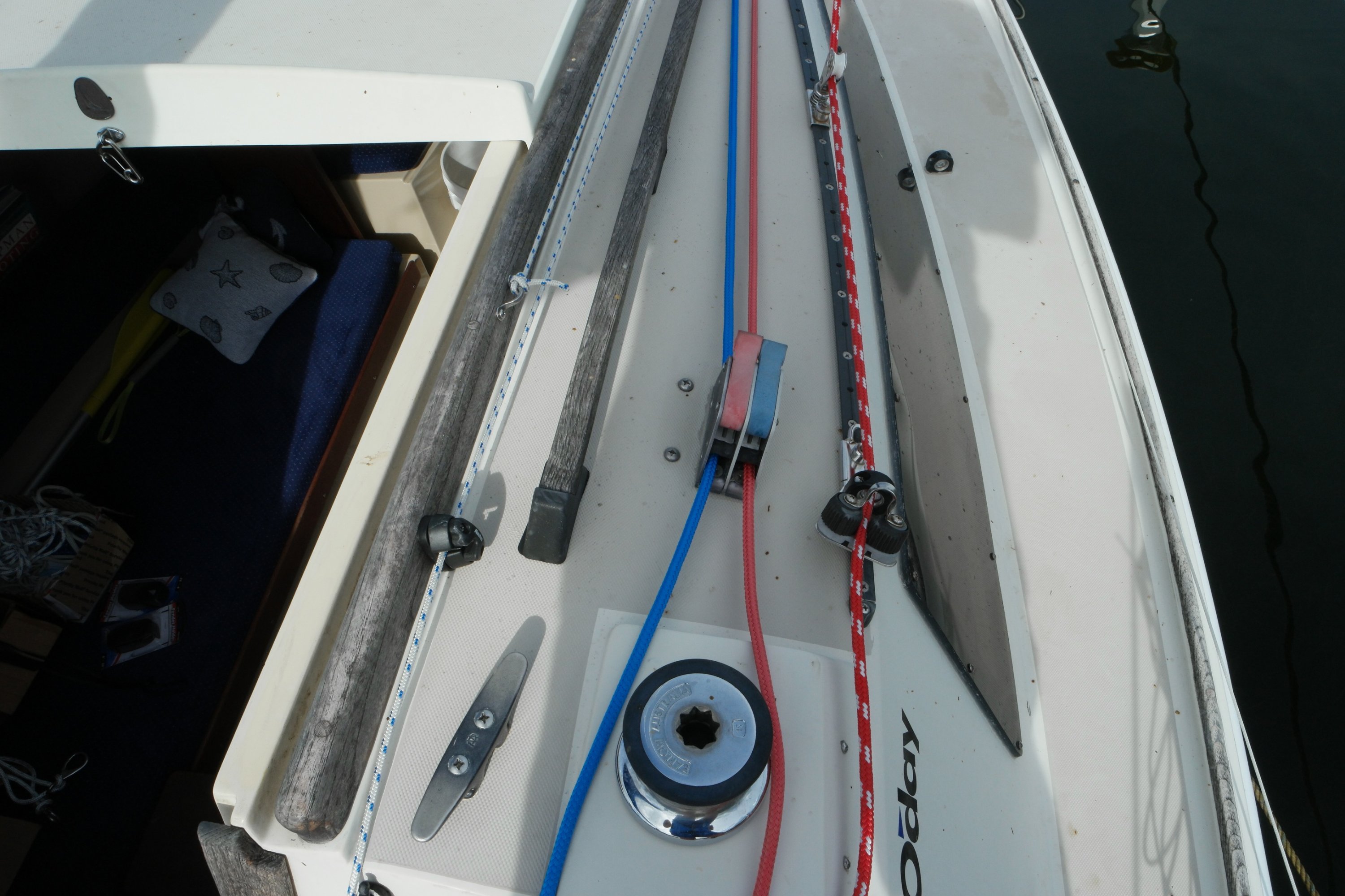

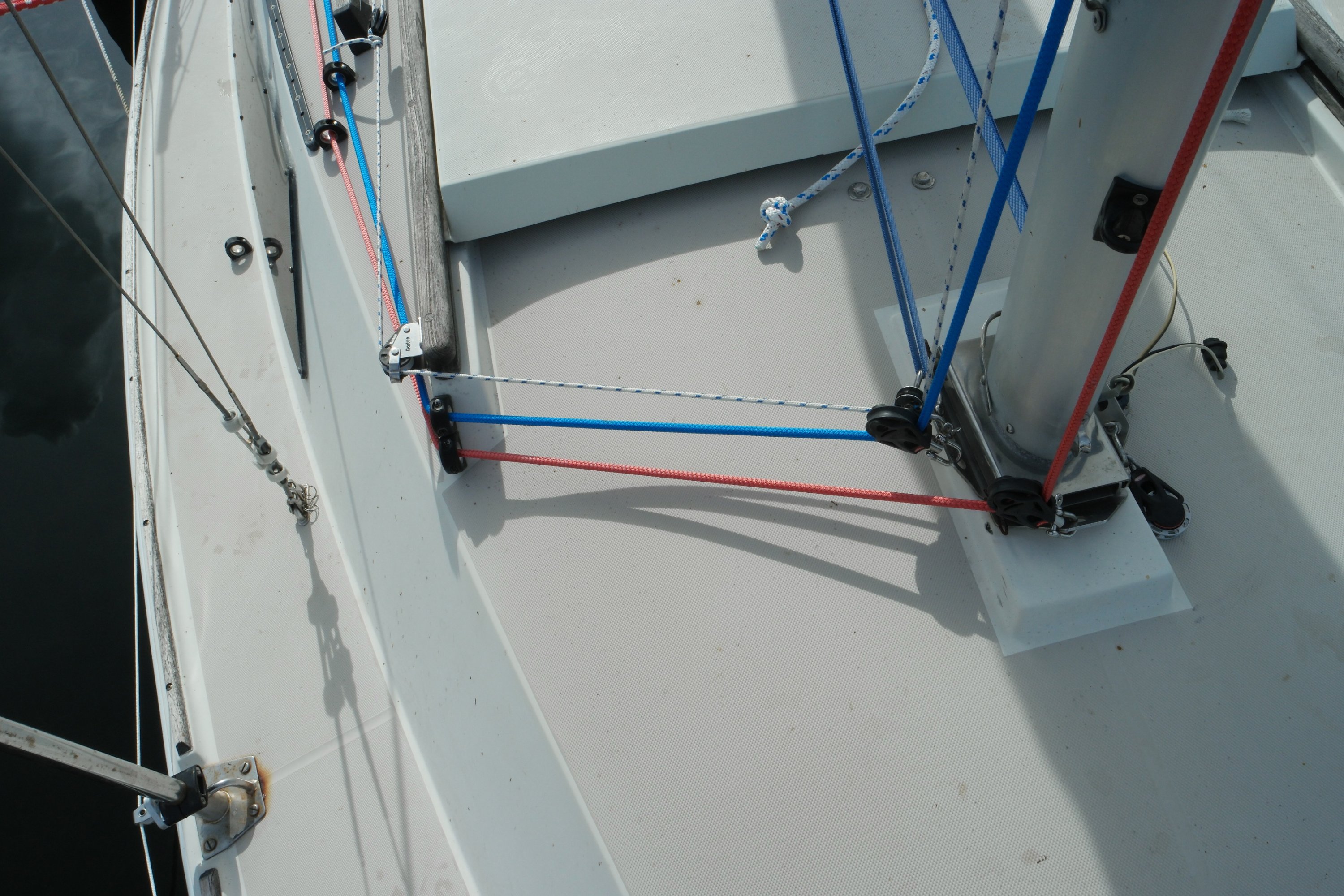

My 222 had the halyards run back to clutches by a previous owner, but I upgraded the blocks when I bought new lines and also added a topping lift and cam cleat. In the first picture the white line w/ blue flecks is the topping lift, blue line is main halyard, red is jib halyard, and red w/ white flecks is jib sheet.
