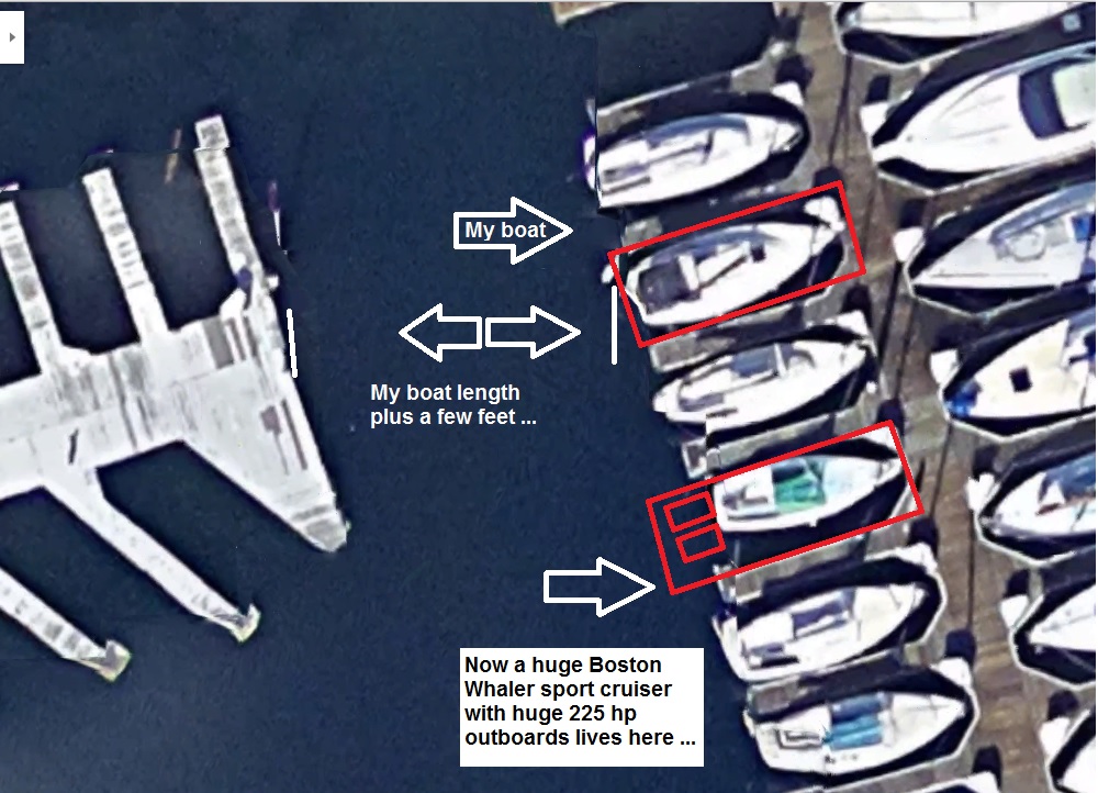

I usually have a harder time leaving the dock singlehanded; it seems like I always have wind on one or the other beam, or from one of the aft quarters. No current to worry about for the most part (being at the back of L.A. Harbor at least has that going for it), but it is VERY tight where our slip is located.
Our marina owner won't allow us to slip stern-to, so we have a pretty easy time coming in - personally my "return to slip" is always a solo endeavor regardless of crew situation, and is one of my strong suits in terms of boat handling - but it can be a devil to get out when it is windy, and during low water.
Unfortunately we have a lot to contend with as you can see.
ANY wind whatsoever used to intimidate me/us to the point of precluding any sailing. More recently (late last year), I finally said "f- it" and started to learn how to back out, stern turning toward starboard, and simply back down the short fairway (past the Whaler's massive overhanging outboards) and into the channel. I now lock the tiller amidships and use the outboard swivel (it's on a Garelick adjustable mount) to steer myself around while going in reverse.
It's not perfect, and perhaps less than totally seamanlike, but so far this has proven to be much more effective than trying to back out (start to swing stern to port), arrest backward momentum, and then try to gain way and steerage enough to turn to starboard and not hit the Whaler and/or other neighbors. We have had mixed success with that approach especially when it's windy.
At least the adjacent marina is derelict and we have no traffic to worry about back there. :)

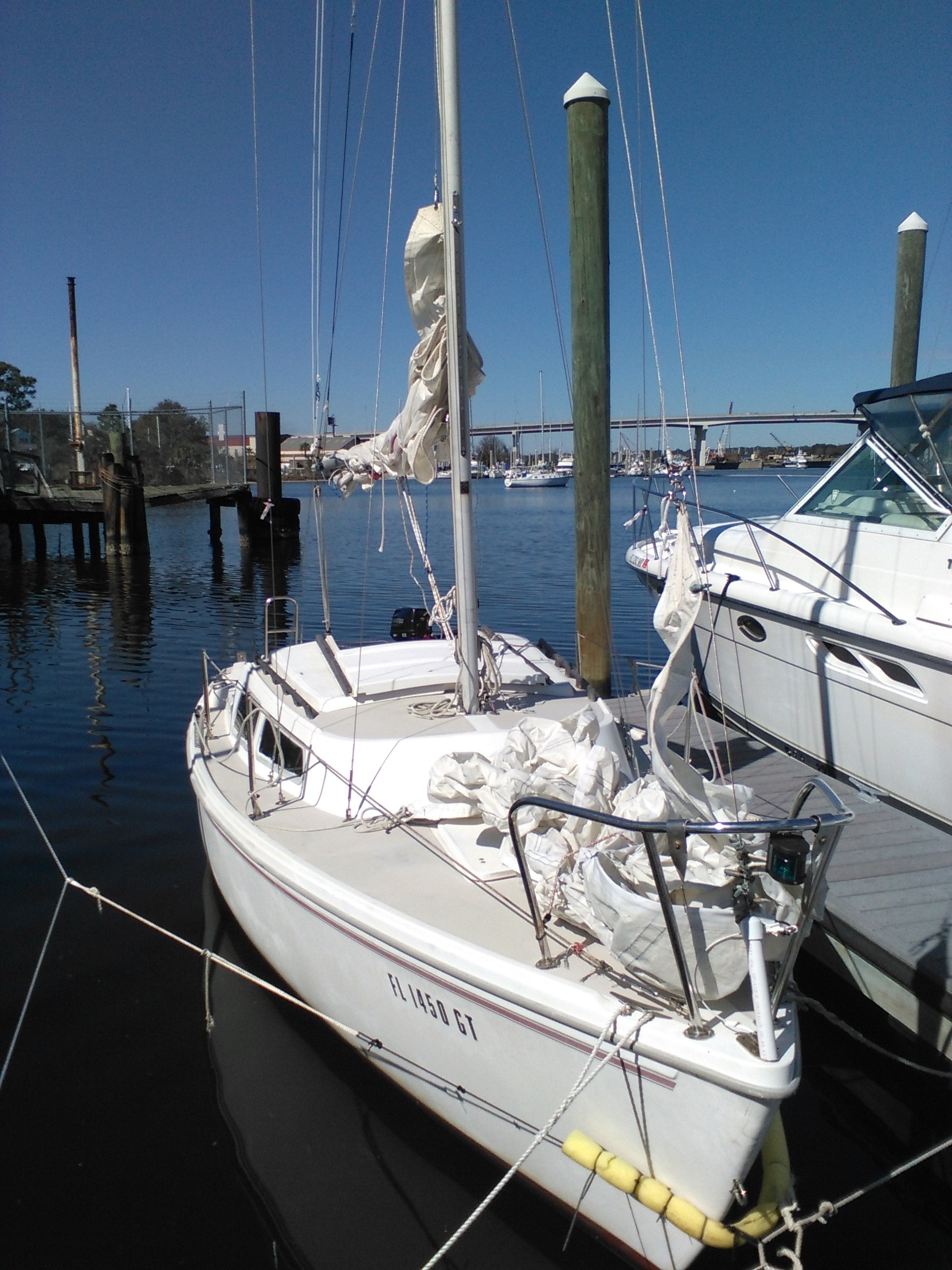

Try setting up a simple v capture device as shown in the pix below. You head in under minimum power, grab the stern line them go neutral, no big deal.
