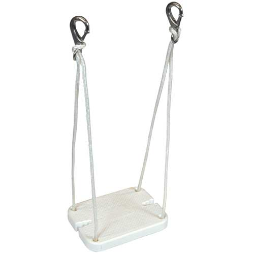

We need a nice looking, single step to get up from the dink onto the deck. We don't want to mar the hull, and the boat has teak toerails. Any suggestions for a step?

Here's what I use. Dinghy to the deck via the starboard life-line gate. Attach the snap hooks to the stanchions on either side of the gate. Not great, but good enough even when the boat/dinghy is pitching some. The fender step is probably better. West Marine for one vendor.

Thanks, KG, that's exactly what we have now! Only concern is scratching the painted topsides with the plastic, 'though I guess I could attach something.

when my kids out grew their Ikea swing seat, I gave it to a sailor friend put it to good use as single step broading step.

There is a 'sugar scoop' type transom with a boarding ladder. However, I have found that when it's not calm, there's too much movement at the transom to allow safe boarding. We generally approach and board with the dinghy about mid-ships, where the movement is least, hence, the need for a step.

Wow, so I had all winter to make the step that Rich made, and I didn't! The weather's lousy here today, so not going to the boat for the weekend. Will try for a day sail tomorrow. Maybe today I'll make that step! I have some 6x 4/4" (full inch) Mahogany decking.
I'm thinking of a more padded cushion that your leather piece, @Rich Stidger , and also maybe using Polartec instead of leather, 'cause the new boat is Awlgrip, and Polartec it the recommended covering material for fenders. Might put piece of garden hose on the edge and wrap it in Polartec.
