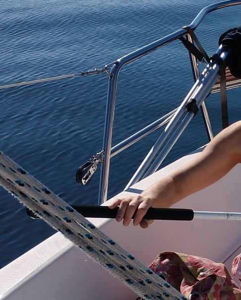

I have a hunter 240 that I picked up last July. It has been wonderful. We have it in a slip on Lake Lanier NE of Atlanta. A friend with a Catalina 25 gave me his old Jib. It is not really old; he replaced it with a roller furling jib. He thought that mine was a little small in light air. I sailed with it this week and it is great in 4 mph wind and very nice when running. The factory jib has about 70% of the area of the Catalina so I ran the sheets back to the spinnaker blocks which the previous owner had mounted on the sides of the stern railing. I had to run the sheets back to the stern mooring cleats to secure them. I don't know what the previous owner did with the spinnaker sheets.

Looking at sail controls (sheets on a jib) you want the sheet to stretch down to the hull at an angle that trims the sail leach/foot to optimize your performance. This generally means you need the first block along the hull rail forward of the cockpit. From there you turn sheet into the cockpit where it is most convenient to work the sail. For some boats that means a turning block (in your example you used the spinnaker block on the stern pulpit. The cleat serves to hold the sail while you attend to other boat needs. I agree with you. Not a convenient ease to use tool, even though it secures the sheet.
The proposed solution I suggest will have a similar flaw. Sure the cam cleat will secure the sheet, but the block will be nearly useless. It is too close to the cleat for the turning function you seek.
Additionally located behind the tiller is not good. You really need to see the sail as you adjust the trim.
