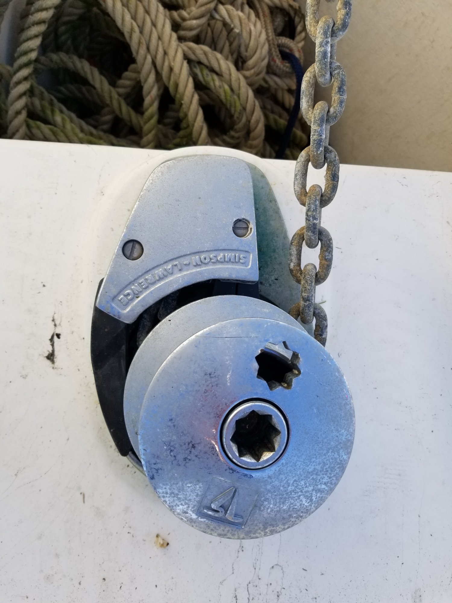

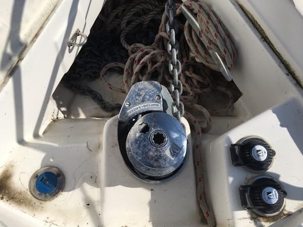

Tried operating the anchor windlass yesterday and when operating the switches it just made a clicking sound and would not reverse out any chain.
Motor seems to be stuck.
There is some corrosion on the bottom of the shaft.
I cannot find an owners manual for this windlass on the internet, (or on the boat!)
Can someone identify this windlass and point me in the direction of a manual so I can service this thing.
Thanks!
Mike

Looks like a Simpson Lawrence Sprint 1000 or 1500.

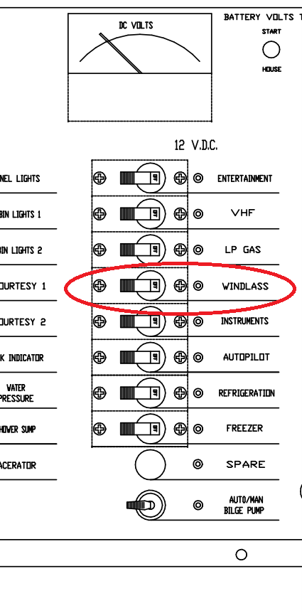

From the manual, it seems engine has to be running and there is a windlass motor breaker on the start battery switch panel (not the main DC panel) or wired in series from the start battery switch, you're looking for another breaker near the battery switches.
The breaker on the main DC panel (pictured above) is only for the foot switches.

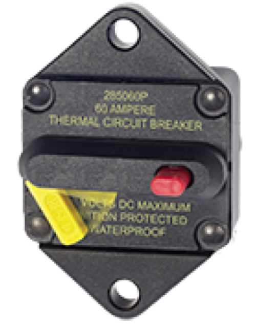

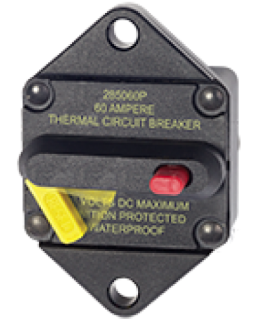

The windlass breaker is probably this type:

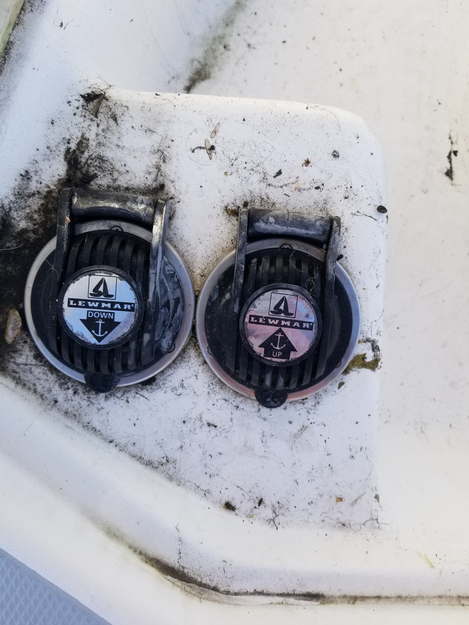

If you hear a clicking when you press the foot switch the circuit is energized. So I don't think it's the breaker. There may not be enough juice to run the motor or the motor could be seized.
As for connections I would look first at the connections on the bow and underneath the deck. That area gets plenty of spray and is exposed to rain - wind driven at times. I used to keep a plastic grocery bag on the windless to keep the rain off it. Someone on this forum @Rick486 suggested that because rain can get in there.

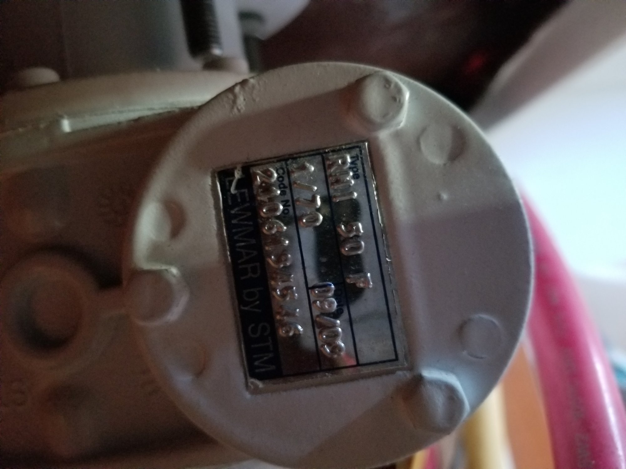

In addition to the possibility of a bad solenoid, I can tell you that the S-L windlasses have a french- made motor that is known for bad brushes.
If you find that the problem is failed brushes, the best solution is to replace the entire motor with a motor made in the UK. Contact slspares that was mentioned in a post above.

With the main DC panel windlass breaker ON, the windlass controller box would "click" when pressing the foot switches, but without the windlass motor breaker ON and the engine running to power the windlass motor, nothing would happen.

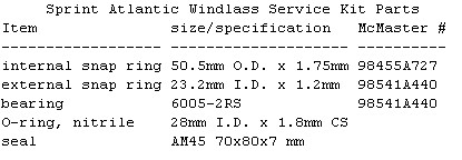

The rebuild kit for the Sprint Atlantic windlass is available from P2 Marine:
Sprint Atlantic Rebuild Kit
The parts in the kit are relatively common, the seal being somewhat difficult to find but nonetheless available. I was able to find the seal at MRO Supply. A screen capture of the parts is in the attached image.
Sourcing the parts individually would probably cost a third or so of the P2 Marine kit. For example, a two pack of the Timken 6005-2RS bearing is available on Amazon for less than $16 with free shipping. The seal at MRO supply is $8.35 (p/n 1469982) but you must buy two of them and shipping is free. The snap rings and O-ring may be found at a well-stocked local hardware store.
