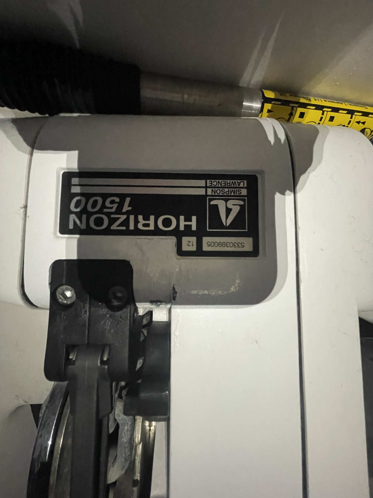

Hello all,
I have a S/L Horizon 1500 windlass on my 2000 Hunter 460. I need to purchase new chain but I am unsure of what type of gipsy I have. Can anyone look at the pictures I have included and give me a best guess? The gipsy has no markings that I can see without taking it off the windlass (yet). I currently have 100' 5/16" chain with 200' rode. I am unsure of the chain type because it is rusted. I'm looking to get 300' ACCO 3/8' Grade 43 (G4) hot dipped...
1,100
Most of the SL 1500 sold in NA had a gypsy spec'ed for 3/8" BBB chain. I'm not sure 3/8" Gr 43 will fit (longer links I think). Its not hard to remove the gypsy. Take it to your nearest chandler and trial fit it with the chain they have on hand.
