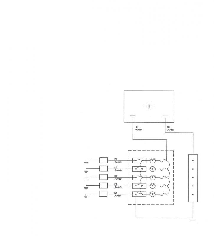

You don't want to wire it like that diag. with the one wire from the one side of the bottom switch to the neg. ground buss.. The Neg. grounds you show at the left need to go to the neg. buss and then back to the battery.
The Pos. should be fused near the battery,
Sum

Thanks Sumner, I'm drawing the diagram wrong, but my intention is to wire the negatives from each of the loads to the neg buss. I was using the ground symbol to indicate this. I thought ground in a two wire DC system was the negative battery terminal. To correct my drawing do I connect the negs from the loads to the neg buss and eliminate the wire I show comong from the neg buss?

Your schematic shows the bottom switch with two negative connections. Sumner's comment is that that is unnecessary.... even though it will work. Do you have a copy of "The 12 Volt Bible for Boats" by Miner Brotherton?

Your schematic shows the bottom switch with two negative connections. Sumner's comment is that that is unnecessary.... even though it will work...
Actually he has the bottom neg. wire before the load if those rectangular boxes represent the loads. We enjoyed lunch with you Joe and are finally back home. Took 3 days to get us and the Sub. from Phx. to Blanding (400 miles), not good. I'll pull the motor tomorrow :cry:.
... To correct my drawing do I connect the negs from the loads to the neg buss and eliminate the wire I show coming from the neg buss?
Yes, and it is usually assumed (at least when I draw a dia. for myself) that those grounds will go back to the neg. post on the battery, but to be clear for someone else I'd draw them back to the neg. buss and then to the battery for a boat application,

Given that the lights are inside of the switches makes a clear wiring schematic diffucult. If properly done, you'd have to show the neg going to feed the lamps themselves, as the neg is not "switched". I think it's easiest done to not show the neg panel feed where you have it, but stop short of the panel outline, put an arrow on the neg feed, and lable "To switch lamp neg chain". I think that would be a wrap.
As an aside, if I was concerned about loads, I'd make the pos feed attach to the pos daisy chain between the 3rd and 4th circuits- so there is, in effect, only three circuits drawing through whatever that daisy-chain wire size is.

....As an aside, if I was concerned about loads, I'd make the pos feed attach to the pos daisy chain between the 3rd and 4th circuits- so there is, in effect, only three circuits drawing through whatever that daisy-chain wire size is.
I agree and wouldn't daisy chain those circuits either unless that is actually a buss bar in the panel. I thought the things that look like lamps were the fuses in the panel and thought the rectangular boxes were the loads, but might be wrong,

the 12 gauge red wire is the pos bus for the control panel(only) adding another circuit will require an additional bus powered from the pos fuse as pic by Sumner. The black wire is only the neg lamp bus for the panel only) sorry about the sketch but this thread will be history by the time I can become agile with the draw program -- if I'm still sane:)
