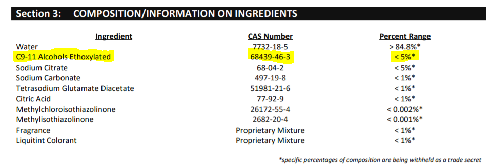

Just a FYI, from the MSDS provided on Simple Green, while the concentration is quite low, alcohols are deadly for acrylic. I imagine at this level of concentration, you can probably get away with using this but you should apply and rinse right away. Personally, I would never use any sort of cleaner containing any amount of alcohol on an acrylic.
Someone mentioned aluminum rims - sodium citrate, sodium carbonate and citric acid will all attack aluminum.
