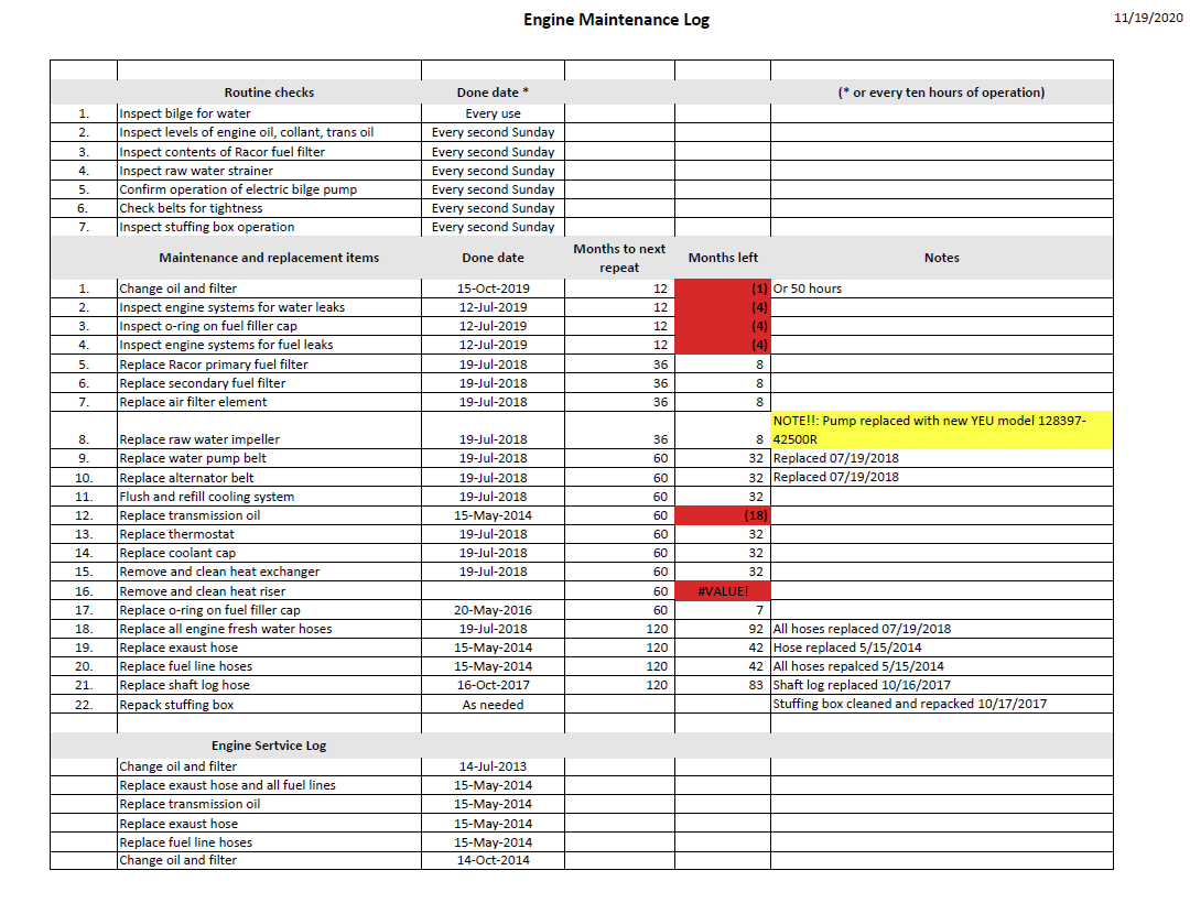

I have been using an Excel workbook as an engine maintenance log. Our sailing is seasonal coastal cruising so the simple form has worked for me. I share it in case it may be helpful to anyone who doesn't have something in use. I keep a print copy in the chart table so I can annotate as needed.
If anyone recognizes anything additional to track, please feel free to comment here. If you would like a copy of the spreadsheet you can find it here

Nice idea. We think alike. You really check those items every week?
I have one for all of my maintenance and improvements. I keep a separate sheet with part nos I used and the source.

The spreadsheet has a second workbook titled "Parts" with that information. I''m humbled to admit that I dont do the list EVERY week, I guess frequency can depend on your engine hour schedule. For our use, I'll change mine to say "Every second Sunday"

The schedule will work itself out. It's very handy to have something like this though. Certainly for resale. I had very little listed maintenance from Bella's previous owners. I am creating my own baseline by going thru everything. Some findings are eye openers.

Big fan of spreadsheets, so kudos. I use the Weems and Plath Maintenance Log, which I keep in the chart table and don't need a computer or power, but its just a personal preference.

Very nice. And good call to keep it in Google Drive. I do the same with my maintenance log so I can easily access it whether at home on a PC, on my phone on the boat, or wherever. It also provides good insurance against failed computers that Capta mentioned.

Sailfanatic - I like this, however, I'm missing where you keep track of the previous dates for oil and filter changes, etc. Not just the most recent entry. Are these logged somewhere?

I haven't used this spreadsheet for that purpose, but I think a history log is a sensible addition, as that information would pass thru the sheet, so it becomes easy to retain it. That history would make this log very useful when selling the boat. I've updated the workbook and put out a new version.
I also remembered to add an item regarding checking/replacing the o-ring on the fuel filler cap, lest you get water in the tank...

This is great! Any chance we could get an updated link?

Good list.
What sort of batteries do you have? Mine are FLA, so I would add check battery water levels monthly.

I dont know why the link broke, this should work. Download the file and open it in Excel, as Google Docs causes some format problems.
