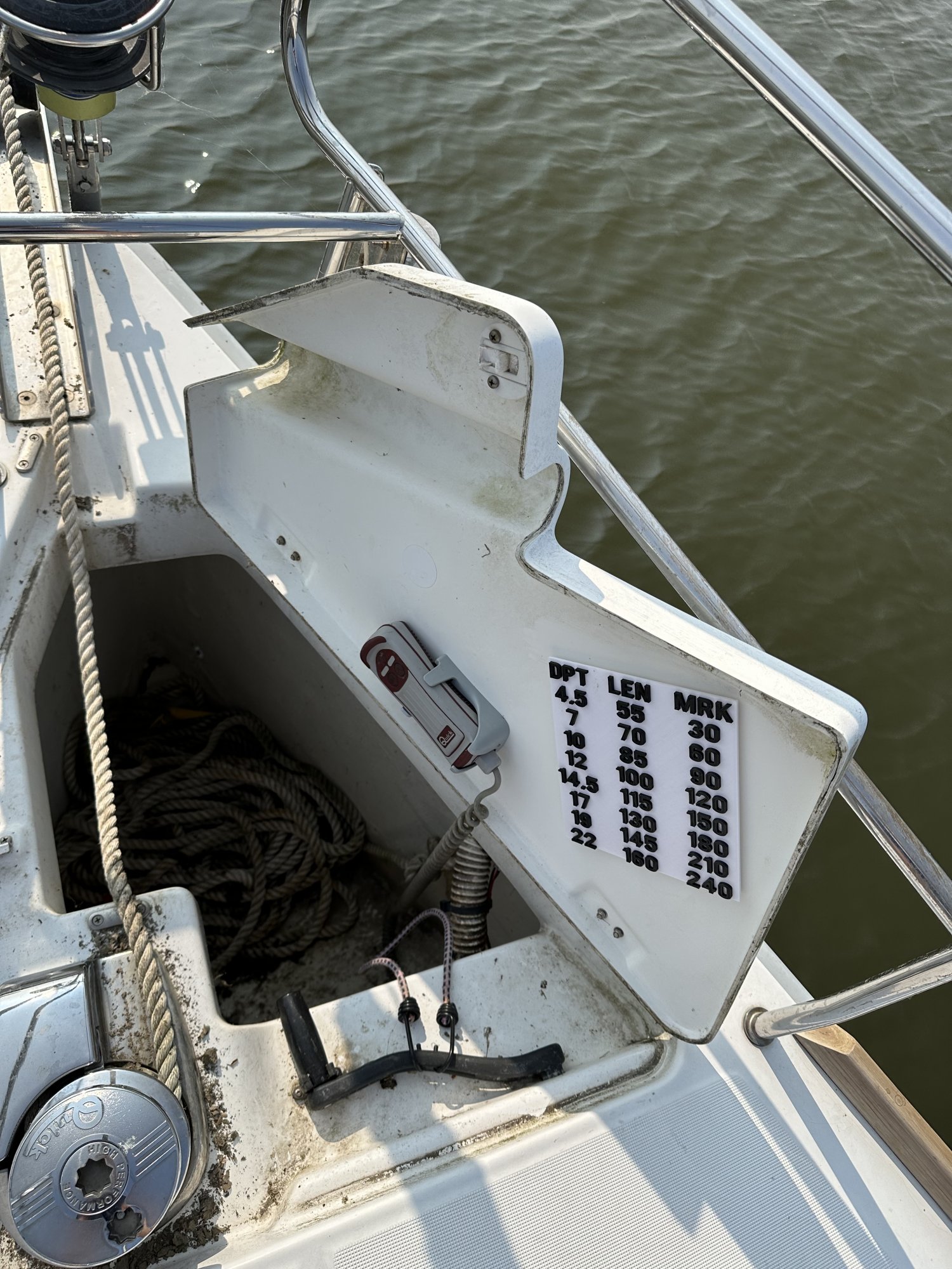

Where I anchor is usually pretty shallow- usually about 7’ or less. At those depths even 30’ of rode makes a big difference in scope, so I try to be more precise than that. At 6’ of water plus 4’ of freeboard 70’ of rode is plenty, but 40’ would be way too little and 100’ would be way too much. The plastic tags from Defender are marked in 30’ increments, which don’t really fit my usage. Instead I spaced them out closer, just knowing the numbers don’t match up. But then I need to do lots of math to go from depth shown on the sounder to true depth to depth + freeboard to appropriate scope to proper marker. The solution- I 3D printed a handy placard for the anchor locker to show the right marking to stop at depending on what the depth sounder shows.

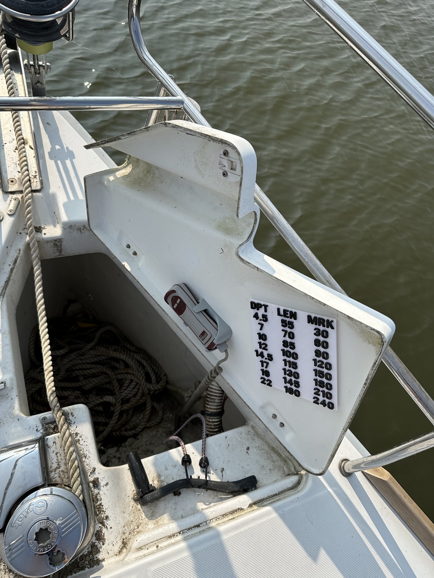

@Davidasailor26 So at say 10' plus 4' freeboard you'd put out rode to the 90' MRK. ( about a 6:1 scope). What is the significance of the values in the LEN column? Love this idea actually it's so simple!.

Almost - At say 10’ on my depth meter the true water depth is about 11’ (I don’t adjust the depth meter for the offset). With freeboard that’s about 15’, give or take. With a little less than 6:1 scope that gives me a target rode length of 85’ (the LEN column), and because of how I reused the plastic labels (every 15 feet after my chain) that means I should go out to the marker labeled 90.
The target lengths are rounded numbers and a little aggressive, meant to basically be minimum thresholds for tighter anchorages and calmer conditions. I just pad them a little if I’m going to be overnight in sportier conditions and have the space for it. The same placard approach could be adopted to be more conservative or aggressive depending on the skipper’s preference; I just like not needing to do the math when I’m running up to the bow.
Thanks @Davidasailor26 ahhh got it ...so the numbers on the markers are just because thats what comes with them rather than the depth. Makes sense now - thanks so much for this tip!
