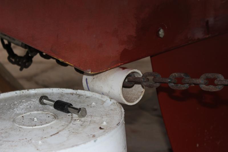

Just completed a 20 minute redo on my Montgomery 17 which has a 140# cast iron centerboard. Seems that no matter how carefully I lowered it when the stop nub on the board landed on the stop bolt in the cb housing there was a loud "clunk". I would imagine all sorts of accumulated damages from that 140#'s banging away on that 3/8 inch ss crosspin at the bottom of the cb housing. Finally pulled the pin and as I reinserted it I slipped a one inch length of 3/8 inch rubber, nylon reinforced fuel line on the bolt. Now when the board comes down it lands on that nice soft rubber with nary a sound. The force of its landing is now greatly mitigated.
This fix may work on other brands of boats as well.

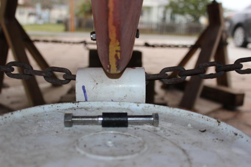

For those requiring the "thousand word" explanation aid here is a picture. Hopefully it will help.
The photo aligned with the keel of the boat shows the orientation of the pin in question. Picture the bolt running athwart ships in the cb housing with the black rubber sleeve inside the slot that contains the cast iron centerboard.
The second picture shows the actual keep stop bolt (the shiny stainless steel head shown surrounded with the red bottom painted cb housing) already installed in the keel.
