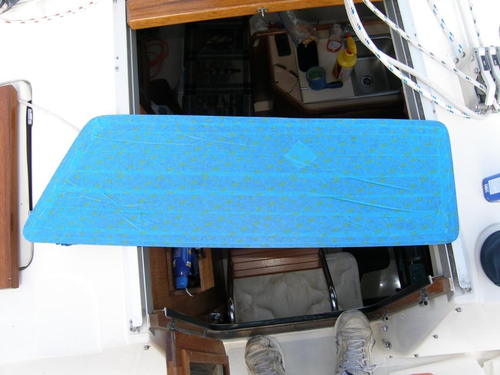

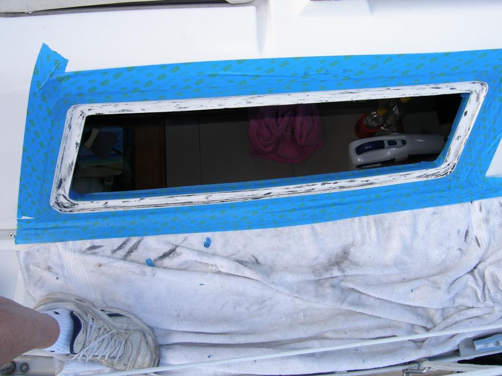

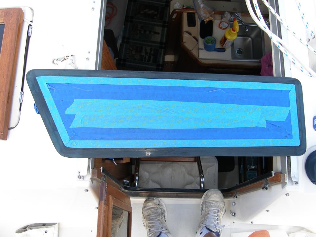

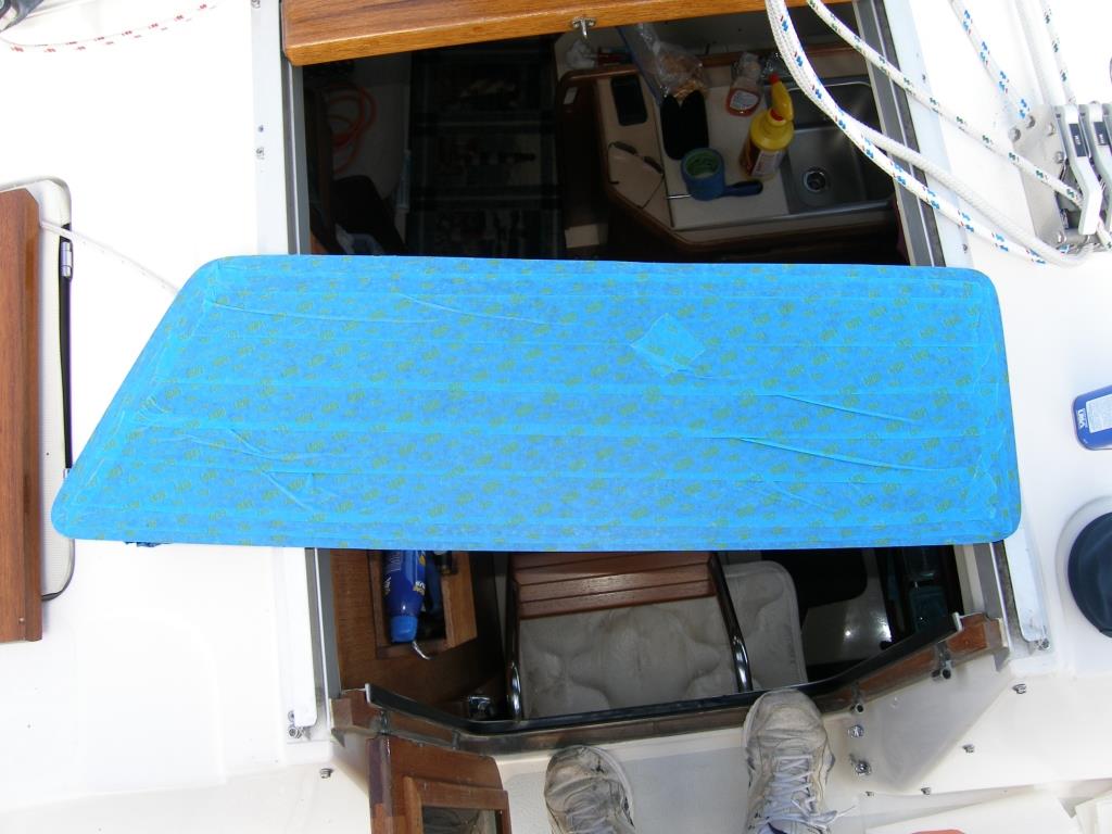

CD - I used some acrylic from the old dead lights (dark smoked color) and bonded them with a dab of epoxy. the fact they will be covered with a thin layer of 795 seems to make them unnoticeable from the outside. Maybe test first with a scrap piece. 795 is easy to work with, I agree. Smooth and creamy. But once you open it, don't be surprised to find it smeared on spots you were not even close to that day...;). Make sure to tape both sides of the gap (edge of dead light and edge of boat) around the opening (re posts 17 and 18), especially on the inside of the boat along the trim. I used the back of a plastic spoon to smooth the 795 on the surfaces and also used it on the gap. Left a nice even surface. You have to clean both sides of the tape pretty quickly, or pull the tape on either side of the gap before it set though!
