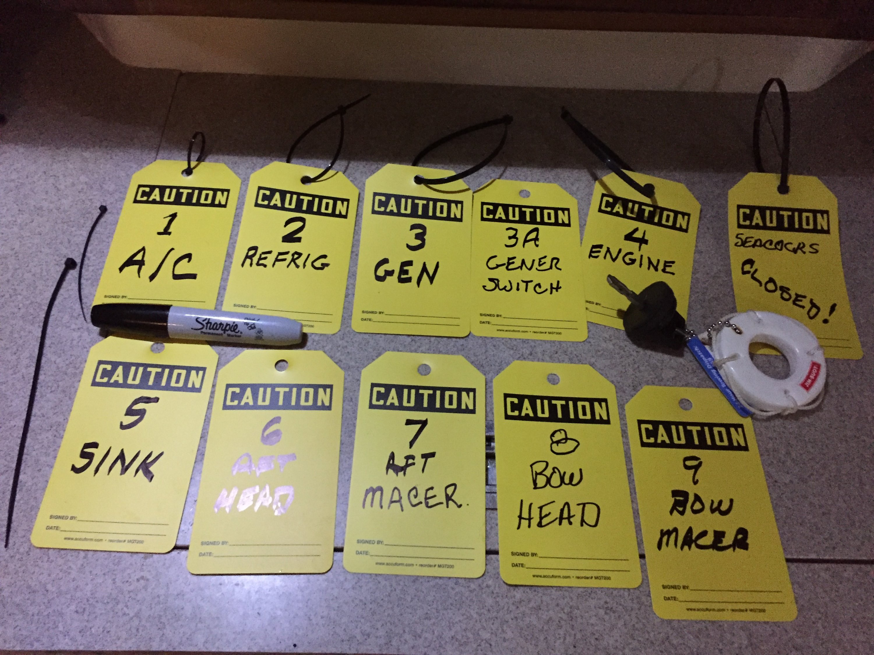

You hang a lock down/tag out on whatever disconnect you use to render the vessel's ignition inoperative. It goes to the the thru-hull valve when in operation, and back to the disconnect when you close the valve.
Very very good idea! I have 7 seacocks that will get seven numbered safety tags that all must be in their storage box before starting anything.:clap:
This is what I did for many years in the chemical industry to protect from loss of life/limb.
http://www.safetysign.com/custom-vinyl-tags
for my water proof tags to use soon.
I just finished implementing my seacock safety and reminder system I said I was going to do. My post#26 above.
Those are waterproof, no tear, tags in the link. My 9 seacocks are priority ordered based on safety/cost if not opened before leaving the berth ( both sides say same). Note the wire wrap seacock handle hangers, the indelible marker, my engine keys ( now stored on the seacock handle with the tag). The Admiral added 2 more good idea tags. Tag 3A that dangles in front of the genset start switch (no key) and the one under the key float, SEACOCKS CLOSED! tag that is in front of your face as you go below on the companion way.
We have a small tag sized box/lid with a map to the seacocks and index, for storage. All tags 1-5 must be returned to the box (after opening the valves) before you single up all lines. 6-9 are on a "as needed" basis.
When securing the boat, you take all tags from the box, close and tag each seacock, and double check that no tags are in the box. Go home and sleep peaceful about no unexpected flooding.
Jim...
PS: Admiral is very happy, but said my penmanship stunk! If anyone is interested I can show a homemade device to open and close those hard to reach seacocks with just a stick and a string.
