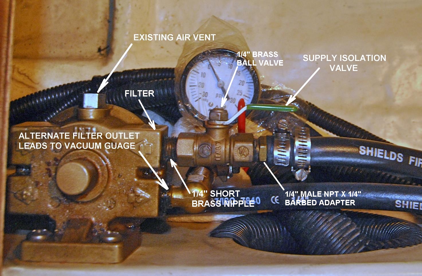

Something like this ................................. ?
Made from brass fittings bought from a commercial plumbing supplier. The black gunk on the threaded fittings is teflon tape with a thin application of Permatex 2 over the tape. Teflon tape by itself usually leaks.
Without a Racor model number it's kind of hard to tell what is leaking but my first suspicion would be the gasket if it's a Racor 110A.
If not the top gasket, try resealing all of the NPT fittings with teflon and Permatex 2 as previously mentioned.
