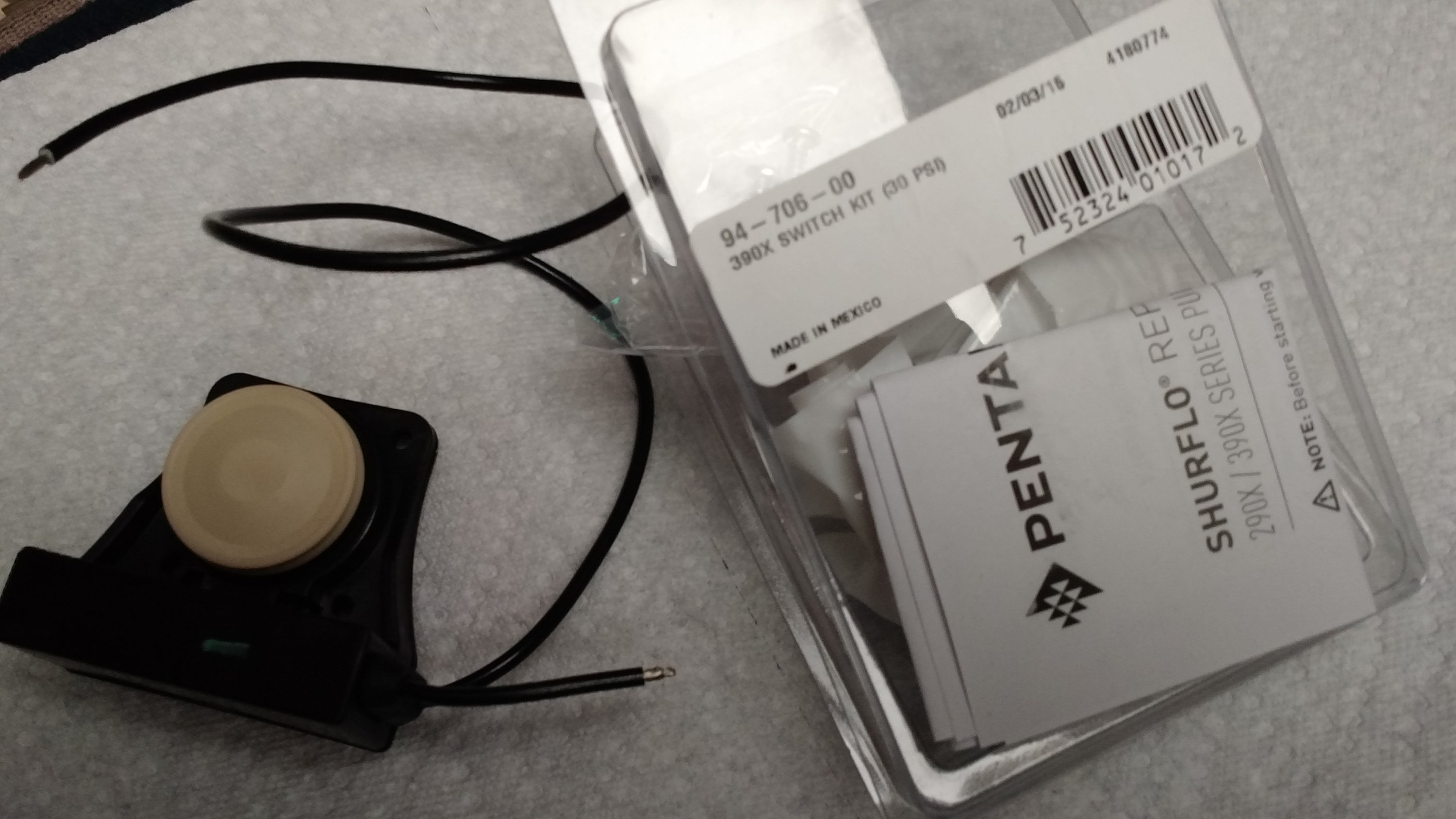

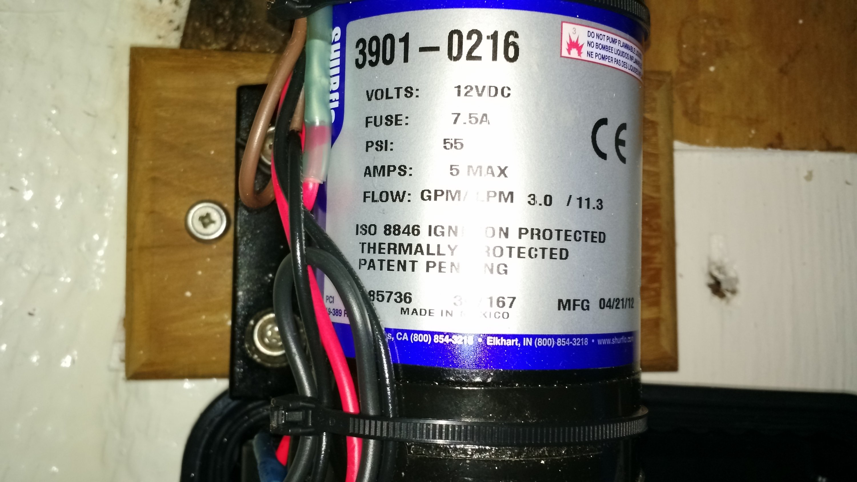

I have a SHURflo pump model 3901-0216 that I installed 28JUL2012. In August of 2015 it has developed a leak that appears to be coming from the diaphragm for the pressure switch. Since the since just the pressure switch diaphragm part was not available as a separate replacement part I replaced the pressure switch which come with a new diaphragm. Unfortunately it still leaks and I'm unsure why. It leaks whether the pump is running or not. I also removed the Upper housing to ensure it was clean (which it was). There is also a SHURflo strainer installed prior to the pressure pump which is clean.
I notice that no leaks are occurring between the Upper housing and the valve housing. There is an assumed to be required pin hole in the upper housing piece behind the pressure switch diaphragm - I assumes provides the pressure to activate the switch, and it is this diaphragm that does not seal.
