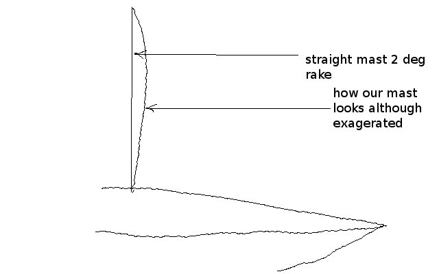

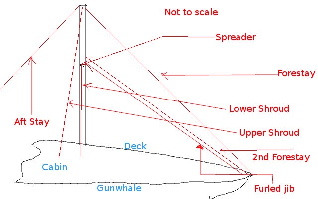

Ok so this is a new to us boat. We have never sailed it before nor seen it rigged for sailing. We have two sets of shrouds on her. One set the baby stays located just below the spreaders follow the mast down to the deck and then out to the outside of the cabin where the chain plate is. Note: these shrouds are inline to the mast or nearly so when looking from abeam. The mast head shrouds pass thru swept back spreaders and attach to chain plates about 20 something inches behind the chainplates for the baby stays. The mast has a bow in it that is impossible to get out with any type of adjustment to any of the standing rigging. The center of the bow appears to be at the attachment point of the baby stays. Ok today while sasha and I were looking at it, she gets on the deck and pulls back on the baby stays slightly and the mast comes straight. It seems to me as though for some unknown reason the PO moved the spreaders so they would sweep aft slightly and then moved the mast head shrouds aft and the baby stays forward where they attach to the chain plates. It appears as though most boats have the mast head shrouds attaching directly or nearly so opposite the mast on each side and the baby stays usually aft of this location. You can see the holes in the mast where we assume the spreaders were originally attached allowing them to basically come down opposite each side of the mast.
Any thoughts on this??? We have no information on rigging this boat and have not been able to fine any. Actually we are not even sure this is the original mast and boom.

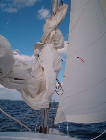

On another note. Yesterday we did finally get out of the inlet and into the ocean. Although it did have its moments. The channel is not properly marked on the charts used in OpenCPN ie CM-93 NOR on the paper chart issued by CHS here in Canada (this is the latest chart btw). We put the jib up and sailed about for a time. In coming back in the wind picked up and the jib was not powerful enough so we hoisted the main also. A puff of wind hit the jib and turned us abeam to the wind (about 25 knots) just as the main halyard was cleated off. The main filled and and we heeled way over (read I though ready for a knock down) but I managed to grab the main sheet and let the wind spill out and we came up right again. I did give me a good scare though. We did tack back and forth working our way back in and upon reaching the second set of buoys marking the inlet entrance dropped the sails and motored back in as it was getting late 7:00 PM or so.
