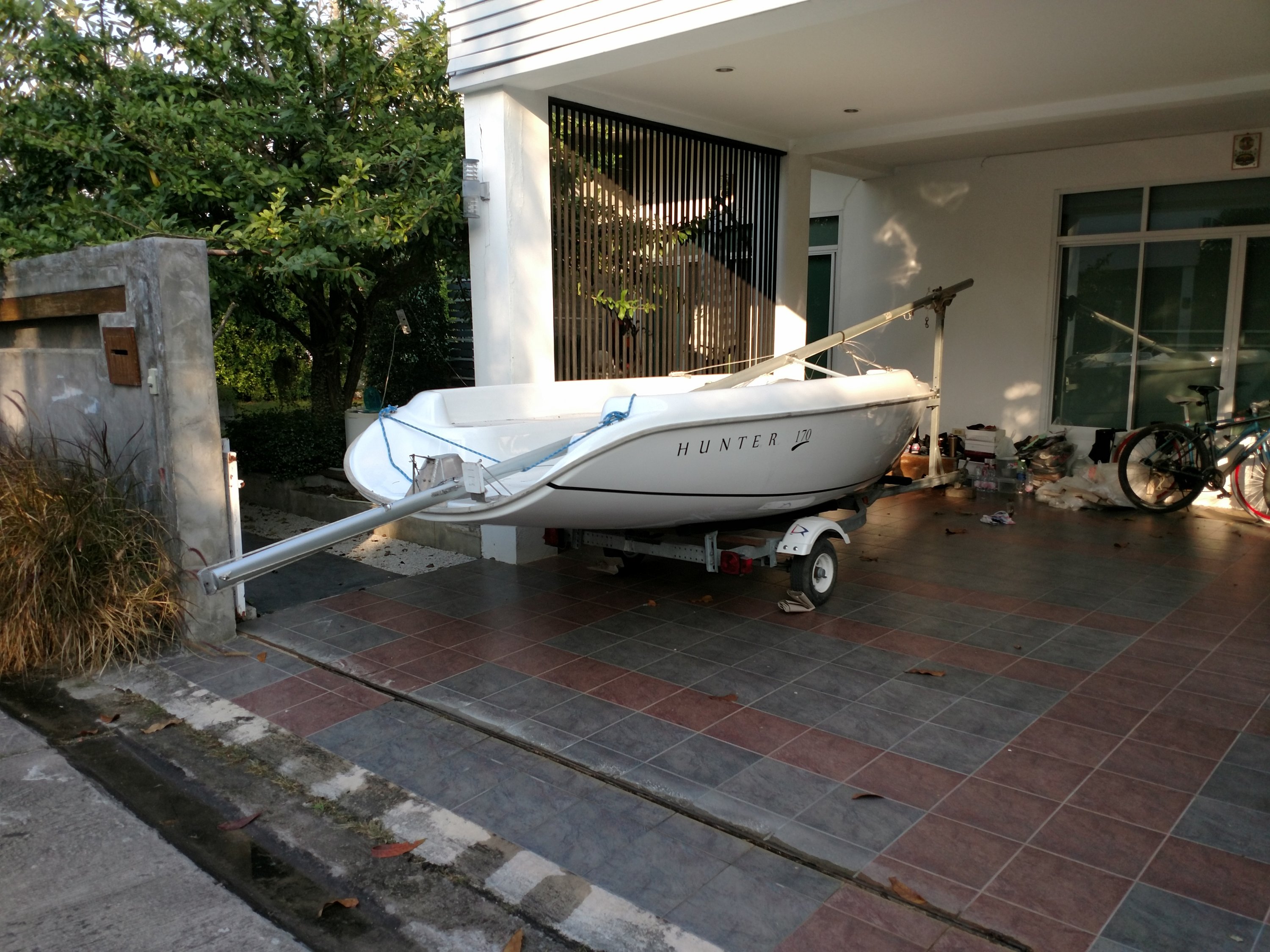

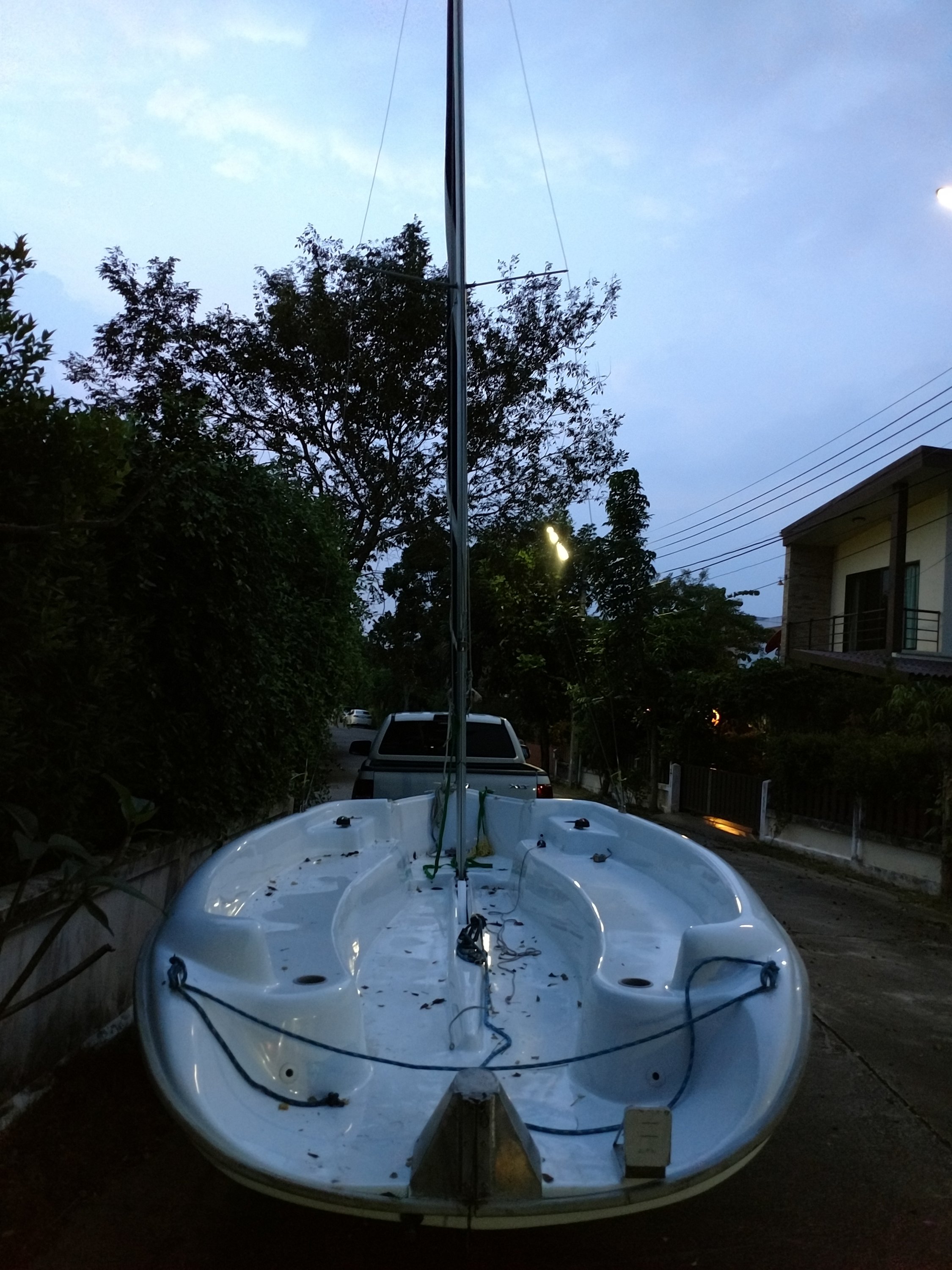

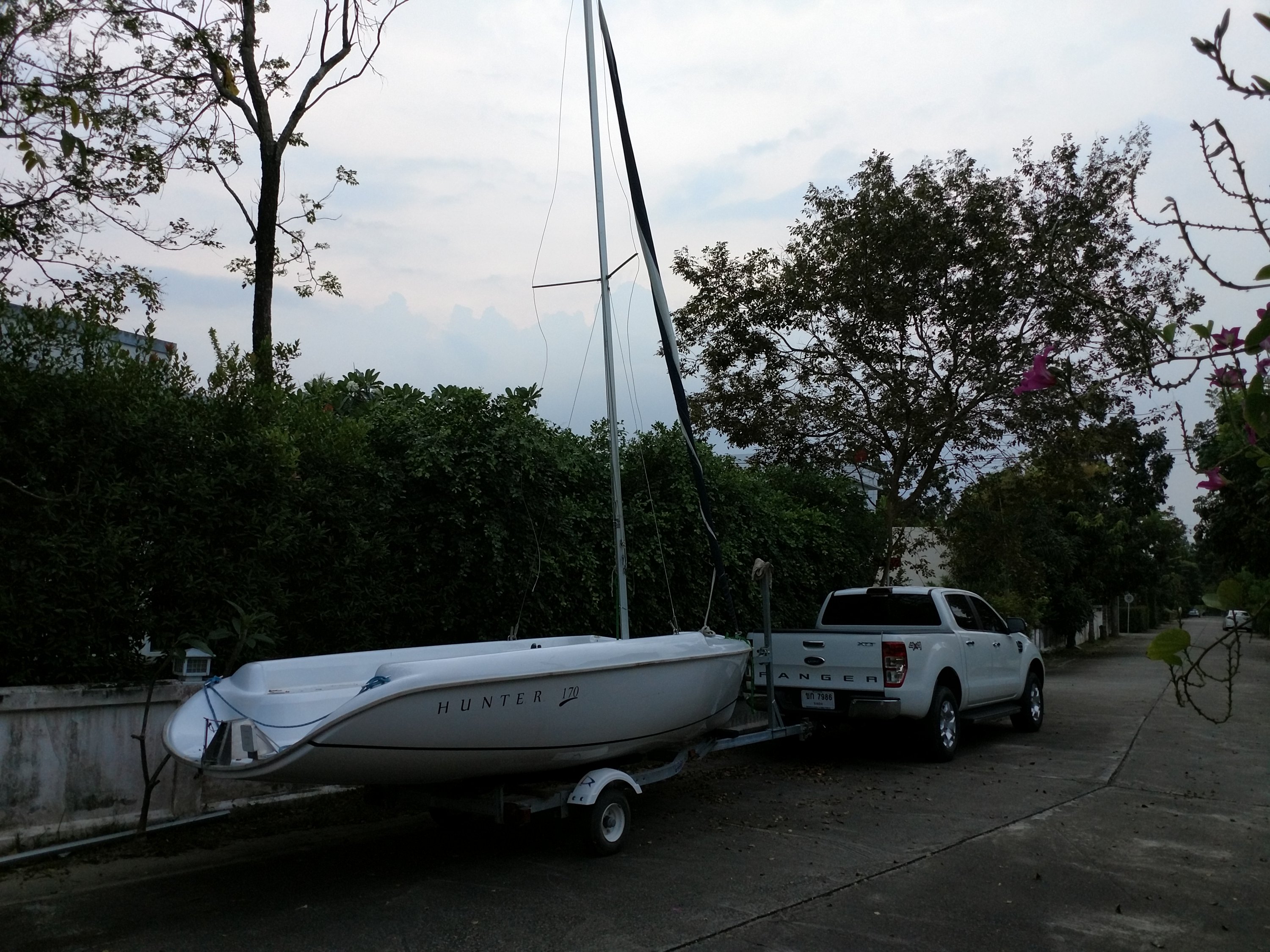

Just bought a H170. My first Hunter, and first boat built in ACP, though I have sailed JY15s many times. Had an Oday 240 in Connecticut for 6 season previously and have been sailing since I could walk. This particular boat was imported to Thailand where I live from I believe Utah. Has soft cockpit sole, which I will reinforce. Very 'interesting' repair to likely failed rudder gudgeon mount of formed and welded aluminum. Thai importer repainted the boat with what looks to be decent automotive paint, a bit scary, but here in Thailand there are VERY few sailboats as practically no one sails, so pickins were slim... (Also cost way more than I'd pay for a similar conditions boat in USA... Ah well)

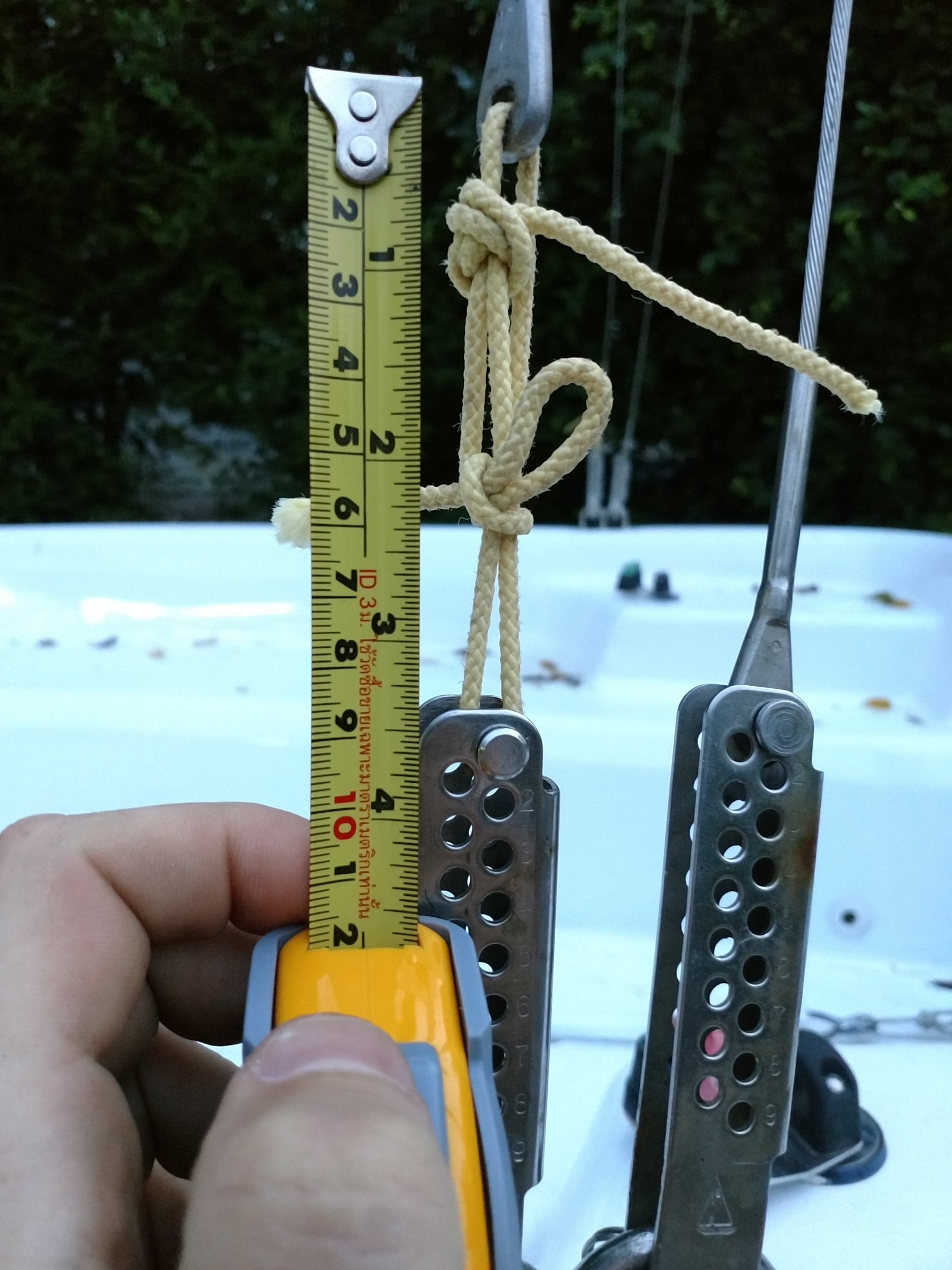

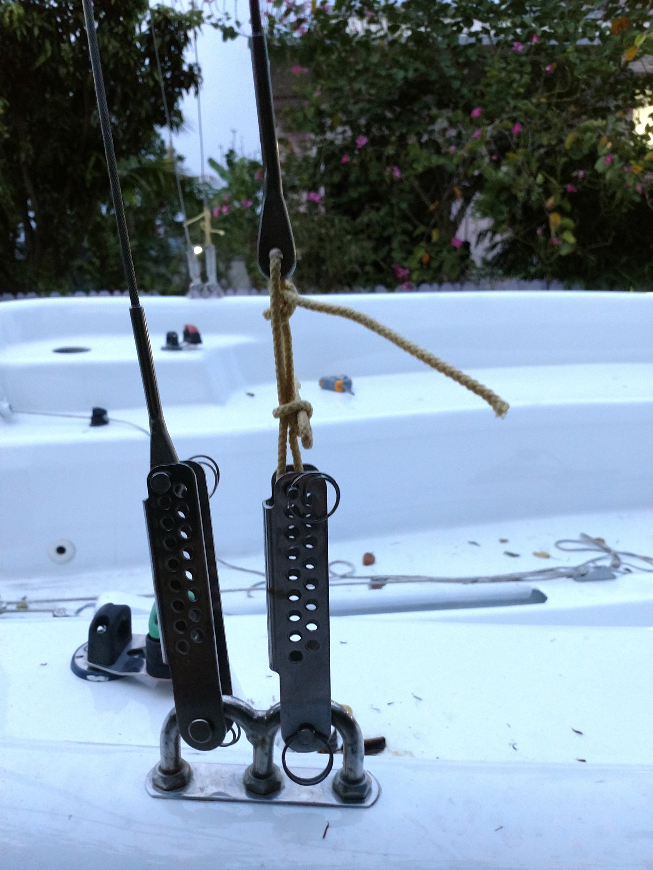

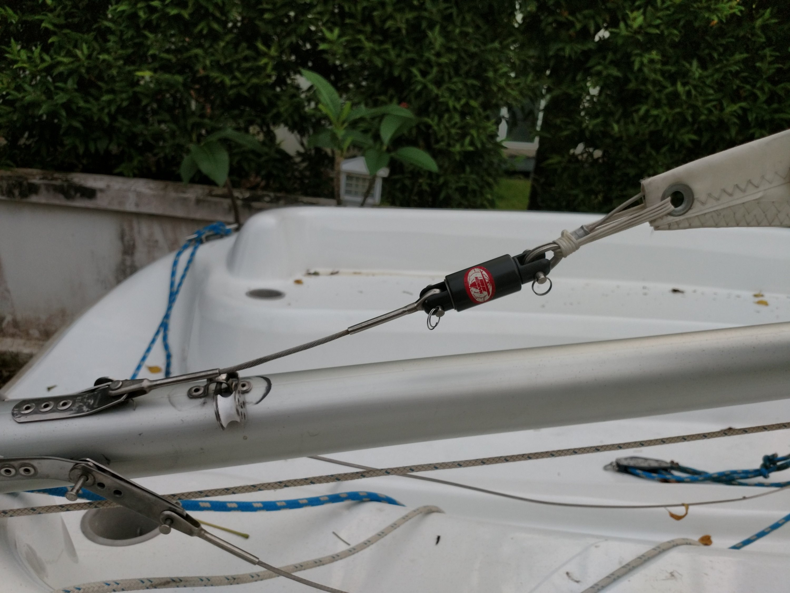

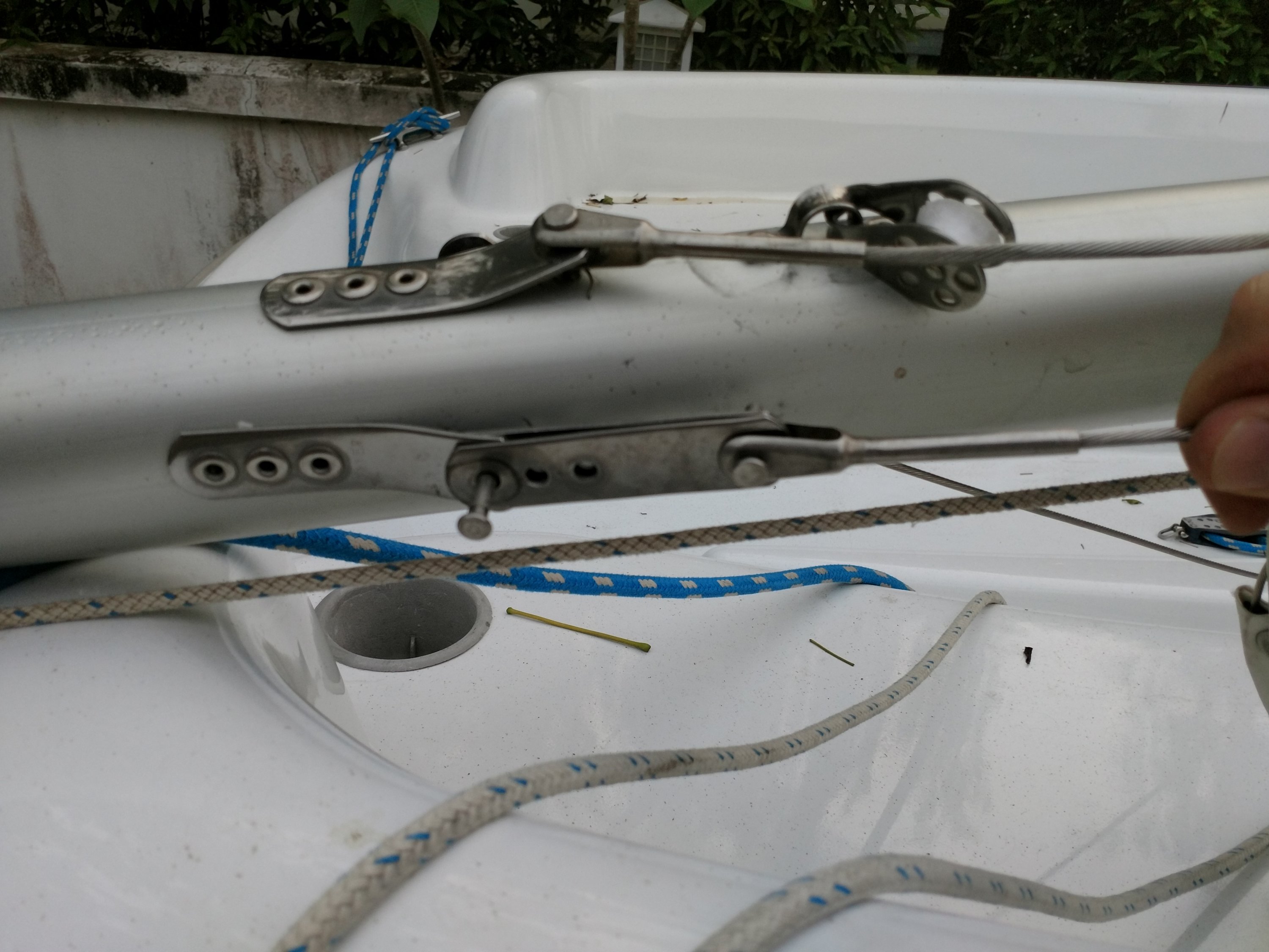

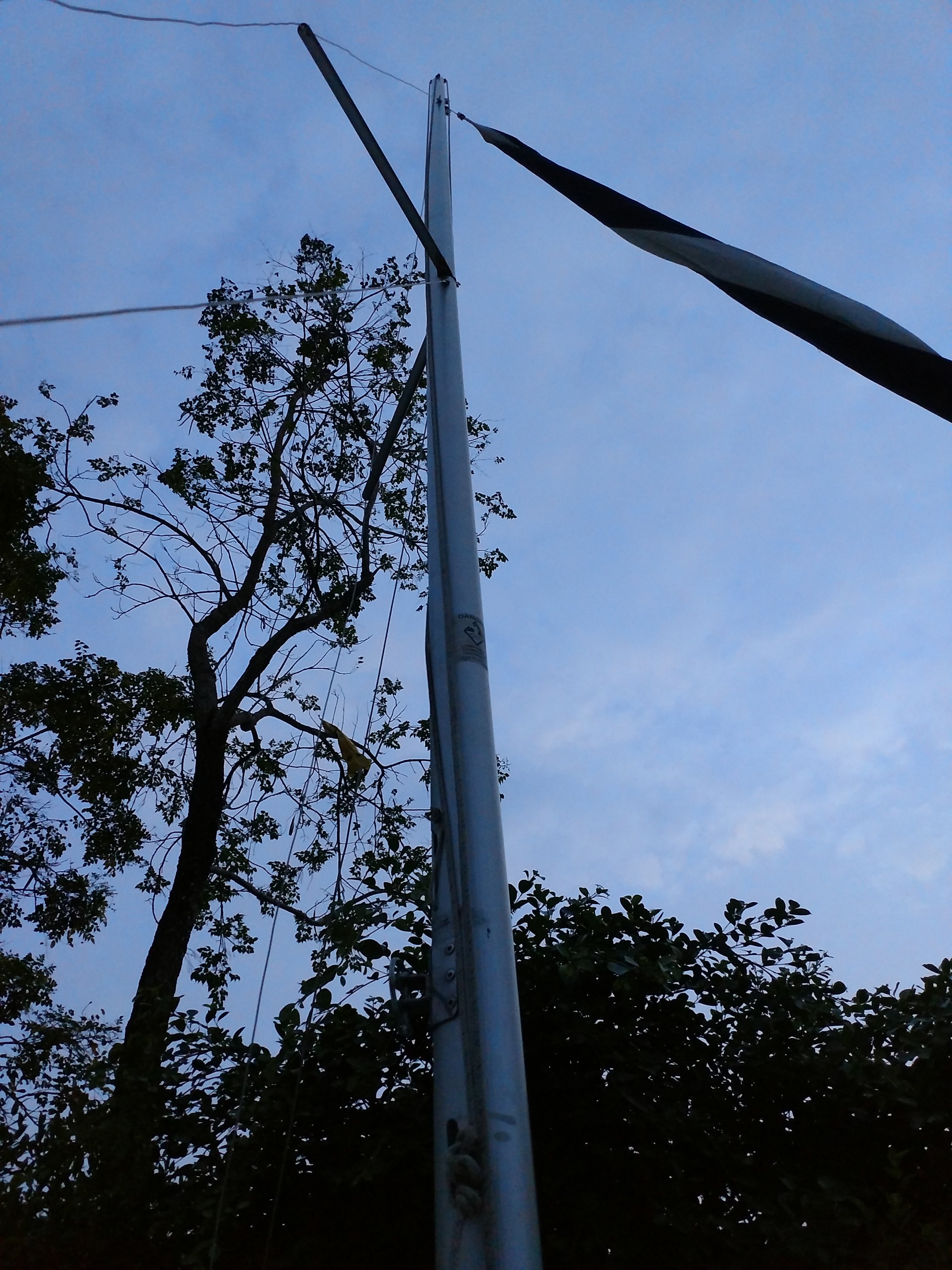

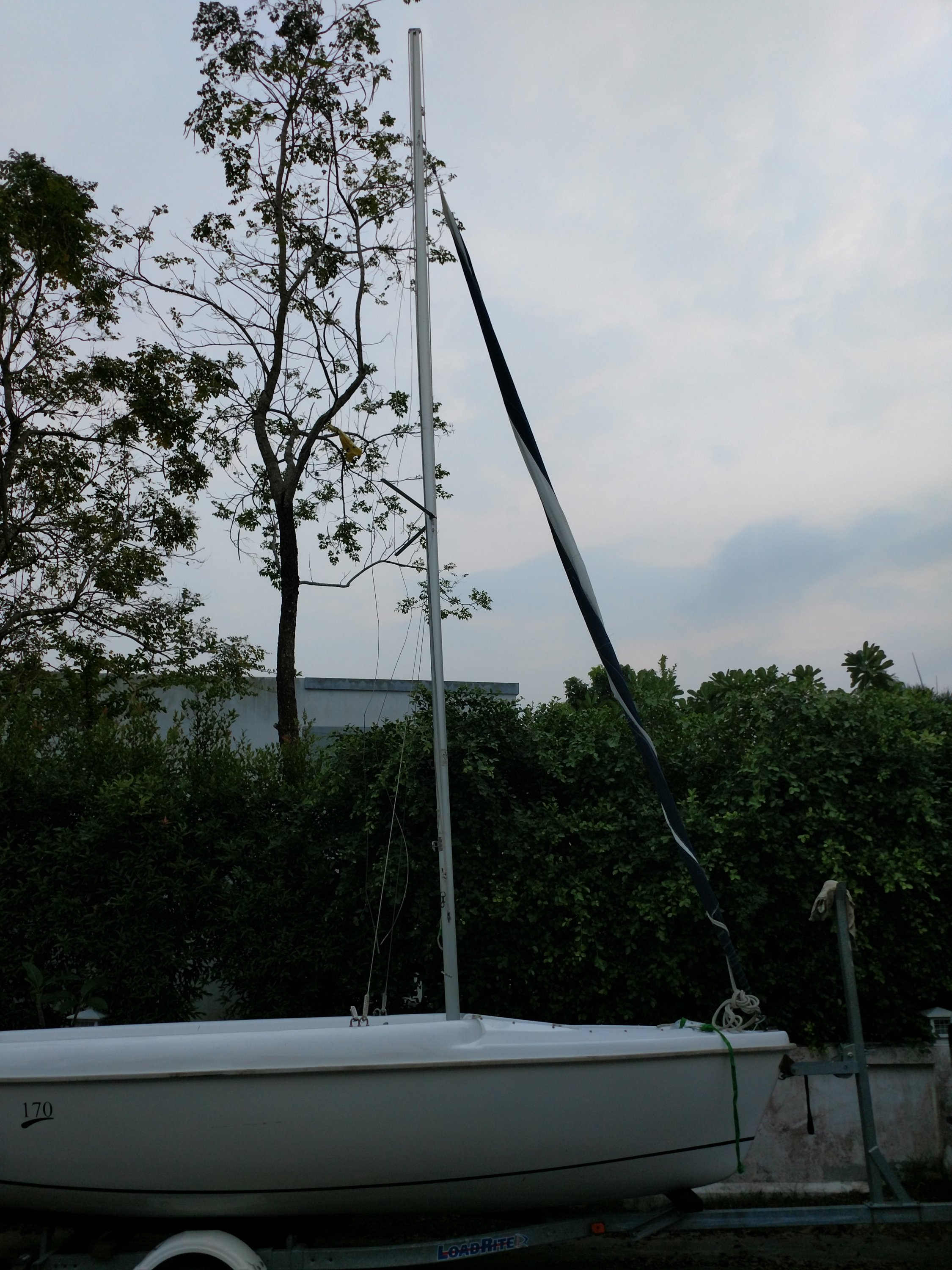

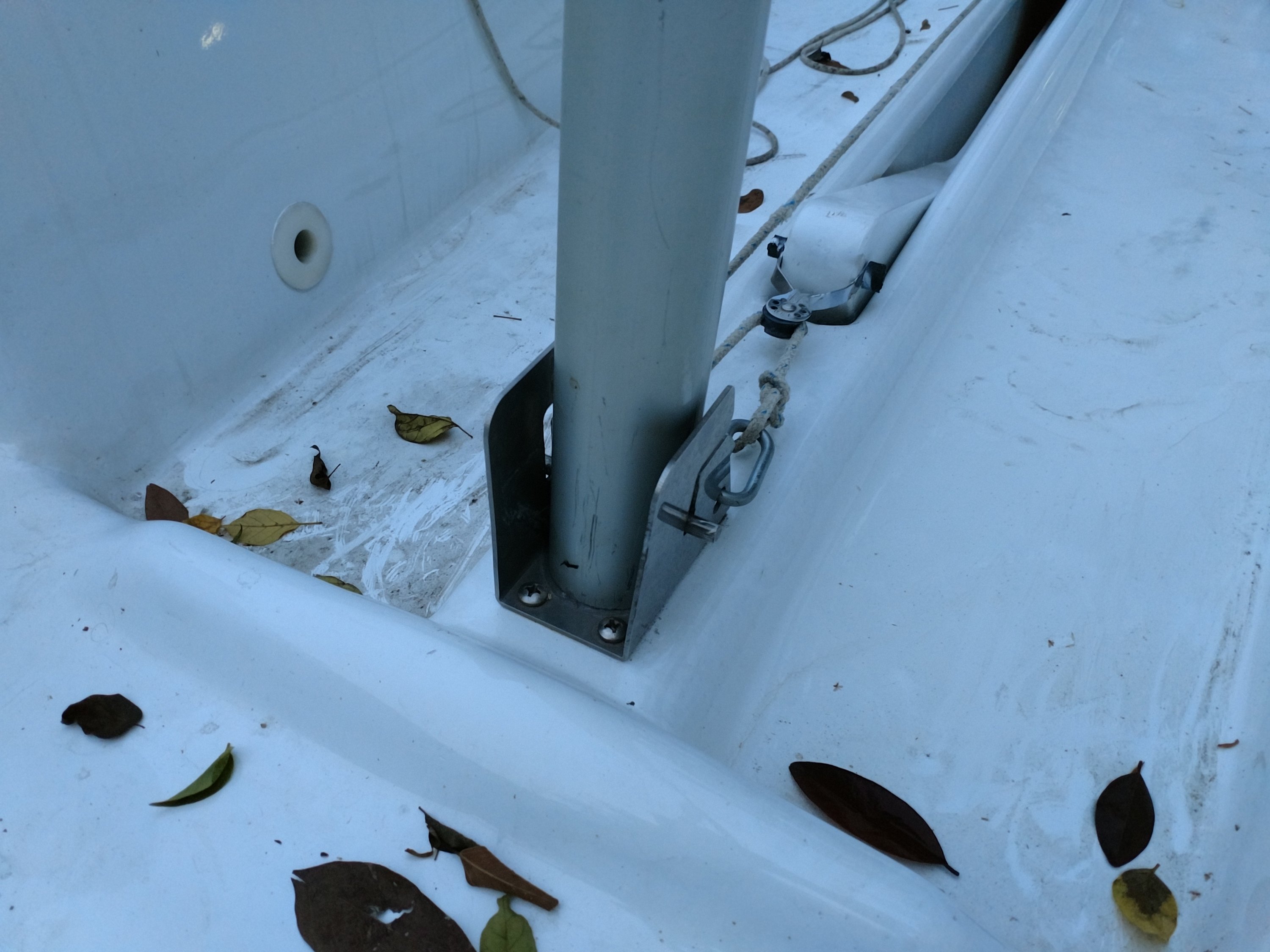

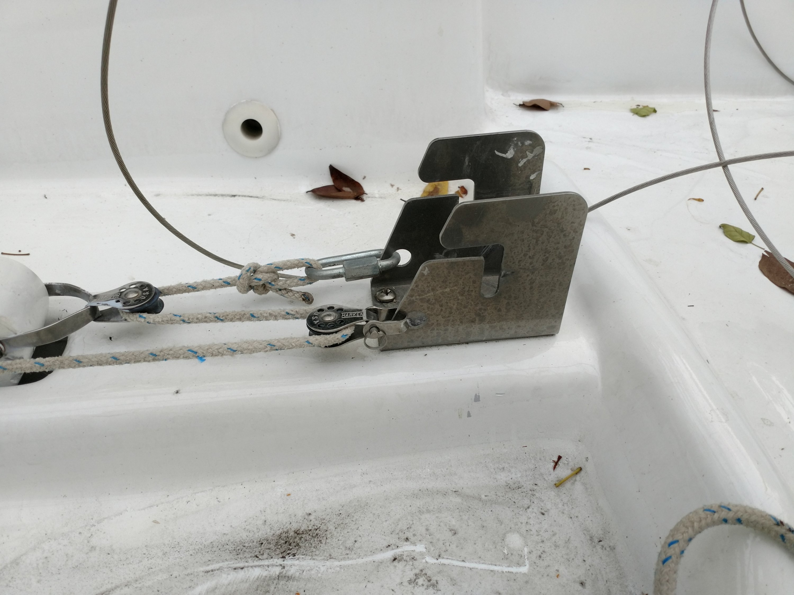

On to my question. The rig appears original. It is 23' 9” long, which another poster here confirmed a few years ago. The shrouds measure 5.6 meters (sorry for mixed units, we are metric here) exactly, which is correct per engineering drawings from Hunter. When we tested the boat out on Chao Phraya river in Bangkok, the seller had extended the shrouds with two stainless plates from Dwyer, but daisy chained them together. I thought they were just being lazy about getting enough rig tension, and the rig almost came down in a gust when the ring pins basically holding the whole thing up let go. Some excitement, but kept it under control and doused the main and sailed back under jib alone without folding the mast in half. I figured just needed to move shroud adjuster up several notches and it would be fine. No go, the whole setup is about 10cm/4" too short on each side, or I'd have to extend forestay and have serious mast rake.
Can anyone else confirm shroud length? 5.7m/18'8.4" seems like it would work. Any reason not to just try and get longer shrouds? Only thing I can think of that would cause this is mast somehow longer than originally, or gun'whale/chainplates somehow invisibly dropped down a lot. No evidence of that in the deck that I can see though.
