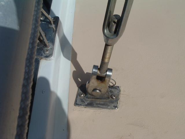

There are other solutions besides shroud covers which prevent you from keeping an eye on critical components. I don't even tape over cotter pins and, no blood on the decks.
Cotter pins are cut short so that they do not extend past the edge of the fitting the clevis pin goes in. The ends are filed and sanded round and smooth. After insertion in the clevis pin, the ends are each bent just 15 degrees. This avoids bending them enough to weaken the metal so they might break off and fall off. It also eliminates the need to bend them fully around into hooks that grab lines and flesh.
Go to a welding supply house and spend about 20 bucks for a bundle of 316 stainless steel welding rod. After the rig is tuned, bend "]" shaped pieces the length between the holes in the screw ends of the turnbuckles. Stick the pieces through and bend the ends around inside the turnbuckle body.

Jorge, there may be some confusion here. David's comments relate to those white split covers that some use over their shrouds. These cover the wire itself above the covers that you are asking about. Almost like your lifelines except these are split. My boat had both wire covers and turnbuckle covers when I bought her. I stripped those off to find corroding wire. Not damaged just the beginning of what looked like rust. Then the first time I had the shrouds loose I took off the turnbuckle covers. I also use the cotter rings, one on the chainplate pin and one on the upper turnbuckle.
