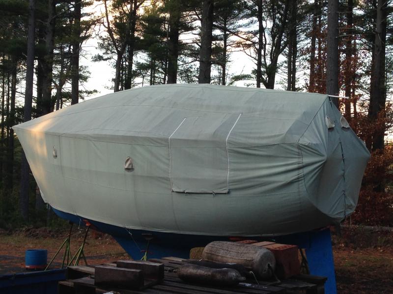

you cover your rudder? did you make it? do you mind me asking why?
My boat sits in back of my shop and there are pine trees which contribute to dirt building up. Just took this pic
