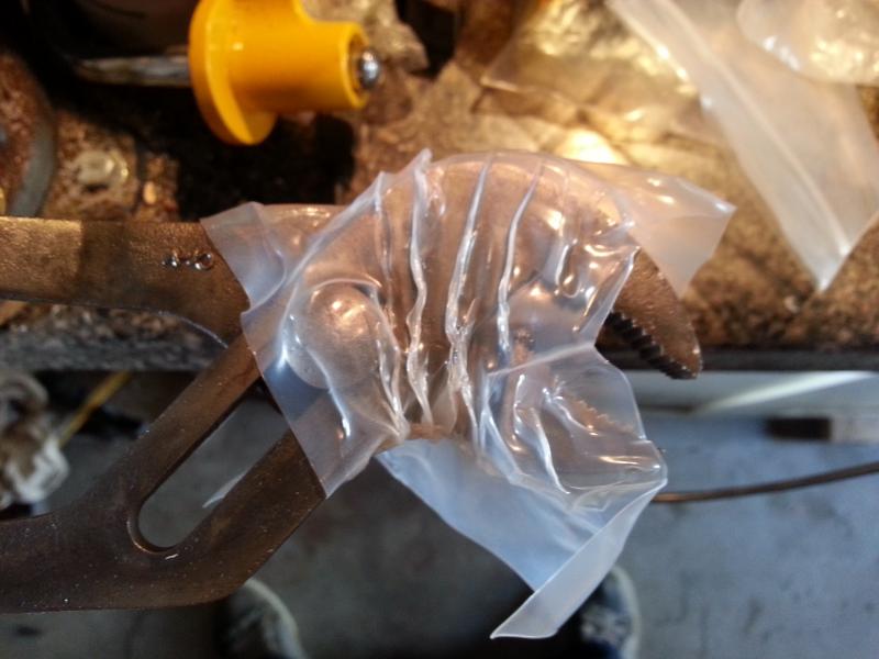

I had the idea of wrapping one of my boats this year. I don't want to pay $14/ foot so I was thinking of using 6 mill vapor barrier poly.
I tried a little test on a set of pliers in a vice on the bench and it didn't go as I had hoped.
So Is ther a off the shelf plastic that one can use to wrap there own boat out there? (Other than buying a roll of the real stuff.)
Here is how the pliers turned out with the 6 mill... It shrunk but not like I wanted it to. (Am I missing something simple?)

6 mil Poly film it is not shrinkable. To have the shrink wrap effect, you have to use shrink film.

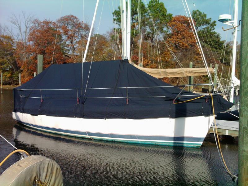

While the up front costs are high, around $3K a custom fitted canvas cover with a frame is the way to go. Especially in northern areas, you can start working on the boat in March, by April you'll be in shirt sleeves while everyone around you is bundled up.
I've had 2 covers made by 2 different companies, Custom Canvass in Niagara Falls and Fairclough in Connecticut. Different approaches, both work.
With care, the covers can last 10 years or more. In the long run cheaper than shrink wrap and way less plastic waste.
Unfortunately it is probably too late in the season to order one for this year. Fairclough typically offers a substantial discount if you order in late winter for fall delivery.

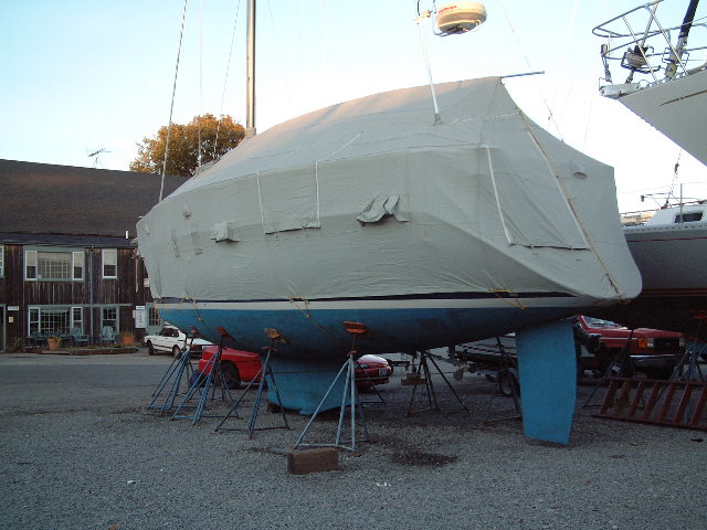

Ditto on the custom cover. If you plan on keeping your boat for a while, the savings will more than offset the cost of shrink wrap. I had a cover made by Fairclough in Essex, CT and I have just installed it for the 17th season. I have a 40 foot sailboat and the cover cost about $4K in 1998. Shrink wrap for my friends 44 foot boat is about $1K each year, mine would be a little bit less. So I had about a 5 year payback and now have $10K+ in my pocket.
I don't know of any other plastic that will hold up to winter snow loads like real shrink-wrap.

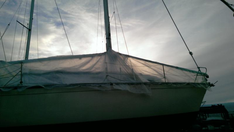

Is there an advantage to shrink wrapping over a properly installed poly tarp? At least the tarp would allow some air circulation.

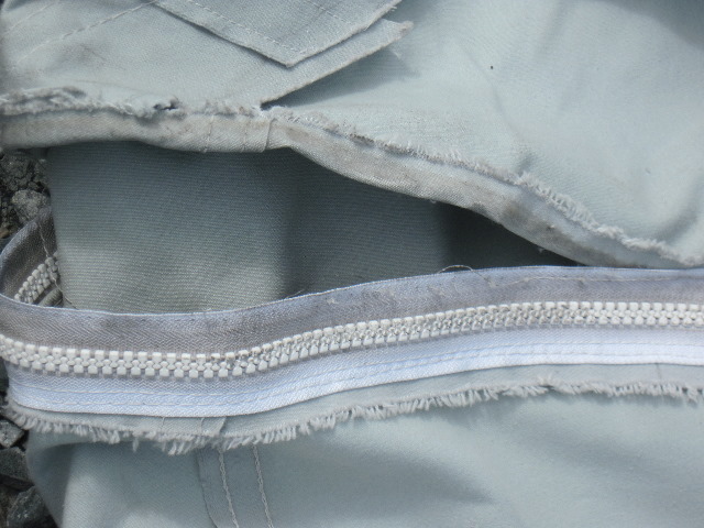

I must confess- the picture I posted was the best photo I have of the cover but it was taken in 2003, 11 years ago. However, the cover really looks the same today as then. Yes it is a bit dirtier, but really not bad. And I have had additional zippers added to accommodate my wind generator that is not shown in this picture. I have also added a few small patches and I have restitched a couple zippers. With some continued annual care I expect this cover to last another 5+ years. For instance, after the cover comes off in 2015, I plan to restitch all the zippers as I have experienced thread failure at the zippers for the last 2 years. I have also started adding a second string of the wood strips to take more snow load with less strain on the cover itself.
Below is a picture of one zipper that I re-stitched this fall and a current picture of my cover from a week ago.
