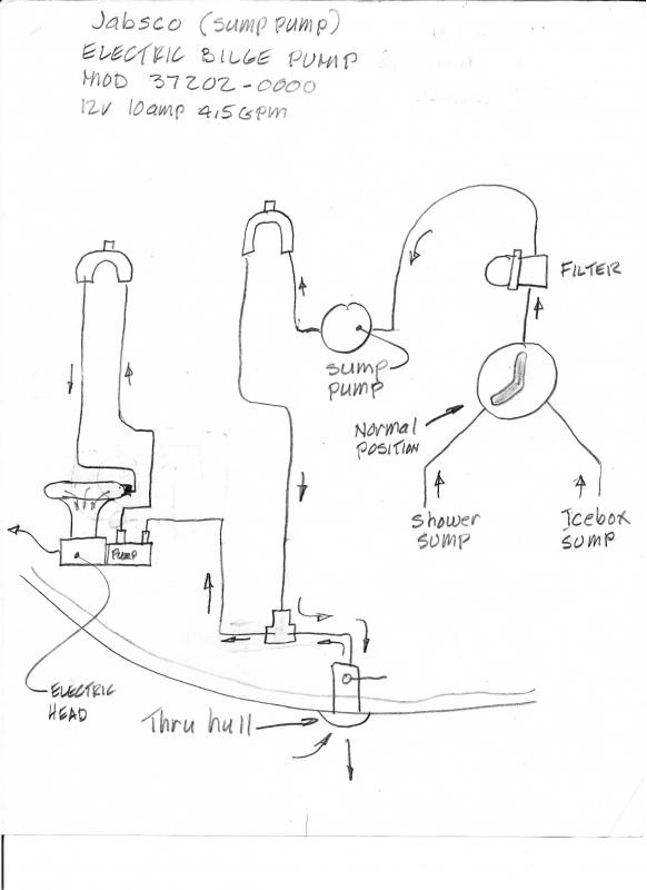

Make sure the through hull valve for the head is open. Mine pumps out through the head inlet.
Jun 25, 2012
942
hunter 356 Kemah,the Republic of Texas
What does a shower sump have to do with the head raw water pickup inlet through hull which would be below the water line? Can you spell let's sink da boat?
My shower drain line occasionally gets plugged up too. It happens at the fitting attached to the shower sump box. I just flush it out with fresh water from the garden dock hose. From time to time. Then remove and clean the strainer. It especially clogs up faster when girl friend uses it. Which is usually with in the first few minutes. I finally just banned her to the marina showers. When its only me its just every few months or so.
My shower sump is in the bilge below the companion way. It has takes care of the shower drain,refrigerator,freezer,drain,wet locker,the lavatory area floor drain and it will soon handle the drain for the lavatory sink drain. Making for one less through hull.
But it has nothing to do with the head plumbing.
Mar 20, 2007
500
Catalina 355 Kilmarnock, VA
Most of the newer Catalina's are plumbed this way. The shower sump drain goes thru a vented loop to prevent back siphoning. I doubt the factory would have designed their boats to be in danger of sinking.
The seacock on my 309's sump and head inlet is a dual inlet, if you have a similar setup be sure the handle is in the fully open position.

No greater danger of sinking than with any other below the water line through hull with a vented loop. Unless I'm missing something. Only difference is the direction of water travel, out for the shower sump, in for the head flush. FWIW I keep all through hulls closed when not in use and recommend others do the same.

The 310's (at least the early ones) are plumbed with the shower and fridge drains exiting through a thru-hull below the waterline under the galley sink. There is a y-valve that allows you to switch between fridge and shower. The pump and pre-pump filter are mounted under the sink as well. There is a vented loop also.
It may have changed in later models but there are no drains (except bilge pump) above the waterline. Galley sink, shower/fridge, macerator and head sink are all below the waterline. Have not had a problem and I (and probably most of us) keep them closed when not in use or not on board.

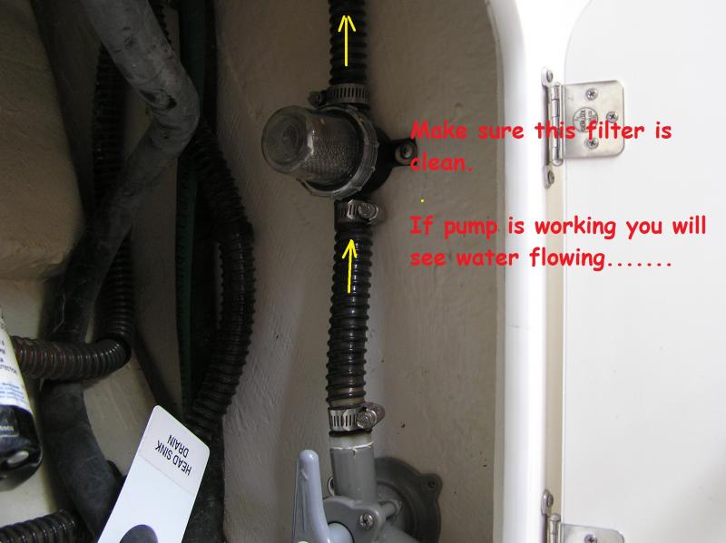

C130--- I had a clog this year that was close to the drain itself. Used the Drano plastic snake that comes with Liquid Drano (did not use the liquid!!!) and it worked fine. Of course if the clog is beyond the length of the snake, that would be a problem. A wire fish may work for something like that. Check that filter also. Mine fills regularly since my son's hair is longer than most 8 year olds!

The clear plastic cover on the filter just unscrews, then pull out the perforated metal cylinder that acts as the filter. Clean the mesh cylinder and re-assemble. Sometimes the water in the pickup hose drains back into the shower sump when you turn off the pump. Turning on the pump again for a few seconds usually takes care of this. Good luck.

jim
Some thoughts :lastweek:
This picture shows most components......
If the pump is on you will hear it.
If the pump is on and working you will see it.
Fill the shower sump up with water, turn on the pump and give it a chance.....a minute or so.
or
Fill the frig sump and try that....etc other sump hose plugged....
paulj :troll:

Ok. Drain is clear. Filter was good...unscrewed the plastic cover and cleaned out the mesh...it was pretty clean. Pump runs fine. But not draining. So me and my buddy proceeded to disconnect various connections to find out where the issue was.
Started with the output side of the pump. Blew through the hose and could hear the bubbles of air flowing out the through-hull. So that hose and the through-hull were working.
Disconnected the output of the filter leading into the pump. Filled a cup with water to see if the pump would suck this dry. It didn't. Hole in the hose. Switched hoses and it worked.
Put everything back together and it still wasn't working.
Final conclusion...multiple leaks in hoses. Hoses are 11 years old. Getting new hoses and will replace them all. Should be a fairly simple process.
