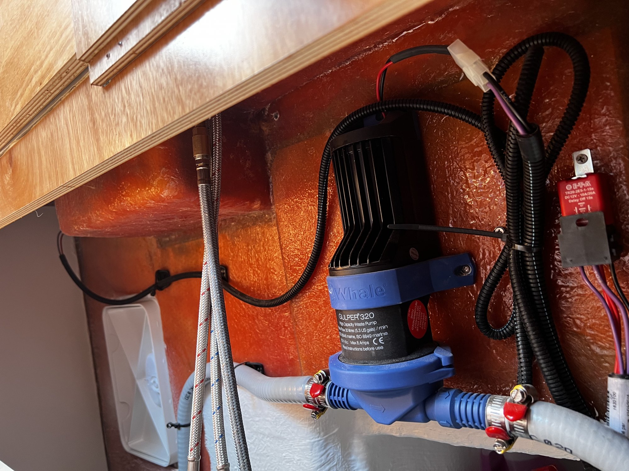

Turns out there is a relay which controls the timing of the pump (it should only be on for 15 seconds) . I have the replacement relay. But where the heck is the original relay located??!!??

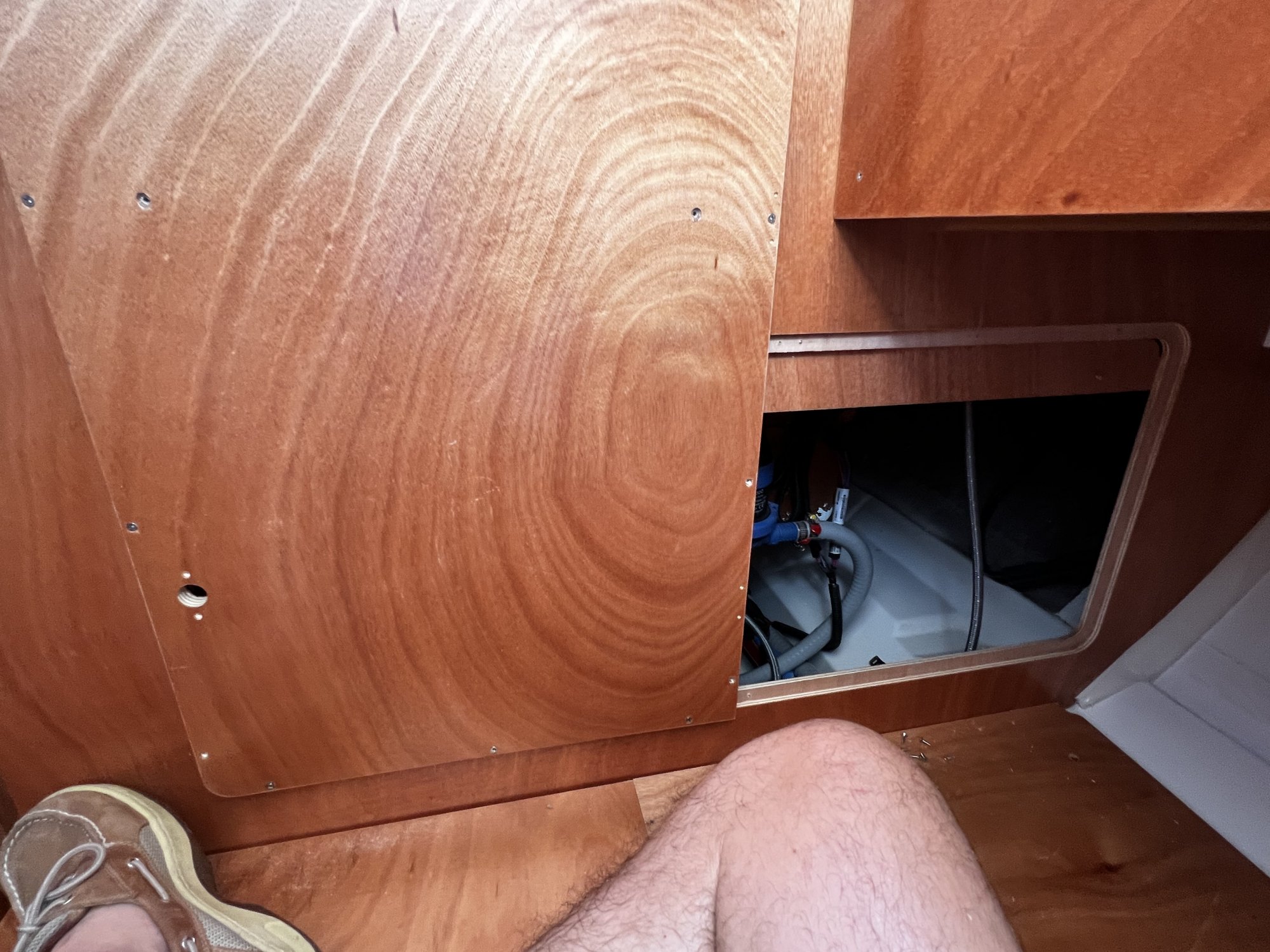

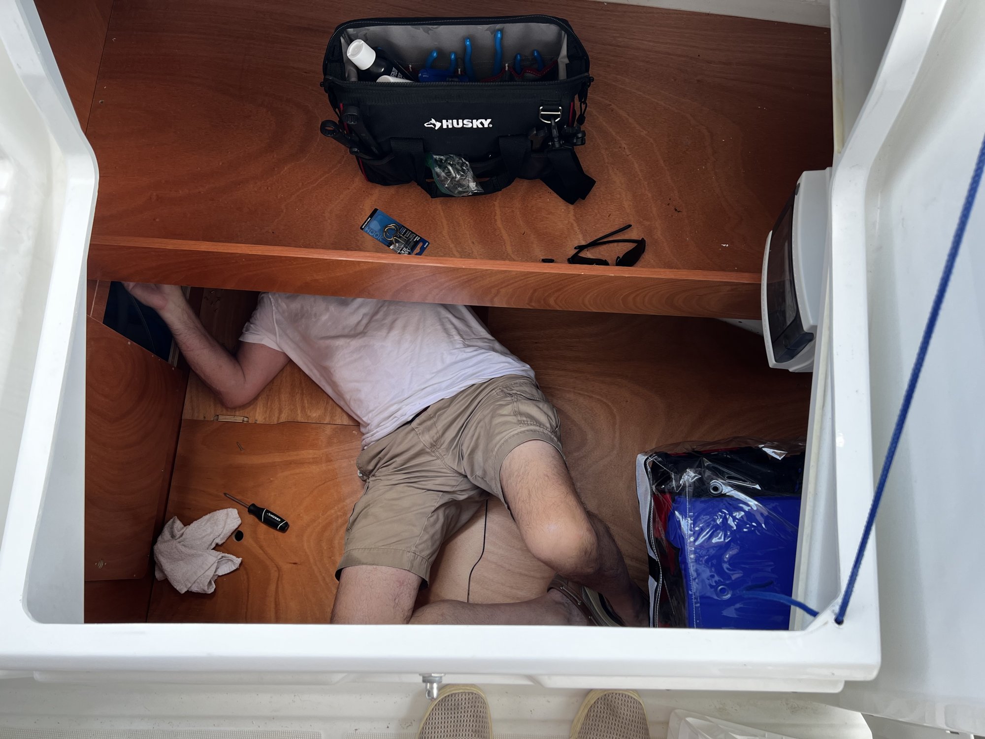

OK, found the delay relay and replaced it. It is located with the sump pump behind an access panel in the lazarette. Pics show the panel open, what is behind it, and the position one must assume to replace the relay. Curiously, there is a 110 V outlet in the outlet below the shelf; it is functional.
