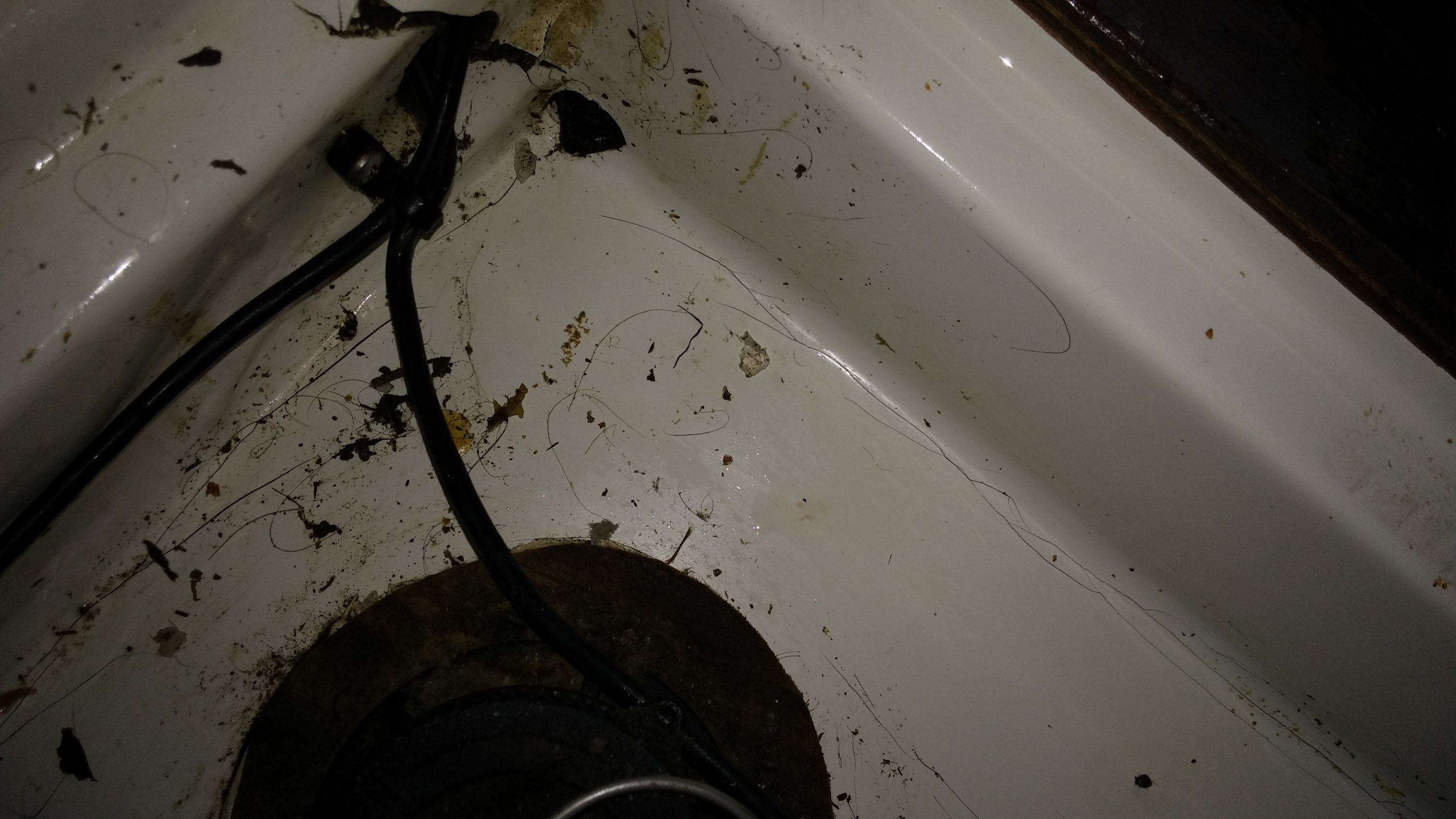

My 1985 Hunter 31 has a shower sump that starts in the sole inside of the head and extends to the sole just in front of the head door. It has a grate over it, as shown in the attached top-down photo. As you would expect, the sump is designed to drain into the main bilge area. Just under the grate in the photo is a black plastic, threaded "tube" or pipe that is coming up from the sump floor (one side of it can barely be seen in the photo in the middle horizontal grate support). The vertical pipe has a "nut" of sorts screwed down its threads. Anyone have any idea what this plastic pipe is and why it is there? Does it allow access to the area between the liner and the hull? Thanks.

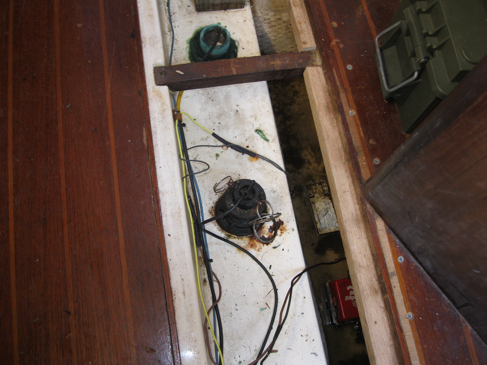

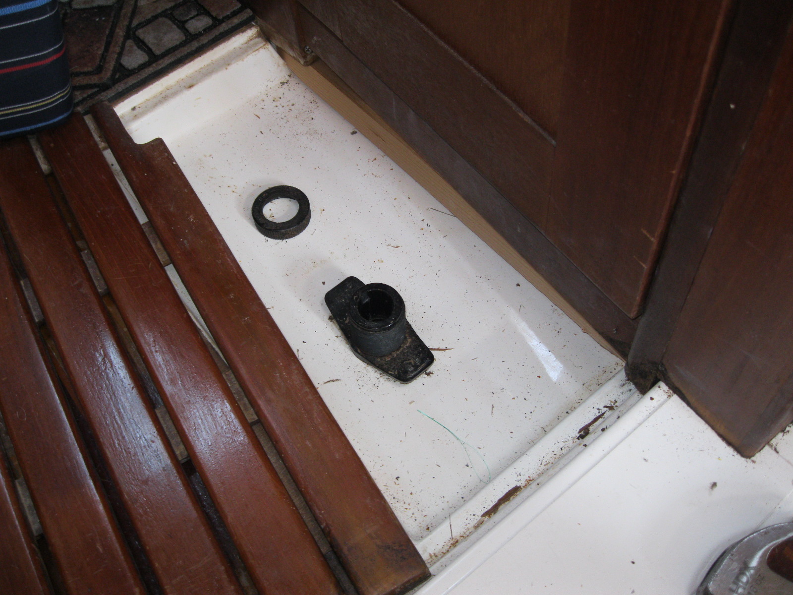

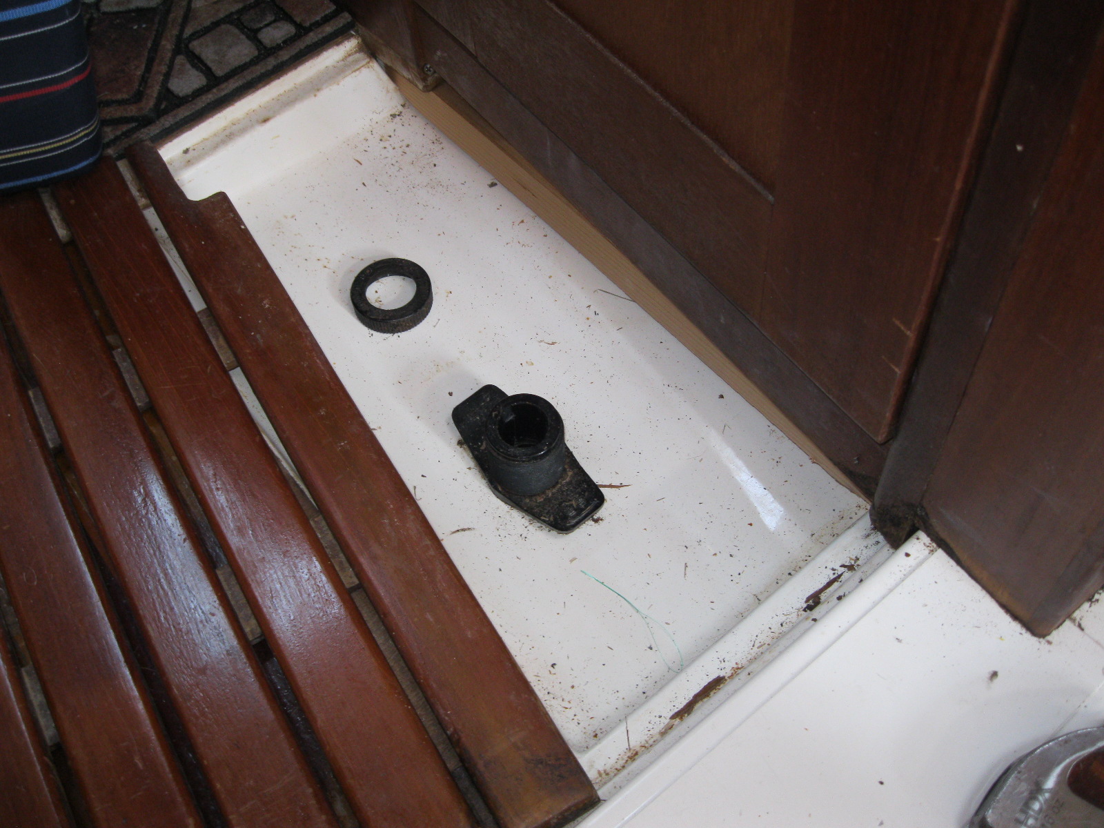

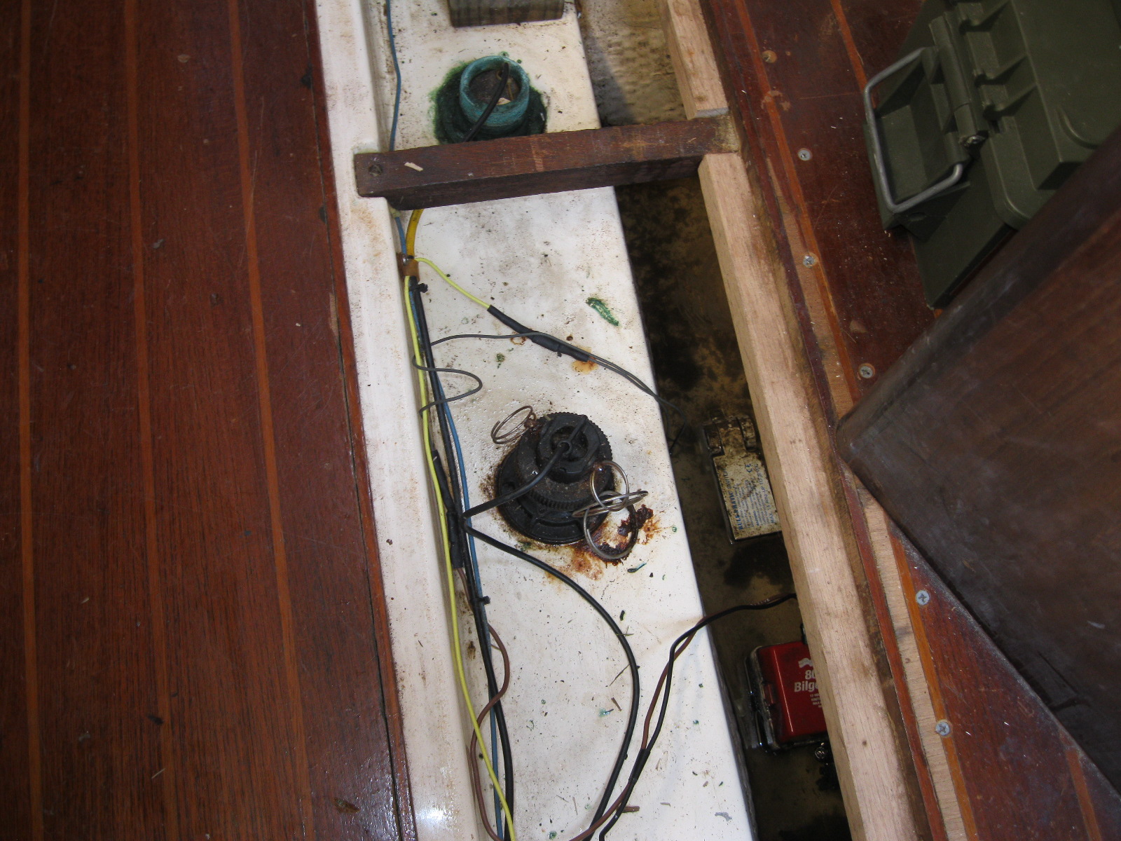

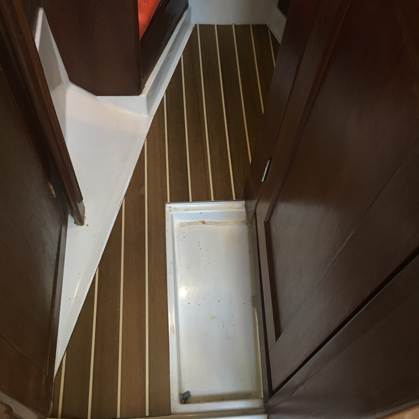

It is very likely a thru hull for a transducer (in my case a speedometer). Below are pics from my 1983 H31, from shortly after I bought it. In the first picture, the transducer itself is out of the thruhull. It is the wired item in the upper left hand corner of the picture. The thruhull itself has the "plug" in it. My transducer is inoperative, which is why it is out, and the plug is in.
I included the second picture to show the hole in the lower corner, where liquid drains into the space between the liner and the hull. This is a bad setup. I assume there used to be a hose there (see the picture in post #3 above), connecting to the main bilge, but it is gone.
There have been H31 owners that have installed a dedicated shower sump pump. Use the search function to find a thread on that. Also, there has been lots of discussion about how to deal with the water that accumulates between the liner and the hull. The "bilge" in our boats is not the actual bilge, but a false bilge design to collect water only from certain sources.

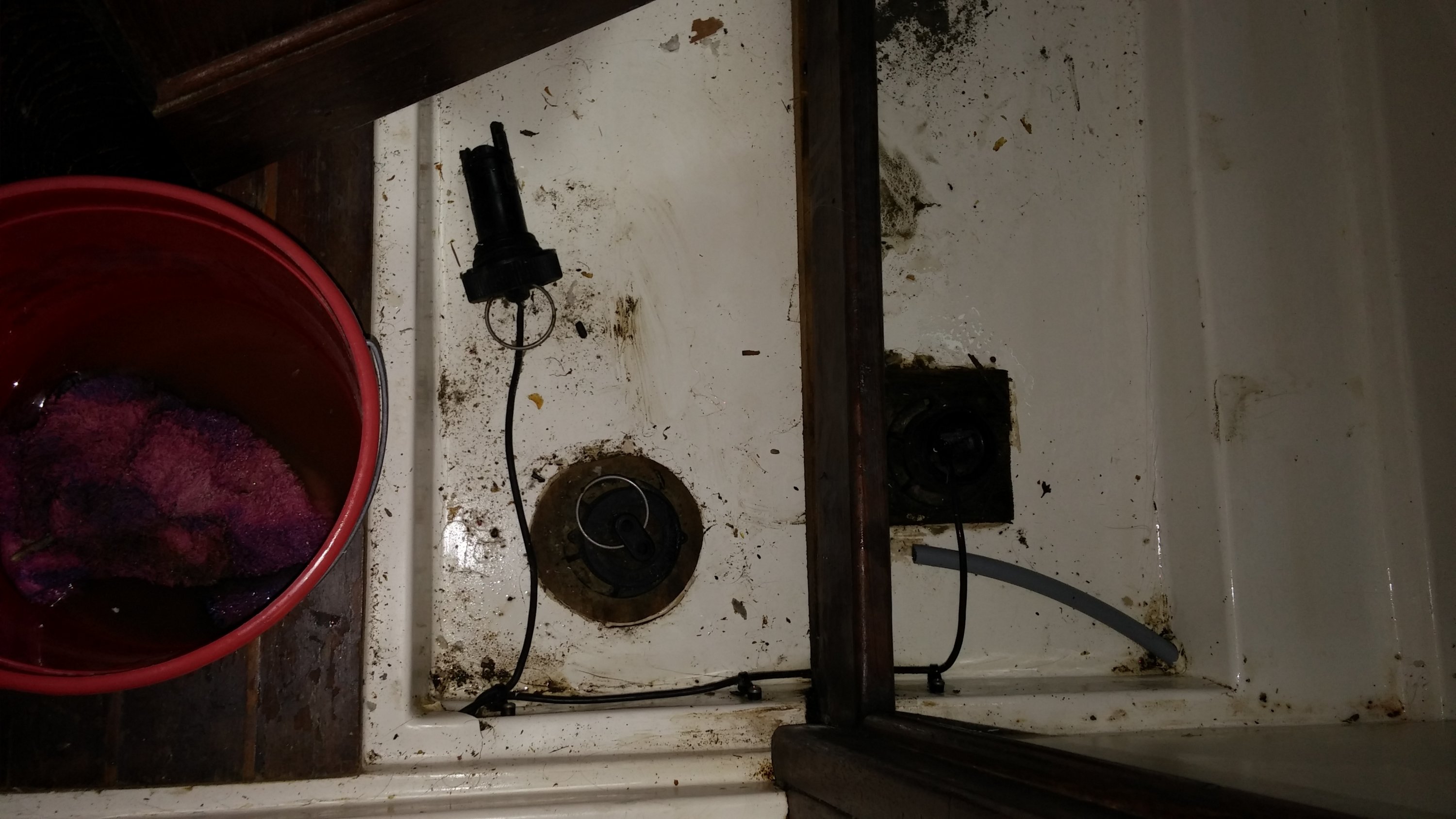

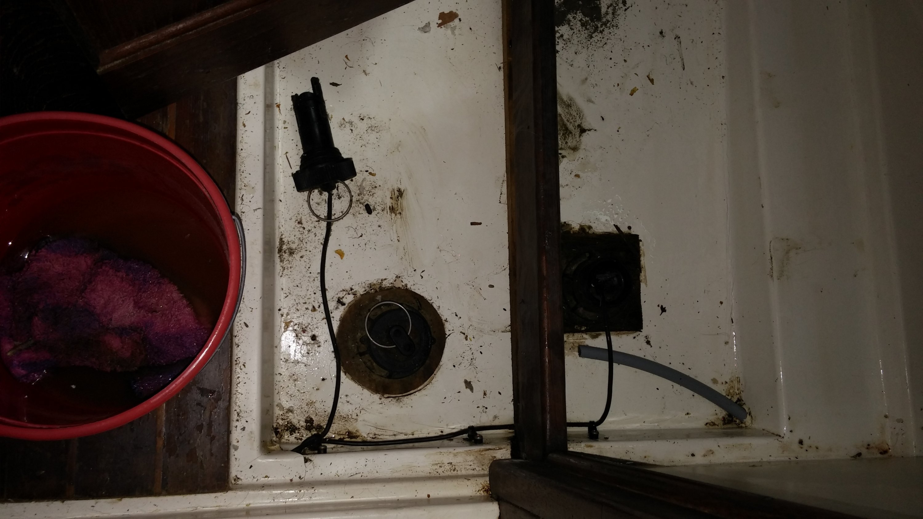

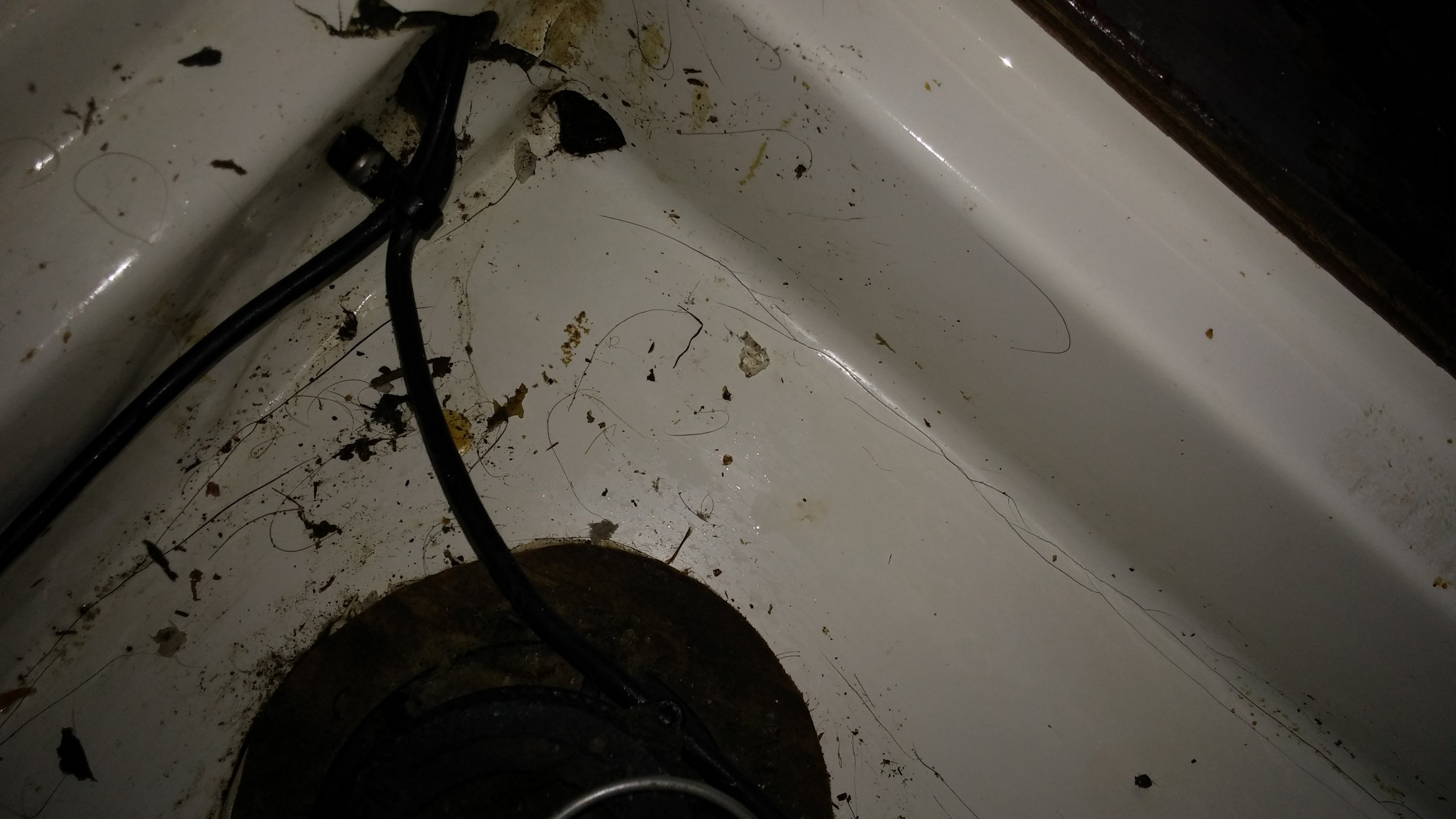

You are most probably right, Kloudie1. I've attached a picture showing the plastic fitting - see what you think. I've also attached a photo of my two sensors in the bilge area. I'm pretty sure one is the depth sounder and the other is the speed paddlewheel - not sure which is which without tracing the lines. I use GPS for speed so have never bothered the paddlewheel. Thanks.
