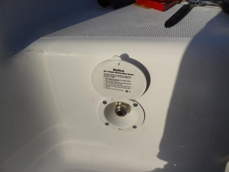

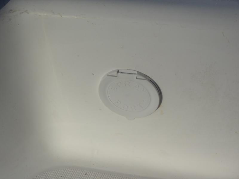

I found a port commonly used in the RV industry, which has a build in valve, closing and holding the pressure automatically, when no hose is connected.

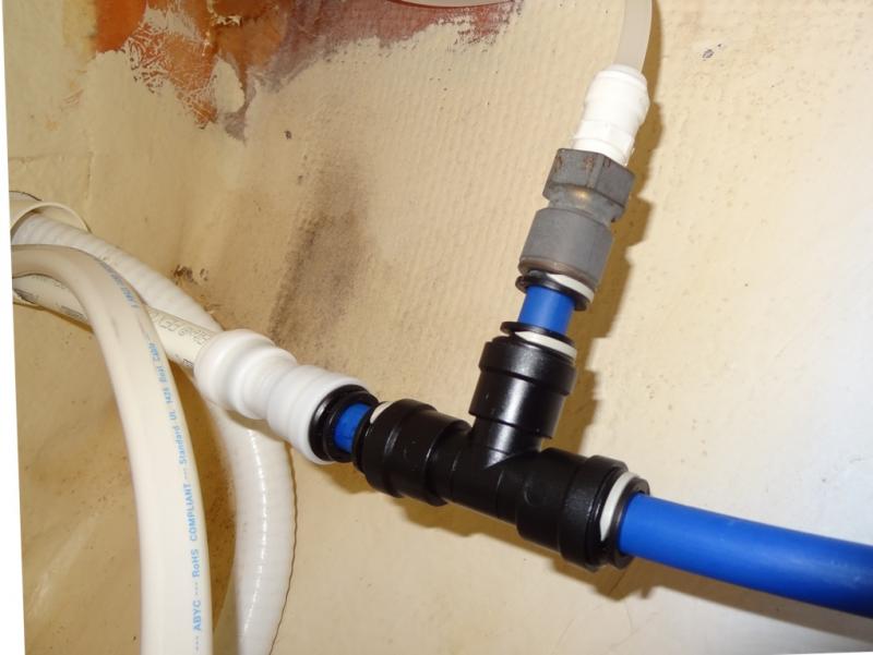

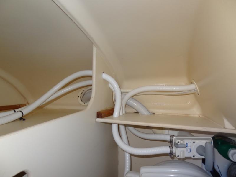

Home Depot sells ½” flexible plumbing pipe I used to rout to the transom, connected it under the bathroom sink with a ½”-15mm adapter to a T-connector; all parts SeaTech quick connect system.
A fitting connector for the spray port and a small shower head added to a flexible hose, is all what is now needed to plug-in to wash- and rinse up at the cockpit.
