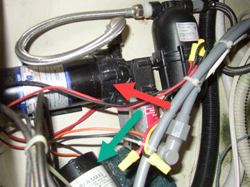

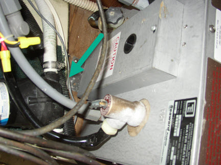

I found the closest thing I have to pictures of the pump. This is looking down thru the hatch in the settee. Pretty messy in there. The green arrow points to the shower pump. The red arrow points to the pump for the sinks. The shower pump is laying down here. There's a wood bulk head just outside of the left of the picture. The second picture shows it laying next to the water heater. I guess I can mount the pump and see what happens.
Looks like a diaphragm pump from what I can see in the picture. If so it is positive displacement and should be self priming. That’s what we have and it is mounted above the level of the shower floor.
