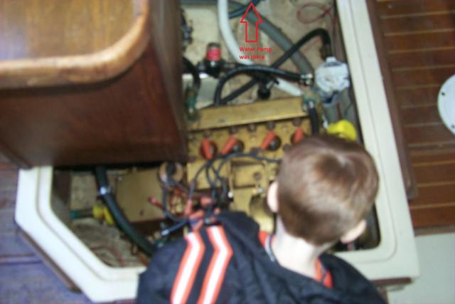

Pressurizing the system is fairly simple. Pressure pumps are inexpensive and easy to install. Mine was in the engine compartment, where it was easily to get to, which I appreciated when I burnt the original one out and had to replace it. There really wasn't a more accessible spot for it. It was on the port side of the compartment. It took some extra wire and hose but it was much easier to fish wire and hose than it would have been to repair or replace an inaccessible pump. There's a pic of where it was. Excuse the messy pic...that when I was looking at her for purchase and before it was cleaned up!
