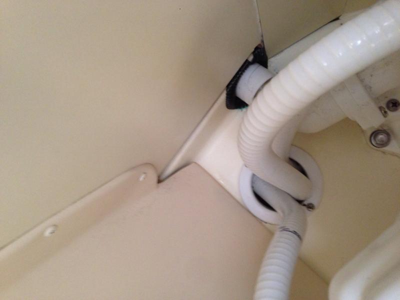

I have a 2010 Hunter 33. That we bought last November. We have sailed short trips and have not used the shower. I was curious how the walls, doors, and cabinets hold up to using the shower. I know you need to dry everything off when finished, but was curious if other people had issues with water damage or water entering seams in panels. Our boat has seams in walls and some seems caulked with silicon and others not( not sure if factory or prior owners). Also there are holes for hoses around toilet. I assume any water entering these goes to bilge??

We've had lots showers in ours without any issues. Not much water would get behind the toilet and if did would most likely make its way tot he bilge.

thanks, I figured all the nooks and holes around the toilet would have to go to bilge. I was just wondering if the back of the door and handle can be damaged form getting wet the appear to be just laminate on mdo, and was just curious if it was a problem area over time. Sounds like a a quick dry down after use and things hold up ok.
