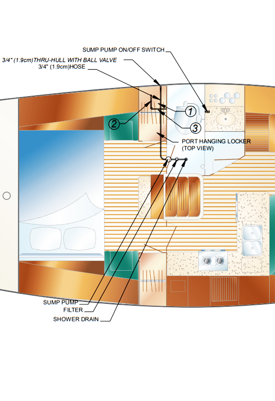

Looking at the 2008 hunter users manual. It shows a diagram such as: Shower drain>3/4 hose> Filter> 3/4 hose> Shower sump pump> 3/4 hose run through boat hulll.
Not sure how to get at the hose

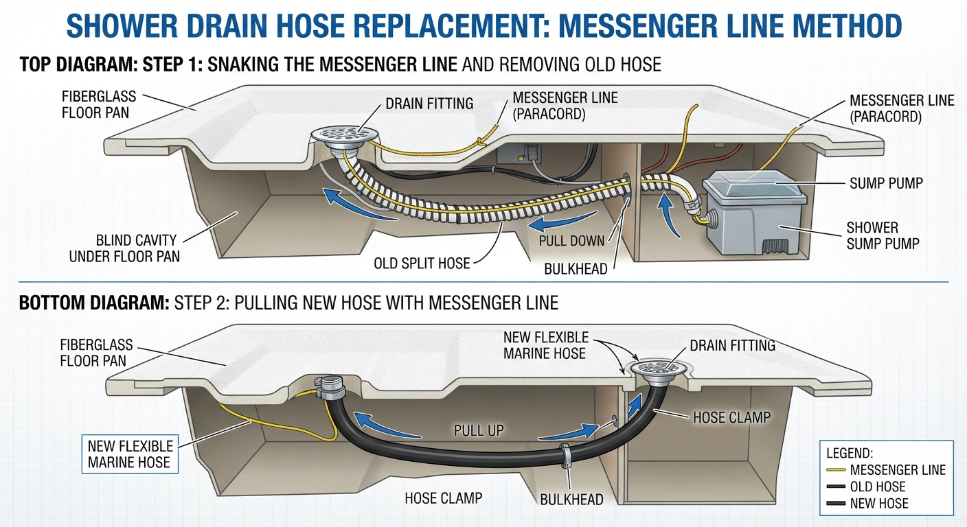

If the owner can access the sump pump could he not access the hose from the drain to the filter? Or use something to snake in a new hose after unscrewing or pulling out the old hose?
Or as you said it's possible with "boat yoga." I guess that means you did it all by touch and no sight?

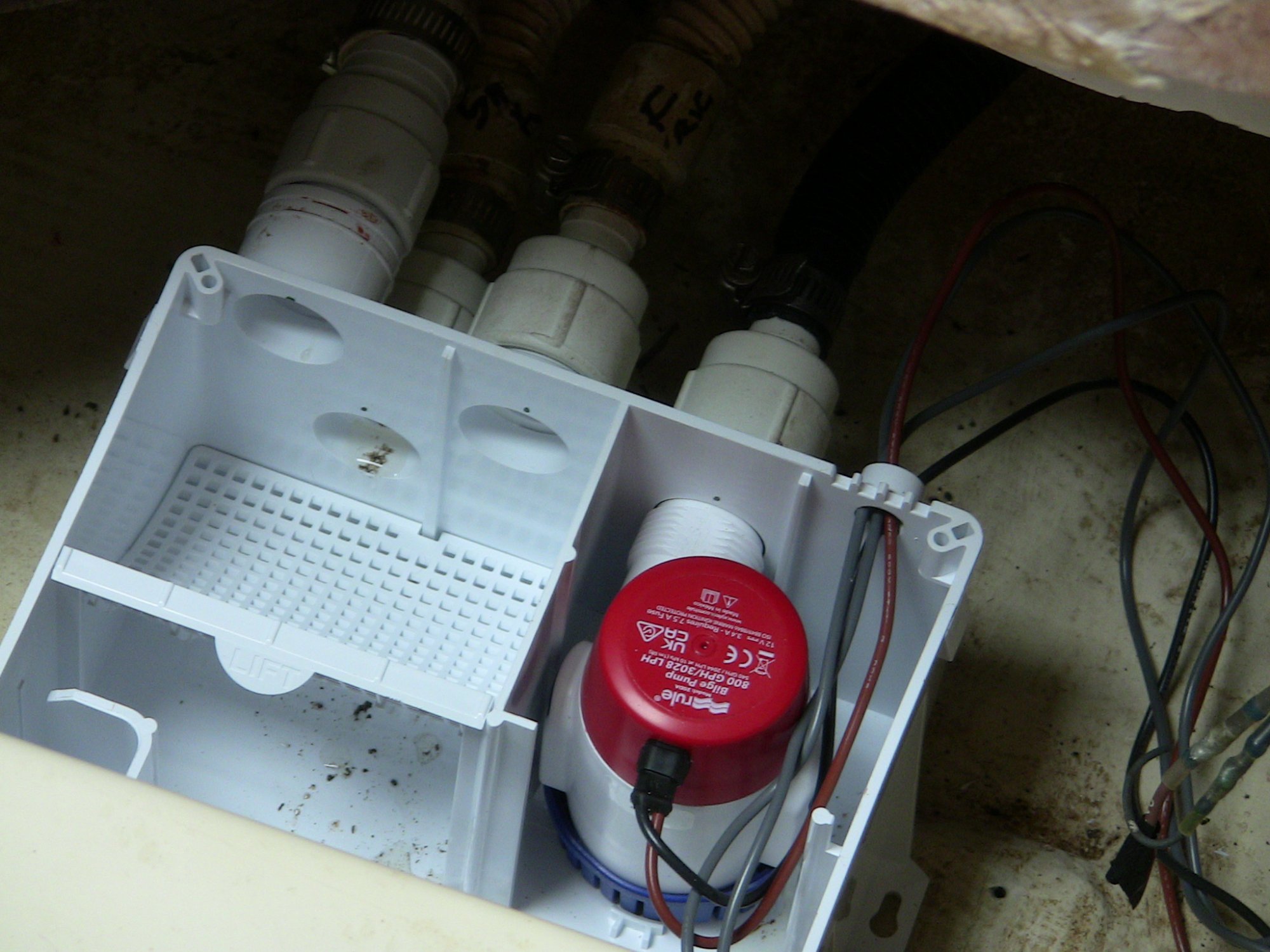

On our boats, the sump pump is readily accessible under the head sink vanity, but the sump from the drain is actually just outside the head door under the sole in the galley near the base of the companionway stairs. Heck, almost just like the diagram.
What POs have done is lift the T&H sole and cut into the fiberglass pan below it to access the hose connection to the sump.
They didn't bother replacing the fiberglass because it was a relatively small area, the fiberglass itself didn't really support anything above it that the T&H sole didn't easily deal with.
You might try this if it works with your construction details.

On my H430 there are 3 inputs
1) Shower Drain
2) Lavatory Overflow
3) Refrigerator condensation
Jim...
PS: Output is on the Red Pump discharge

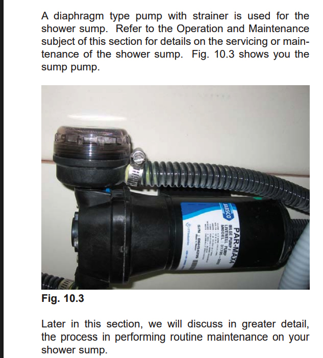

Direct quotes from the 2008 hunter manual.
The shower drains into a sump pump which keeps hair, soap scum, and bacteria from building up in the bilge and developing an odor. Periodically clean out the pump filter to prevent clogging the pump.
10.2.3 Shower Sump
Due to the level of the shower drain, we have installed a pump system to rid the boat of water from your shower. The small holding tanks also acts as a collection point for hair and other waste materials that might get washed down the drain.
Similiar to Jim photo.

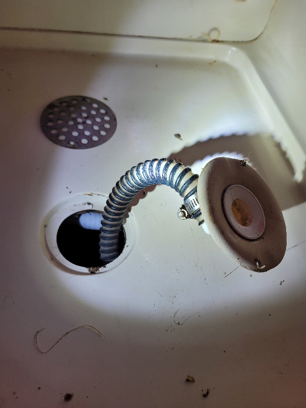

Sep 20, 2006
2,955
Hunter 38 Georgian Bay, Ontario, Canada
So, I never knew it would come out like this. Our H33 the grill was stuck down solid, probably caulking. This will be easy to replace.
