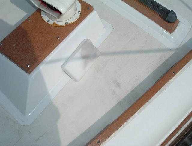

You should not need a cover unless the dorade box is plugged. There is a small hole at the bottom rear corner. If that gets plugged the box can fill up and overflow into the cabin. Many of us have opened those boxes to find rotted plywood and the holes plugged. We clean that out and coat the inside with a liberal amount of heavy epoxy. Be certain to keep that hole open. I have never actually had water come in from there. I put new covers on my dorade boxes using plastic teak. Same with traveler base.

Ed, I love the plastic teak job on your deck, it looks very good and makes varnishing a thing of the past
