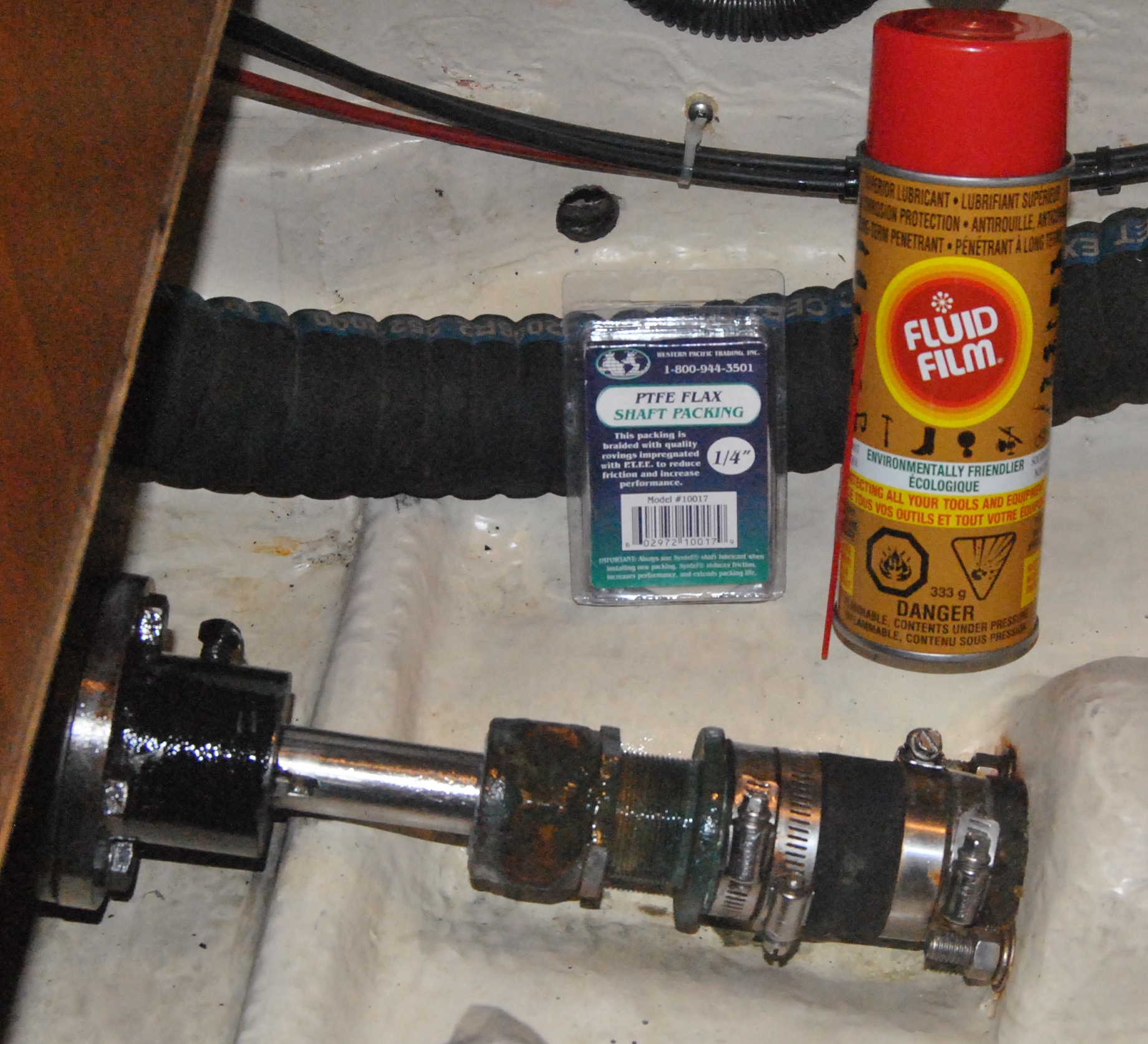

Paint will eventually crack, pit, or whatever and allow corrosion from salt water to get back to business again. I have always covered everything in that area (but not the hose) with an aerosol spray material called Fluid Film. It remains as a heavy greasy film and spreads over any sprayed metal surface. Even the bronze packing gland stays kind of so-so for a few years. About $12.00 for the can.
The attached shows the shaft flange as it looks today at 22 Y.O. I will disassemble and respray every ~5 years for an alignment job but not a trace of corrosion inside or out.
